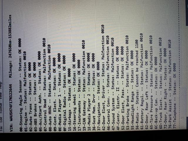

frenchhr Posted September 28, 2021 Author Share Posted September 28, 2021 Steve Y, Thanks for the reply. The codes are current and show old because I haven’t set the time and date yet. The codes do come back after they are cleared. Is the partial consumer shut off causing my driver’s side power seat and windshield wipers not the work? Thanks Quote Link to comment Share on other sites More sharing options...
Stevey Y Posted September 28, 2021 Share Posted September 28, 2021 2 hours ago, frenchhr said: Steve Y, Thanks for the reply. The codes are current and show old because I haven’t set the time and date yet. The codes do come back after they are cleared. Is the partial consumer shut off causing my driver’s side power seat and windshield wipers not the work? Thanks Hi yep any miss behaving component on the power supply will cause weird and Wonderfull problems with anything electrical, you say you have replaced the regulator and it did not work, I am thinking that this may be due to the new one needing re coding, think the old unit is at fault possibly, can you scan the old unit and retrieve the coding and make a record of that coding as that would give you a failsafe to fall back on, to be honest the electronics are very complex on these vehicles which started back in the nineties in an effort to curb home repairs as lets face it no one except Audi had access to the software required to perform any tasks. With the advent of VCDS/VAGCOM being available to the public they then had to find ways of still making repairs that much more difficult for the average DIY enthusiast, there have been posts on the net about people who have bypassed the energy monitor with great success until a couple of weeks later the alternator stops charging and the airbag light comes on because the Body control module can't read the pulse signals from the airbag module because the battery energy module has been bypassed, the whole thing is daisy chained together to stop anyone from removing components from the chain, sorry if this is not a very helpful reply but this is how they drag you to the nearest dealer kicking and screaming. Steve. Quote Link to comment Share on other sites More sharing options...

Stevey Y Posted October 2, 2021 Share Posted October 2, 2021 Hi Henry sorry for the late reply, I think from the last post that the can gateway 19 is the cause of most of your troubles if thats out of kilter its a pandoras box there is information on the Ross tech forum its via some American guy who has the same list virtually as your self it involves reprogramming the offending modules using a binary formula for the codes to get the can gateway back on side it may well be worth a read, I did try to understand it more but over lengthy perusal I realised it was a little over my pay grade, if your VCDS is genuine it may well be worth flying the question on the Ross Tech forum, they cited 07 as being the electric seat module failure. Steve. Quote Link to comment Share on other sites More sharing options...
