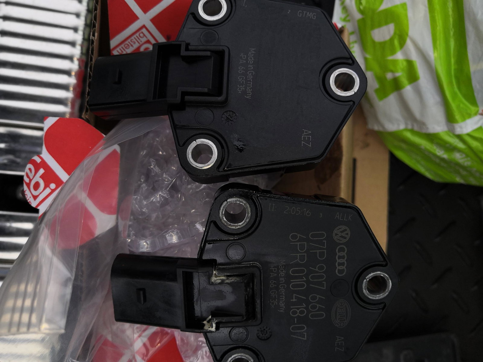

Stevey Y Posted October 6, 2021 Posted October 6, 2021 1 hour ago, Spock said: Update : I went with my gut instinct and replaced the top strut mount . Went with Febi and to be honest it looked identical to the one I replaced it with. All sorted and quiet 👍👍👍 result ! Thanks all PS I couldn’t see anything wrong with bearing . Could have been a seating issue 🤷♂️🤷♂️ Hi Febi supply the mounts and a shed load of other parts as O.E., I found that out when I bought my oil level sensor, Audi wanted nearly £200 with the VAT so I bought a Febi sensor from my local spares shop for £67 and guess what the Febi item was exactly the same except someone had ground the VAG/Audi logos off of the casing, the only thing left was all the casting numbers which matched perfectly, the guy at the spares place told me they do it all the time as they are not allowed to sell O.E. marked parts in their packaging, so if you want to buy a badge engineered part in the right box for twice the price +, knock yourself out. Steve. 1
