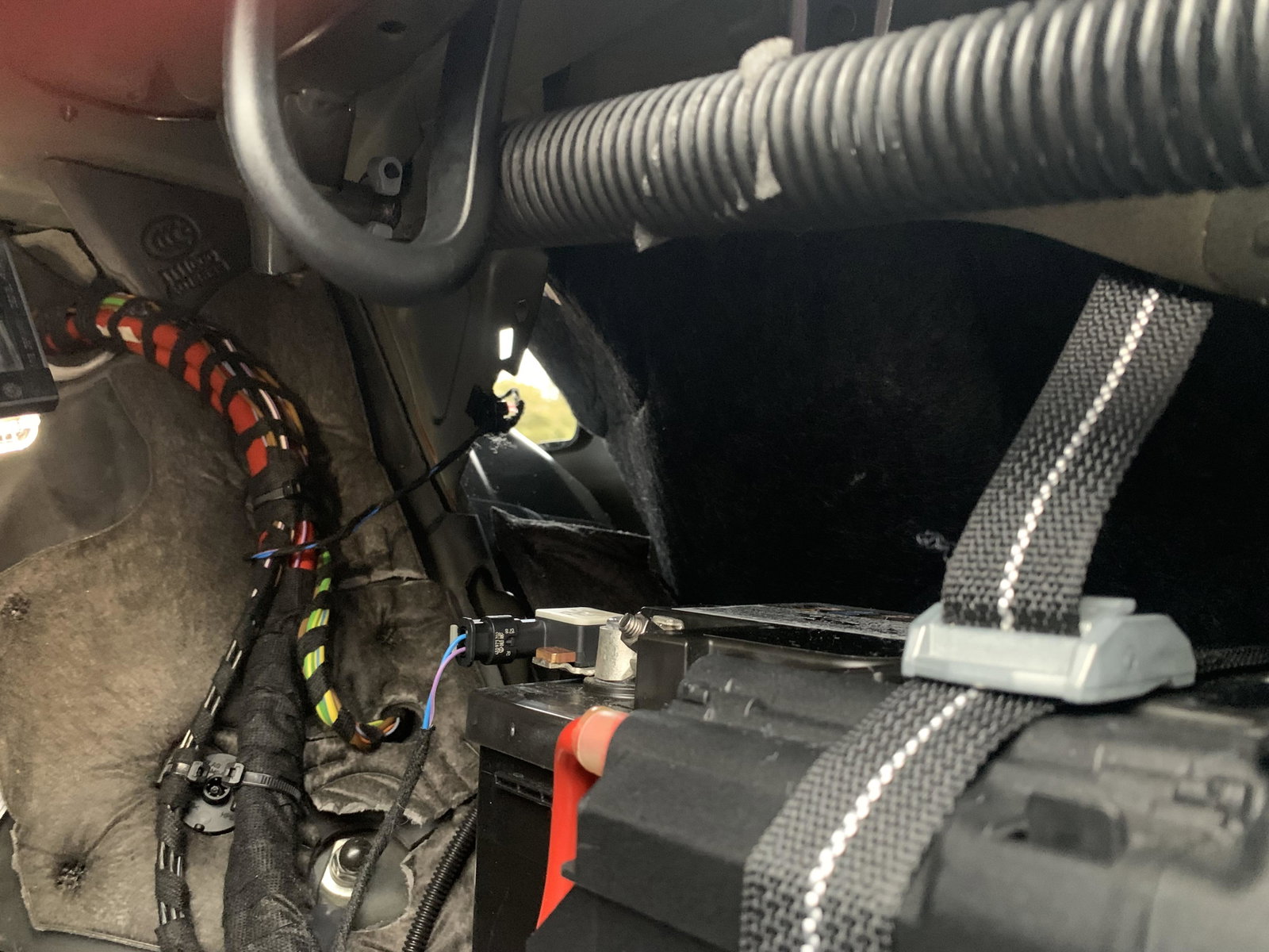

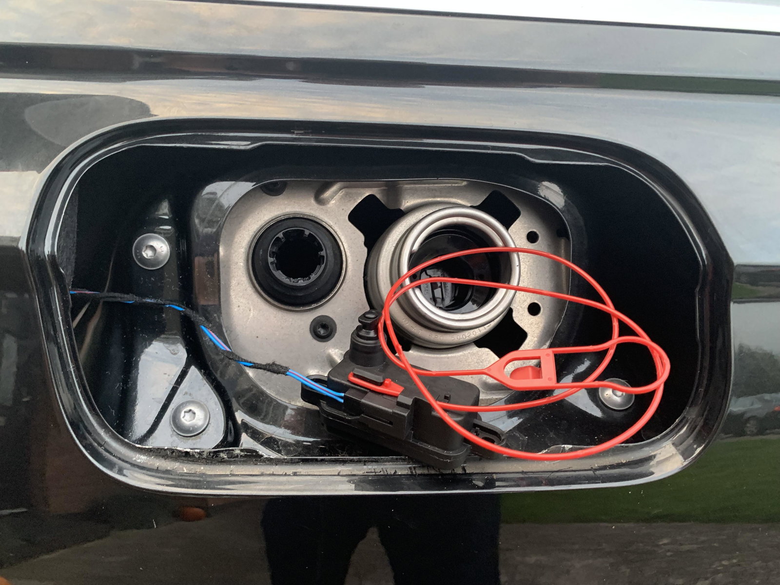

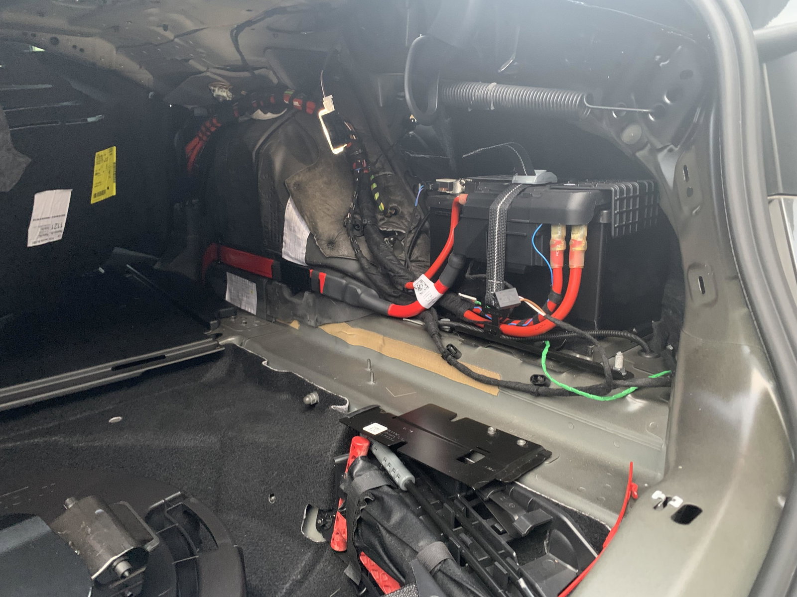

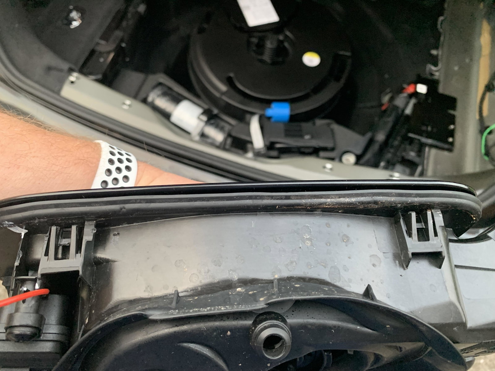

So - managed to successfully change the solenoid out. Removed a nice section of trim inside the boot, but in hindsight, it could probably be done without doing that. Most difficult piece is getting the fuel cap surround detached from the body panel - it's held in place with the clips shown in the pics - but can be wedged away from the bodywork with extreme care (not to chip paintwork) as some force is needed. About an hour to complete and replacement part was 拢20 on amazon. Thanks for the advice @Stevey Y. IMG-5076.thumb.jpg.df216e9c9a553d61b9ea28ea975fbca3.jpgIMG-5077.thumb.jpg.b1855f623e756df4cd31393933ee99af.jpgIMG-5078.thumb.jpg.5bc9381e79f0be7364f6d1c4a0566754.jpg IMG-5080.thumb.jpg.cf96234f09ccdb5360c5c0266fef0cb2.jpg
Hi nice clear pictures well done, I must say the trim removal is to say the least comprehensive but thats better than tearing your hands to pieces trying to work in a confined space, just shows that the shortest route is not necessarily the quickest, good skills and you have saved yourself a wad in labour doing it yourself.
