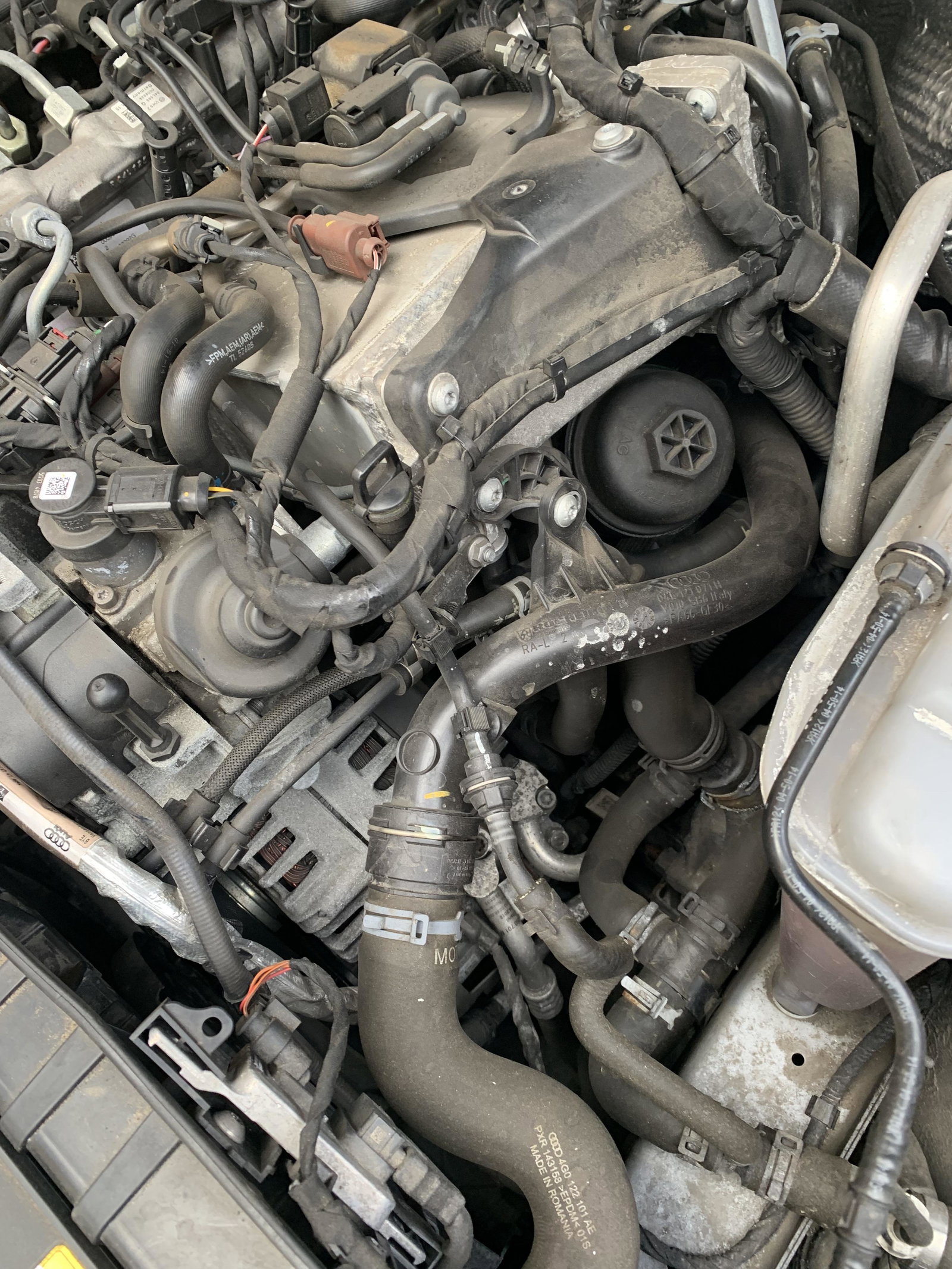

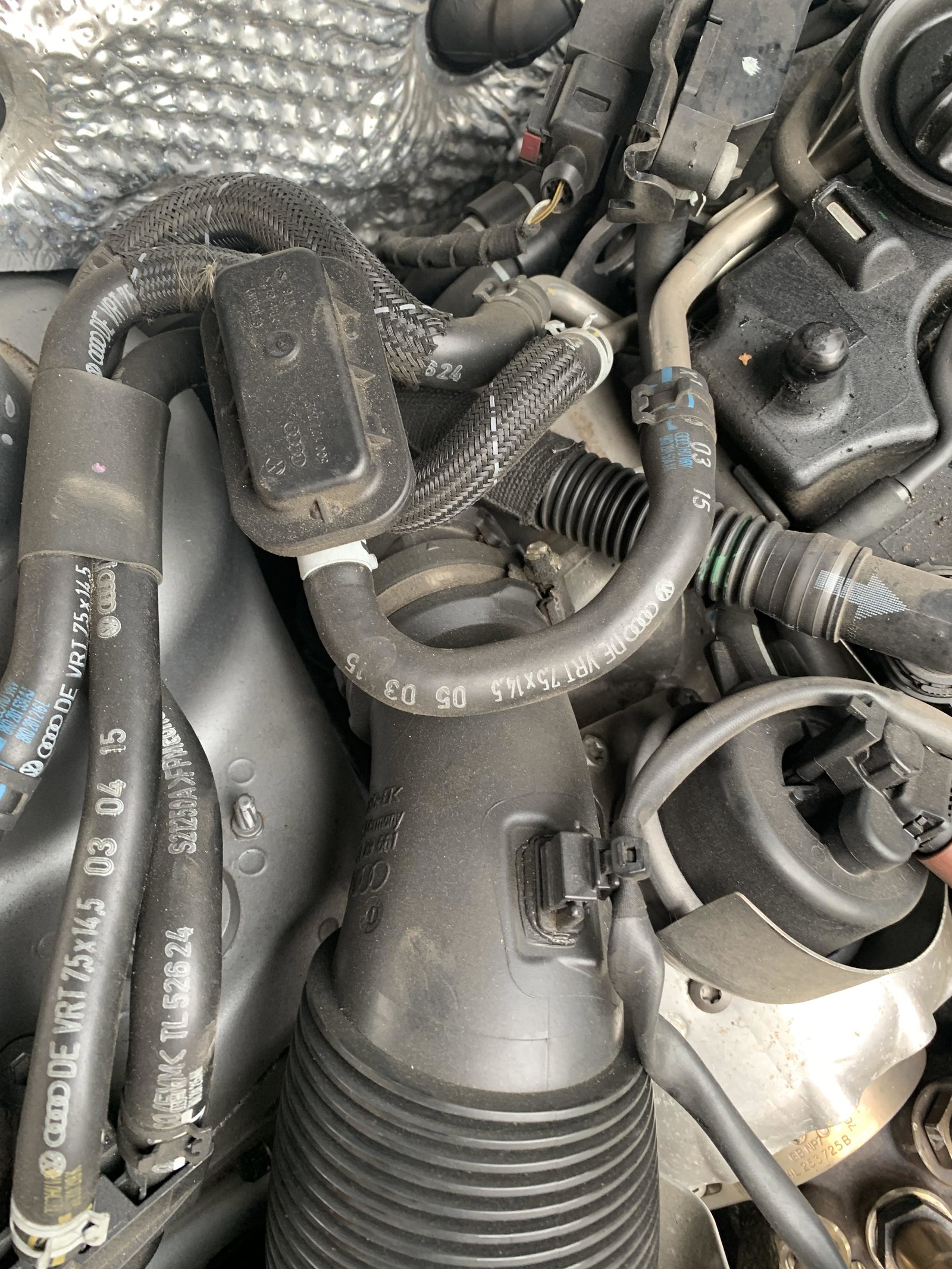

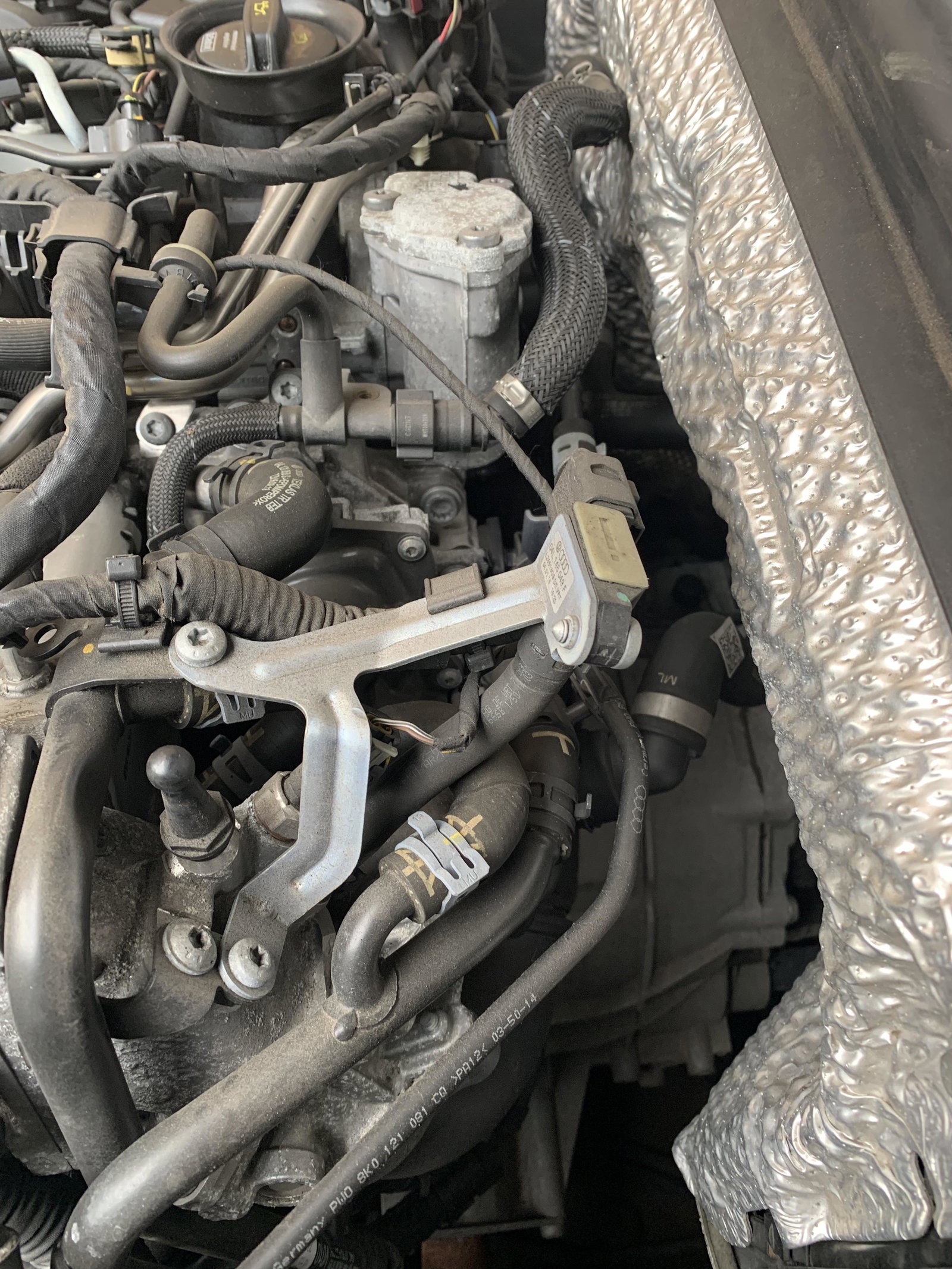

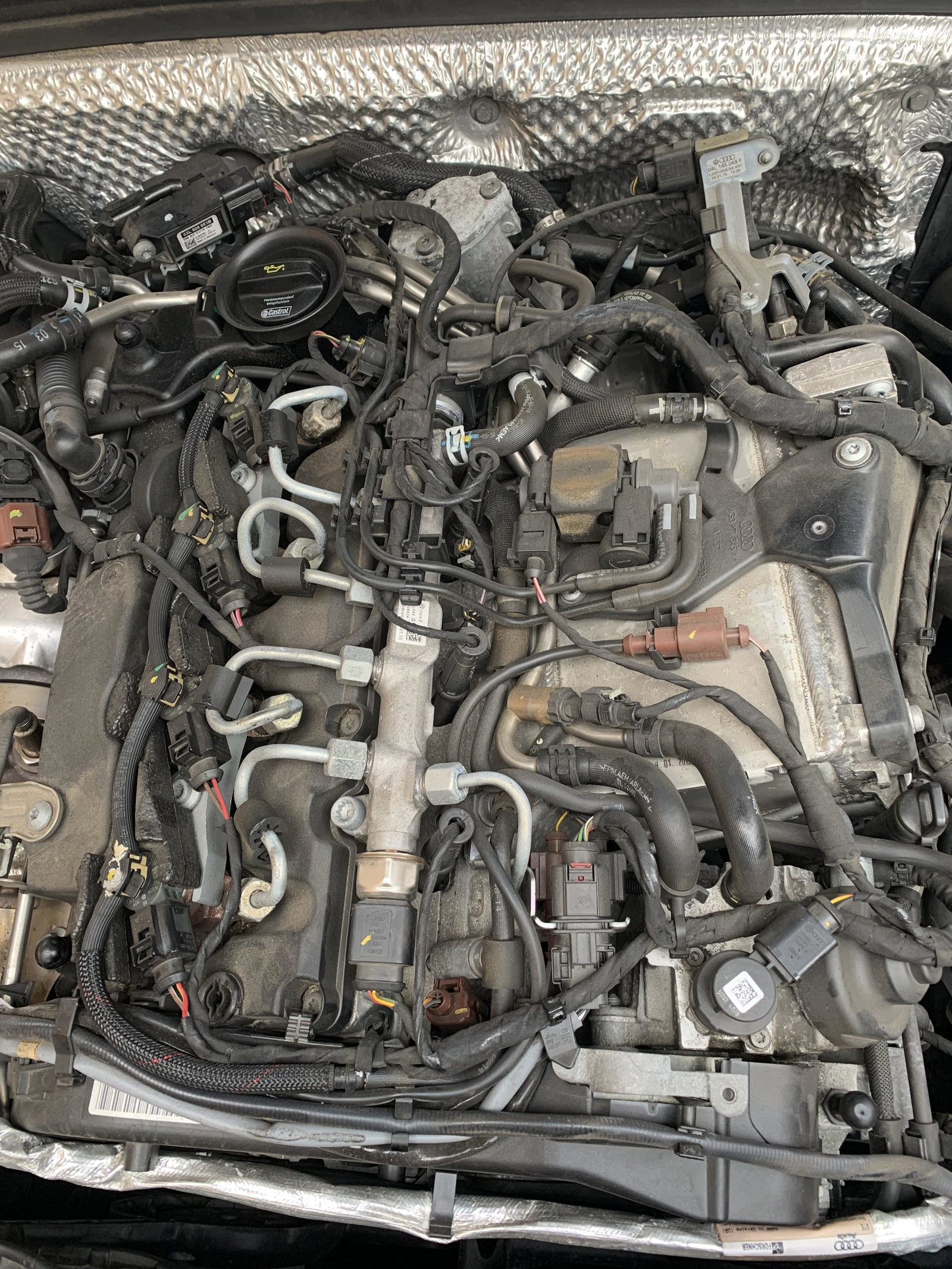

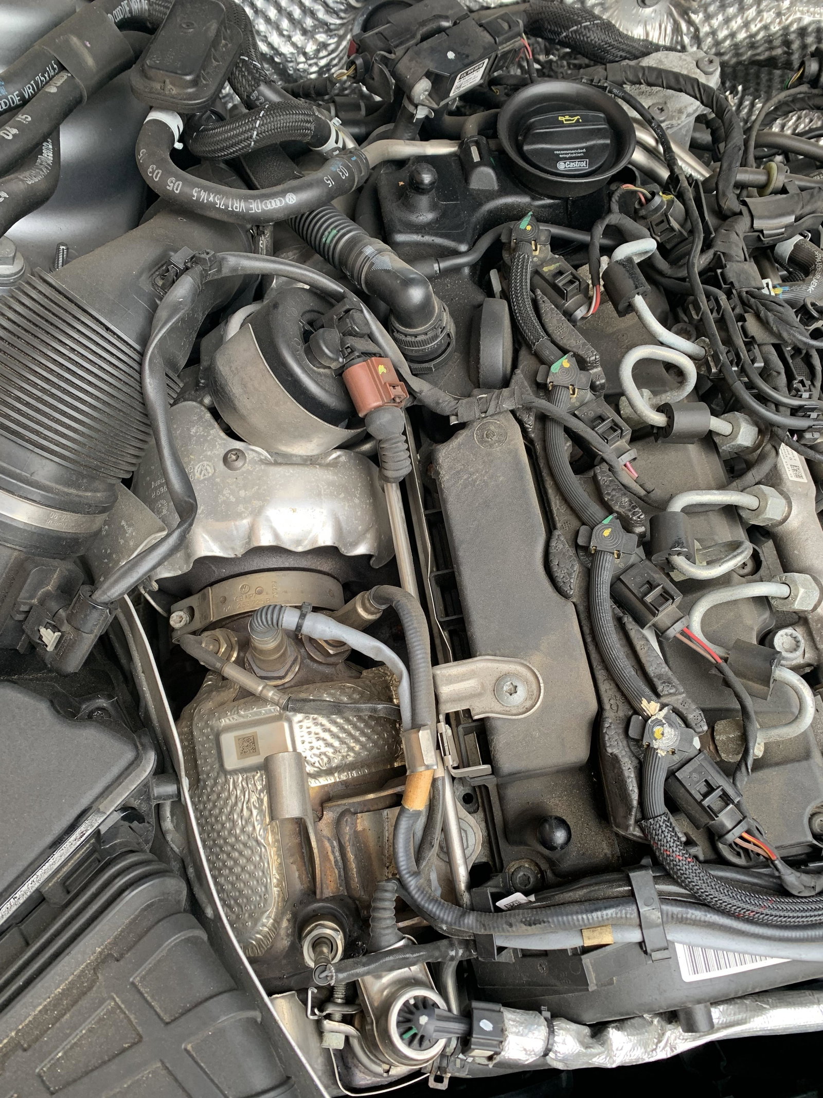

Hi ,what horsepower is your car, the engine in my 16 plate looks exactly the same and mine is a CNHA unit but I think they changed the letter coding according to the horsepower, anyway think you will find the EGR on the back of the large alloy inlet manifold opposite the MAP sensor on its own bracket in the second picture, the throttle body and EGR are right next to each other, the EGR is the one with the ribbed stainless steel pipe running into it.

i think it’s 163 Bhp. Is the 2nd picture after the main picture of the engine.

Hi yes it is second from the main, as I say the easiest way to chase it is from the ribbed EGR pipe to where it joins the EGR, you just have to move the pipe work around until you can see it, if you can send me your VIN I will see if I can poach a diagram of it on my parts system and then post it here.
