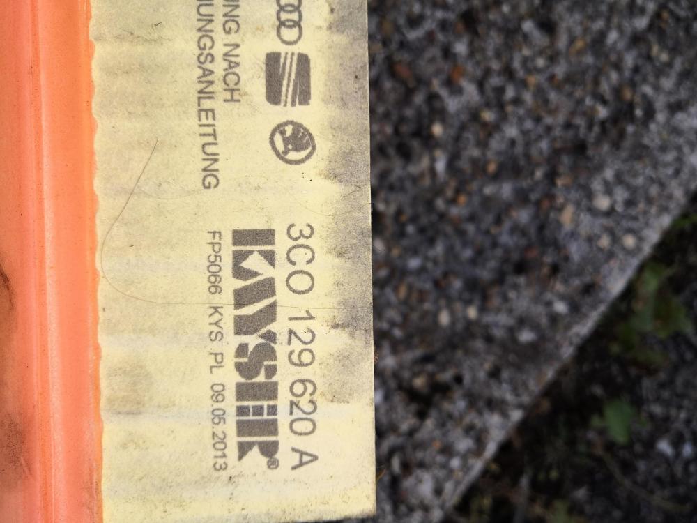

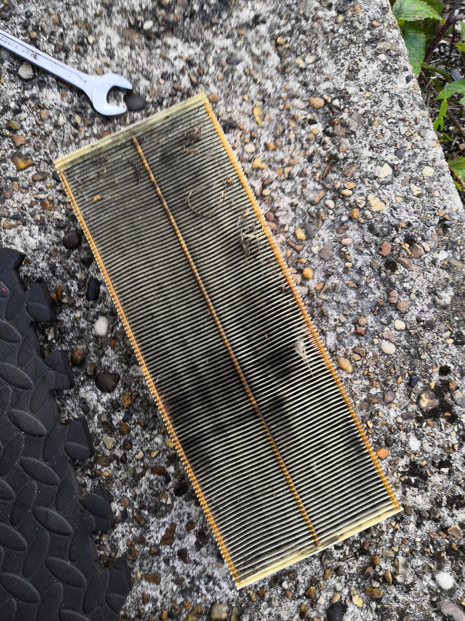

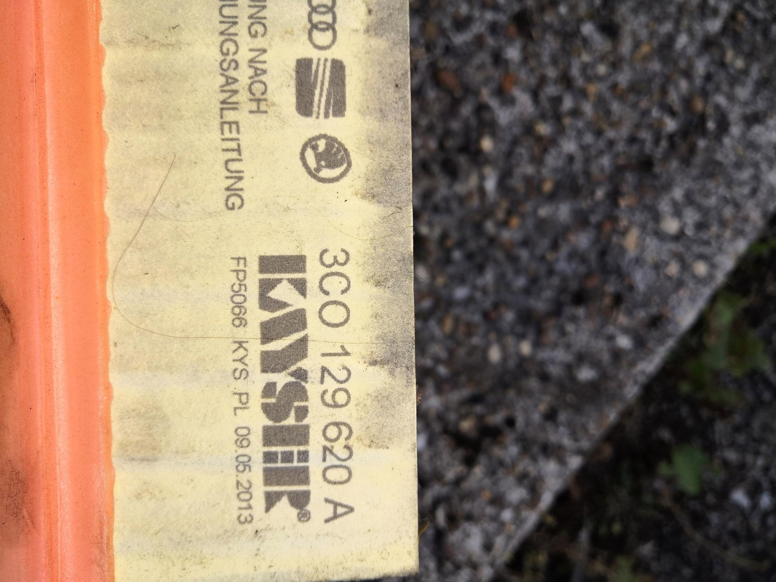

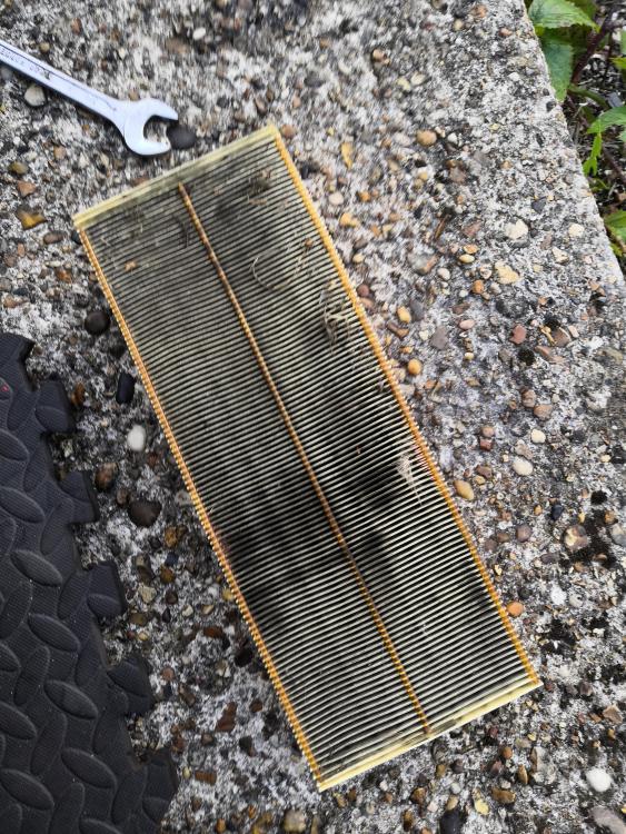

Stevey Y Posted October 27, 2021 Posted October 27, 2021 Hi thats just a tad overfilled I would leave it and see how fast goes down over the next couple of weeks, as for master technician thats a title thats invented for the guy thats been there the longest, as for the full Audi service history my daughters Q3 had the same and have a look at the air filter I pulled out of it, it has the same date as the car was built stamped down the side of it, my advice find a decent independent garage to look after your car. Steve.
