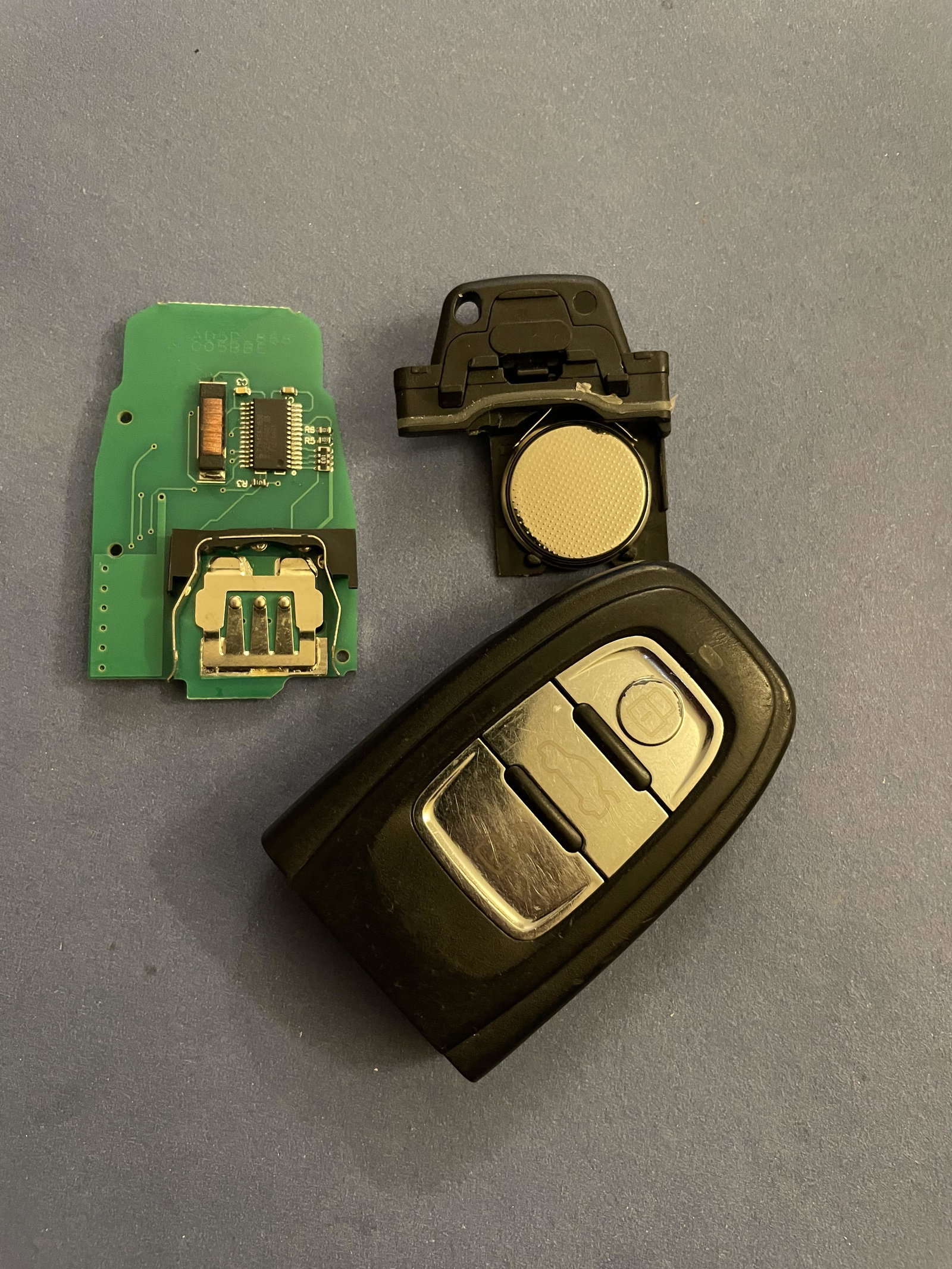

JonA4 Posted December 3, 2021 Author Share Posted December 3, 2021 Hmm, So where is the transponder chip? I was expecting a little glass capsule but not seeing anything like that. Youtube has not been my friend on this one! Quote Link to comment Share on other sites More sharing options...
Stevey Y Posted December 4, 2021 Share Posted December 4, 2021 Hi thats a bit different the transponder is that part to the left with the winding coils and the beggar is cold soldered in, if you can get the part number for your key there are loads of new un programmed fobs on eBay for not to much money, I was expecting to see a black transponder chip wedged on the board somewhere, I have spoken to a friend who is an automotive locksmith and he said the plug in keys are a nightmare which is why later models had the key modulation from the fob rather than the key having to be physically inside what was the ignition barrel, I would consult a local car key locksmith as they may well have a solution for you, Jamie has always told me what fob to buy and where to get it from and then programmed it from the original. Steve. 1 Quote Link to comment Share on other sites More sharing options...
JonA4 Posted December 6, 2021 Author Share Posted December 6, 2021 On 12/4/2021 at 7:57 PM, Stevey Y said: Hi thats a bit different the transponder is that part to the left with the winding coils and the beggar is cold soldered in, if you can get the part number for your key there are loads of new un programmed fobs on eBay for not to much money, I was expecting to see a black transponder chip wedged on the board somewhere, I have spoken to a friend who is an automotive locksmith and he said the plug in keys are a nightmare which is why later models had the key modulation from the fob rather than the key having to be physically inside what was the ignition barrel, I would consult a local car key locksmith as they may well have a solution for you, Jamie has always told me what fob to buy and where to get it from and then programmed it from the original. Steve. Good advice thanks. I was thinking it was the bit with the coil and that is beyond my soldering skills! will talk to a pro. Anyone any recs in the Oxfordshire/Berkshire/south Bucks area? Quote Link to comment Share on other sites More sharing options...
