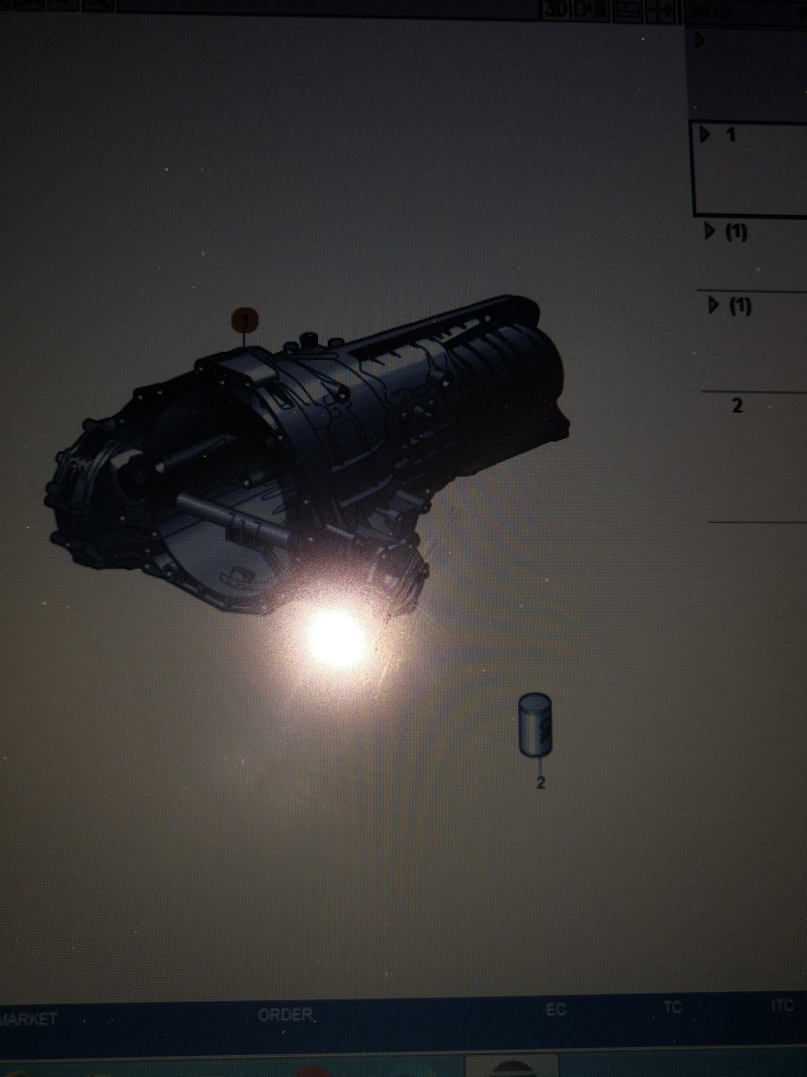

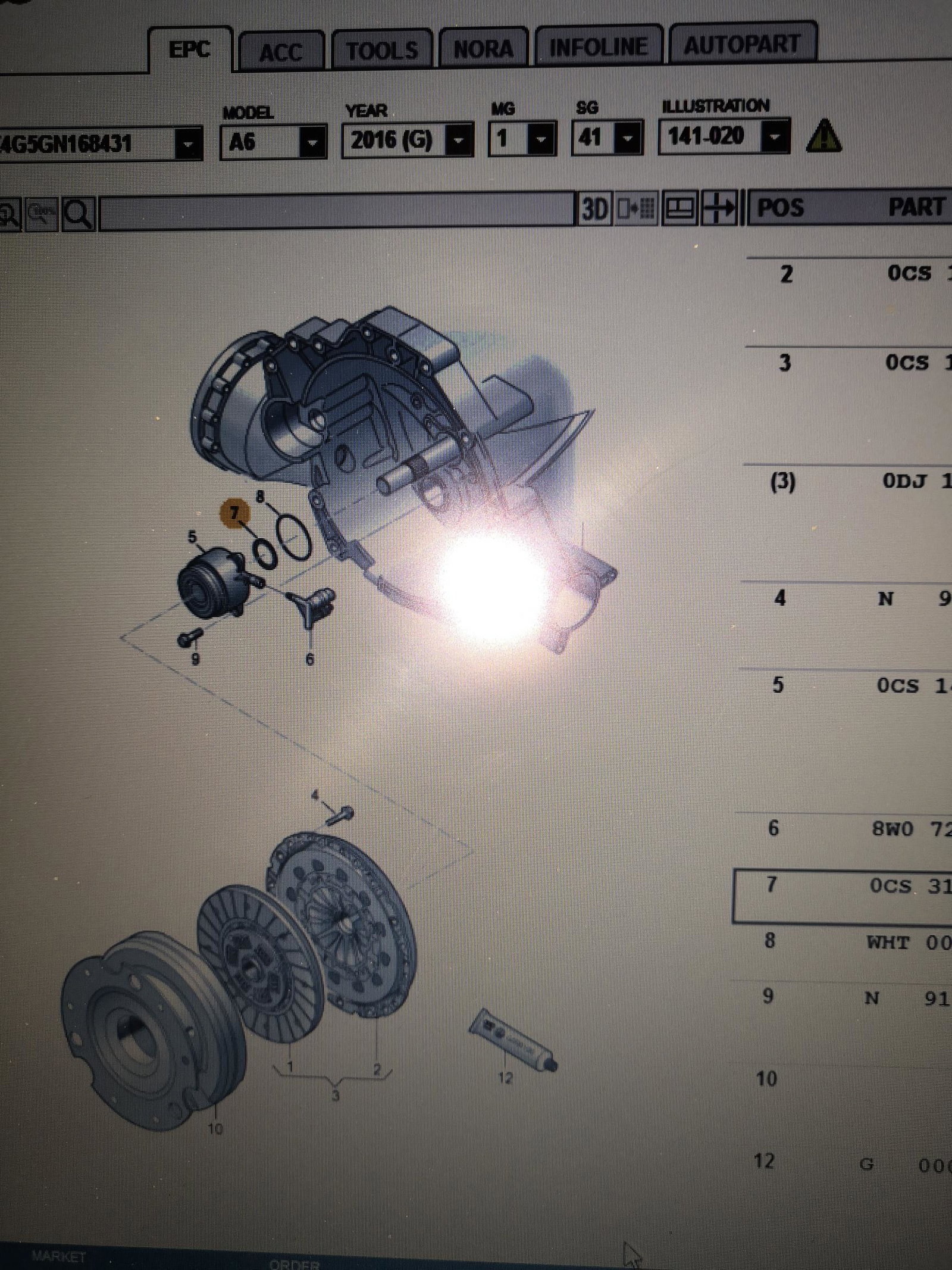

Stevey Y Posted November 25, 2021 Posted November 25, 2021 On 11/16/2021 at 7:34 PM, Phil jessop said: Hi Gareth This clutch saga drags on... I got the Audi back from mr clutch with what i think is a hefty bill £2.300, it seems they used parts from TPS, i phoned TPS & got it out of them he trade price which is 4 figs..ouch, when i drove away from the garage the vibration was still there & it was noisy dipping the clutch like a metallic sound & could smell gear oil, i got it to my works & phoned the RAC & when the guy came out he listened to the clutch & said its probably not fitted correctly & mentioning the Crankshaft play he dismissed this & said if it was bearings going it would be noisy & its ticking over sweet & must take the car back to them which i did & the guy put it up on ramp & said that its probably not the clutch but its 99% certain its the crank as there is 6m play & when in gear you can see the pully on the front go in & out he said it should be no more than 3m, I had to take the car away & got home next day the clutch was slipping under acceleration & still had the strong gear oil smell & then it went into limp mode I got it to Audi & as i know one of the staff he got a tech out to listen & said the crank shaft do not wear i said that it has 6m play but he did not check just listened & said its clutch installation is the problem, they printed out a diagnosis report & the was a catalogue of errors showing he said that in fitting they have done something wrong & must take it back to mr clutch which i did, the car has been with them since last week & they said they will strip it out & put another new complete clutch in, i went there today & was told all the new clutch has arrived except a gearbox bearing where there was a small leak which i said so the oil has got on the clutch plate & he said no its dry, they need the car for 2/3 more days, but was unsure why it went into limp mode but will put it on their computer & set it back up, the guy said to me when its done if there are any scraping metallic problems then its the crankshaft moving from back to front, personally im dreading when i pick it up. Hi the oil is getting into the gearbox via the release bearing, the radial seal that goes in the back of the release bearing is sold separately and I wouldn't mind betting that they didn't change the release bearing outer seal, the only reason I know any of this was because I went through the same thing a couple of months ago, it was no fault of the garage I used just the pr@ts that supplied the clutch forgot to tell us about the extra seals because we didn't ask, as I said you can't trust Mr Crutch, I am still wondering what gearbox bearing they are going to change as I saw a lot of the inside of my one and you can't get at any bearings without stripping the box down. Steve . Steve.
Phil jessop Posted November 25, 2021 Author Posted November 25, 2021 35 minutes ago, Stevey Y said: Hi the oil is getting into the gearbox via the release bearing, the radial seal that goes in the back of the release bearing is sold separately and I wouldn't mind betting that they didn't change the release bearing outer seal, the only reason I know any of this was because I went through the same thing a couple of months ago, it was no fault of the garage I used just the pr@ts that supplied the clutch forgot to tell us about the extra seals because we didn't ask, as I said you can't trust Mr Crutch, I am still wondering what gearbox bearing they are going to change as I saw a lot of the inside of my one and you can't get at any bearings without stripping the box down. Steve . Steve.
Stevey Y Posted November 25, 2021 Posted November 25, 2021 4 minutes ago, Phil jessop said: Hi Phil you quoted my post and then no reply from your good self. Steve.
Phil jessop Posted November 25, 2021 Author Posted November 25, 2021 Just now, Phil jessop said: Hi Steve, The car is still in the garage with the clutch stripped & they have got a new replacement to fit in, they said the oil was coming from the diff & they took it off & got a local company to fit in 2 seals at mr clutch expense which i was told is £280, i have complained to them several times over this last week or more & they said they are short staffed so i sent a letter to their head office yesterday & got a reply today to say they have had to order a tool to check the crankshaft end float ? & they also said as the car had been remapped this too was contribute to excessive wear to the crankshaft float. god knows whats happening next, I just hope they ask me for them to repair the problem as im at my wits end now, im in the rac & considering having the car removed & taken to an audi garage instead.
Stevey Y Posted November 25, 2021 Posted November 25, 2021 26 minutes ago, Phil jessop said: Hi Steve, The car is still in the garage with the clutch stripped & they have got a new replacement to fit in, they said the oil was coming from the diff & they took it off & got a local company to fit in 2 seals at mr clutch expense which i was told is £280, i have complained to them several times over this last week or more & they said they are short staffed so i sent a letter to their head office yesterday & got a reply today to say they have had to order a tool to check the crankshaft end float ? & they also said as the car had been remapped this too was contribute to excessive wear to the crankshaft float. god knows whats happening next, I just hope they ask me for them to repair the problem as im at my wits end now, im in the rac & considering having the car removed & taken to an audi garage instead. Hi do not go to Audi unless you want to remortgage your house, the oil is not coming from the Diff its the N/S driveshaft seal where the driveshaft runs through the bell housing in to the Diff I know I replaced my seal when the box was out, if they don't renew the seal around the release bearing outer where it meets the bell housing and the radial seal that goes inside the release bearing, [marked in yellow] you are wasting your time. as for the end float I think they are passing the buck to try and smokescreen the fact they have buggered it up on a monumental scale. Steve
Phil jessop Posted November 25, 2021 Author Posted November 25, 2021 Thanks steve for the diagrams.. By looking at the yellow marked seal that's what was replaced as its on the left hand side of the gearbox that goes from the bellhousing to the diff he mentioned they replaced another seal too as a matter of course.
Stevey Y Posted November 25, 2021 Posted November 25, 2021 5 minutes ago, Phil jessop said: Thanks steve for the diagrams.. By looking at the yellow marked seal that's what was replaced as its on the left hand side of the gearbox that goes from the bellhousing to the diff he mentioned they replaced another seal too as a matter of course. Hi both seals in the diagram are on the release bearing, the driveshaft seal is again separate but on another diagram I have but it made sense to rush out and buy one as the original had been on for just over 100k and was a bit crusty, all three seals were £30 from Audi. Steve.
