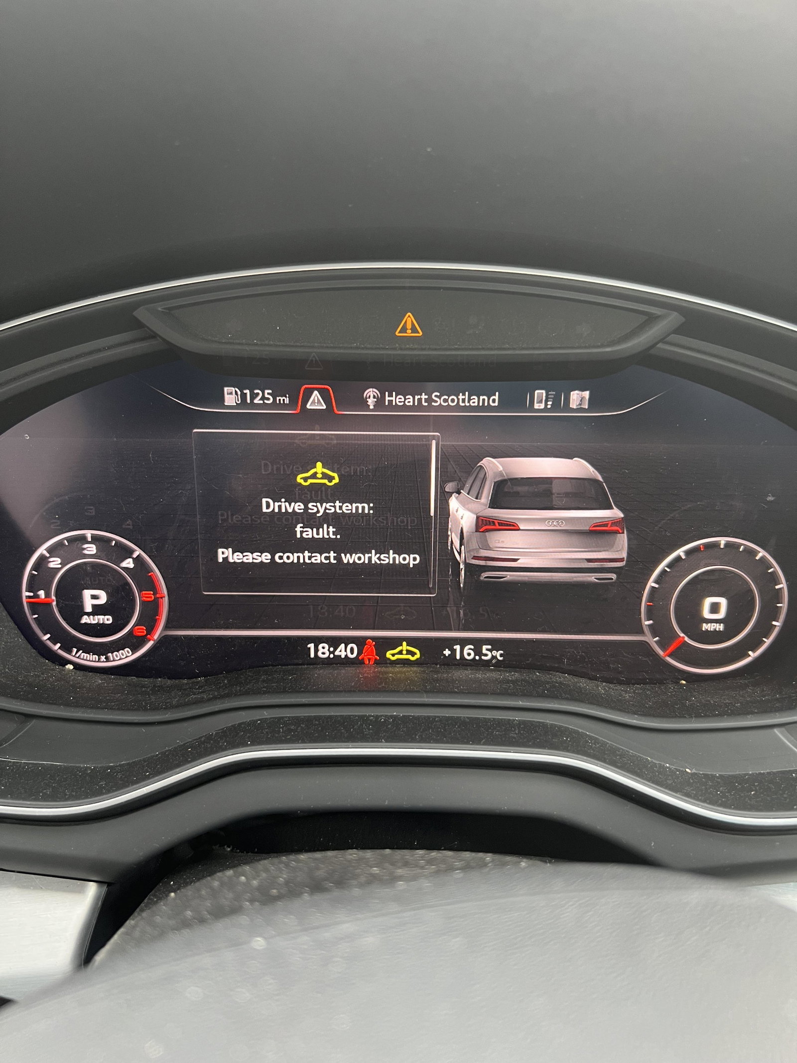

Stevebramwell Posted June 2, 2023 Posted June 2, 2023 I’ve just had the same thing happen to me. Don’t think it’s a fuel problem as the engine runs fine just in limp mode. Think it may be electrical??? Switch the engine off and back on again and all is well. It happen once two weeks again and today it’s happened 3 times. I asked Audi to check for faults (£140) when it was in for a service. They said there were no faults recorded on the car and to be fair didn’t charge me for checking. My Audi is a Q5 2019. See attached
Justme Posted September 13, 2023 Posted September 13, 2023 Hi Steve, have you been able to resolve the Limp mode issue. From the picture you posted, I have exactly the same.

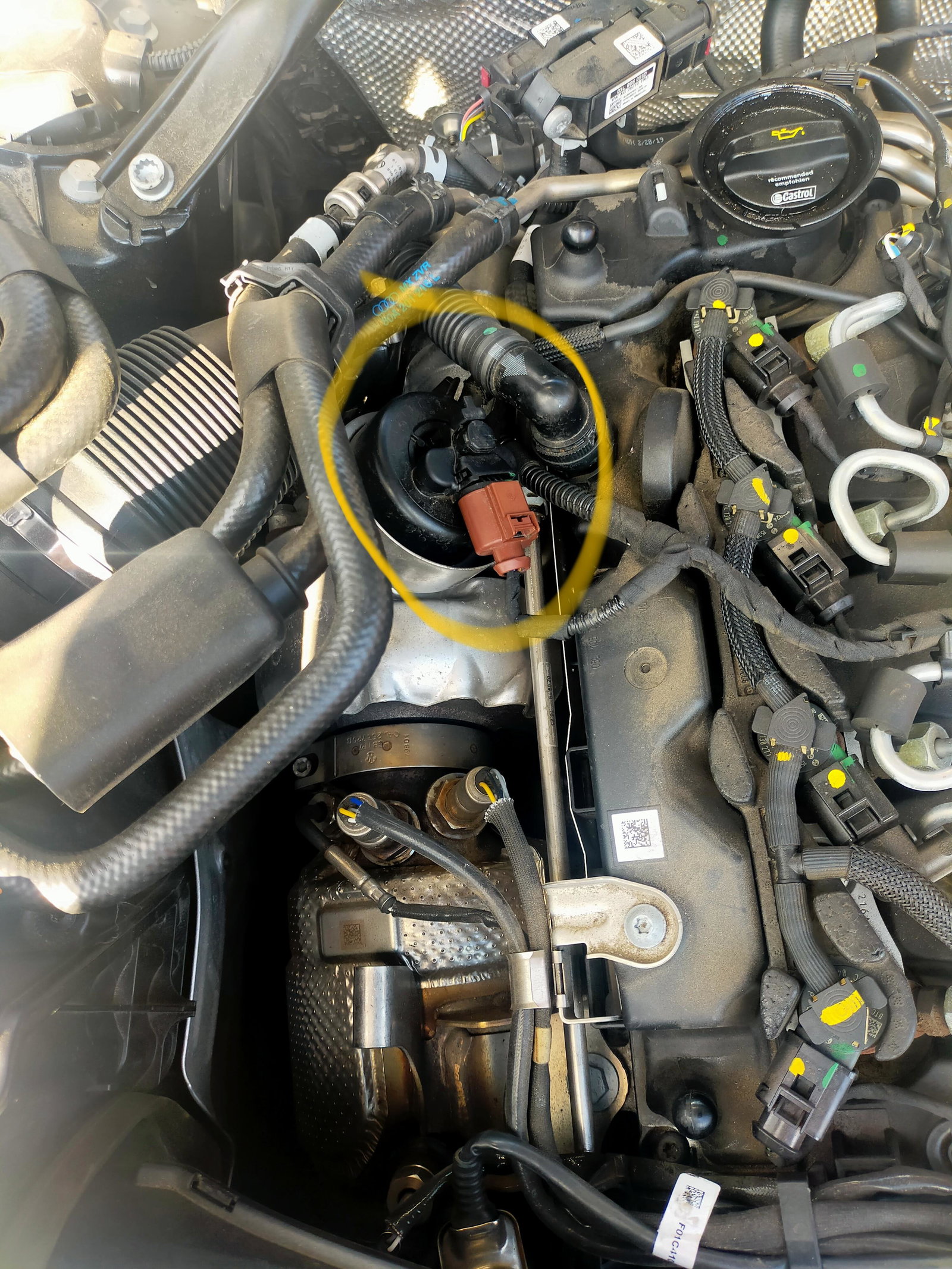

ren2006 Posted July 20, 2024 Posted July 20, 2024 Thanks for your reply I will try to get a new MAP sensor

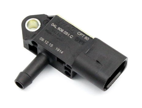

ren2006 Posted July 22, 2024 Posted July 22, 2024 On 7/20/2024 at 7:45 PM, Mr_S49 said: I had my car inspected by my local Audi specialist garage, the drive system fault errors were related to a turbo under boost issue. Unfortunately the garage were unable to recreate the fault but recommended to change the MAP sensor as that was the first error appearing. 100% solved the problem. My car is a 2019 Q5 2.0 40 TDI Sport. Is this MAP sensor?!
Mr_S49 Posted July 22, 2024 Posted July 22, 2024 The part that was replaced in my car was p/n 04L 906 051 K 1
