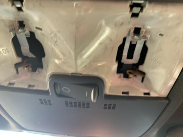

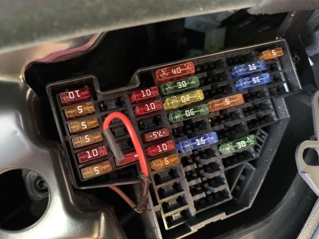

Daddynoob Posted November 7, 2021 Posted November 7, 2021 My son has just bought a a3 2006 but the interior lights aren’t working so I checked the fuse and one of the 10 amps had blown but I only had a 7.5 but still didn’t work so I opened the light to check the bulb and there was no bulbs in any of the interior lights 😱 so I had a spare one which I put in and still no joy there is no power going to the bulb holder can anyone confirm the fuse location or anything else it could bec the boot one works 🥳 can send photos of fuses if needed
Magnet Posted November 7, 2021 Posted November 7, 2021 Hello Shaun, Many thanks for being in touch with the forum - perhaps some of the following may help :- Have you got an owner’s manual for the car? If you do, then you will already know the fuse location from reference to the book. If you don’t, you should find one on eBay. Anyway, on my 2006 A3, the fuse is No.15 (yes 10 amp rated),and this is located in the fuse box to be found by removing the cover panel from the end of the left hand side of the dashboard - will be evident when the passenger door is open. No. 15 is in the 3rd row down, and just short of half way along. Does this sound like the location of the blown fuse you changed? ‘…..boot light working..’ - that may (in caps) be controlled by the courtesy light activation. If the fuse you have replaced is the correct location, then it’s worth removing it again, and squirting some contact cleaner into the holder before replacing the fuse. ‘…..no bulbs….’ Any chance someone had tried fitting LEDs and messed something up? If the fuse is serviceable (and yes a lower rated 7.5 should do for test purposes) and so are the bulbs, then it’s half an hour out with a meter to check voltages and earths. If you are not too confident with a meter then I would suggest it would be worth investing in an hour with a trusted local auto electrician. Perhaps you could let us know how you get on. Kind regards, Gareth. Kind regards, Gareth. 1

Magnet Posted November 7, 2021 Posted November 7, 2021 Thanks. It would be daft for me to ask if you have tested the switch - it’s in the off position in your photo.
Stevey Y Posted November 7, 2021 Posted November 7, 2021 Hi if there is no power going to the bulb holder it won't matter what position the switch is in, looking at the picture of the fuse box what is the random DIY wire about it may be that someone else has been having a go, my only suggestion is to run a new live feed in from the correct side of the fuse if it is showing power across the fuse, alternatively run a live feed from one of the spare fuse stations that has power one side but from reading the first post I would be checking the earthing first. Steve.

Daddynoob Posted November 8, 2021 Author Posted November 8, 2021 I think the fuse with the wire coming out might have been a previous head unit install for a permanent live or it could be for the parrot hands free that is installed not sure what else the light problem could be if the fuse is ok
