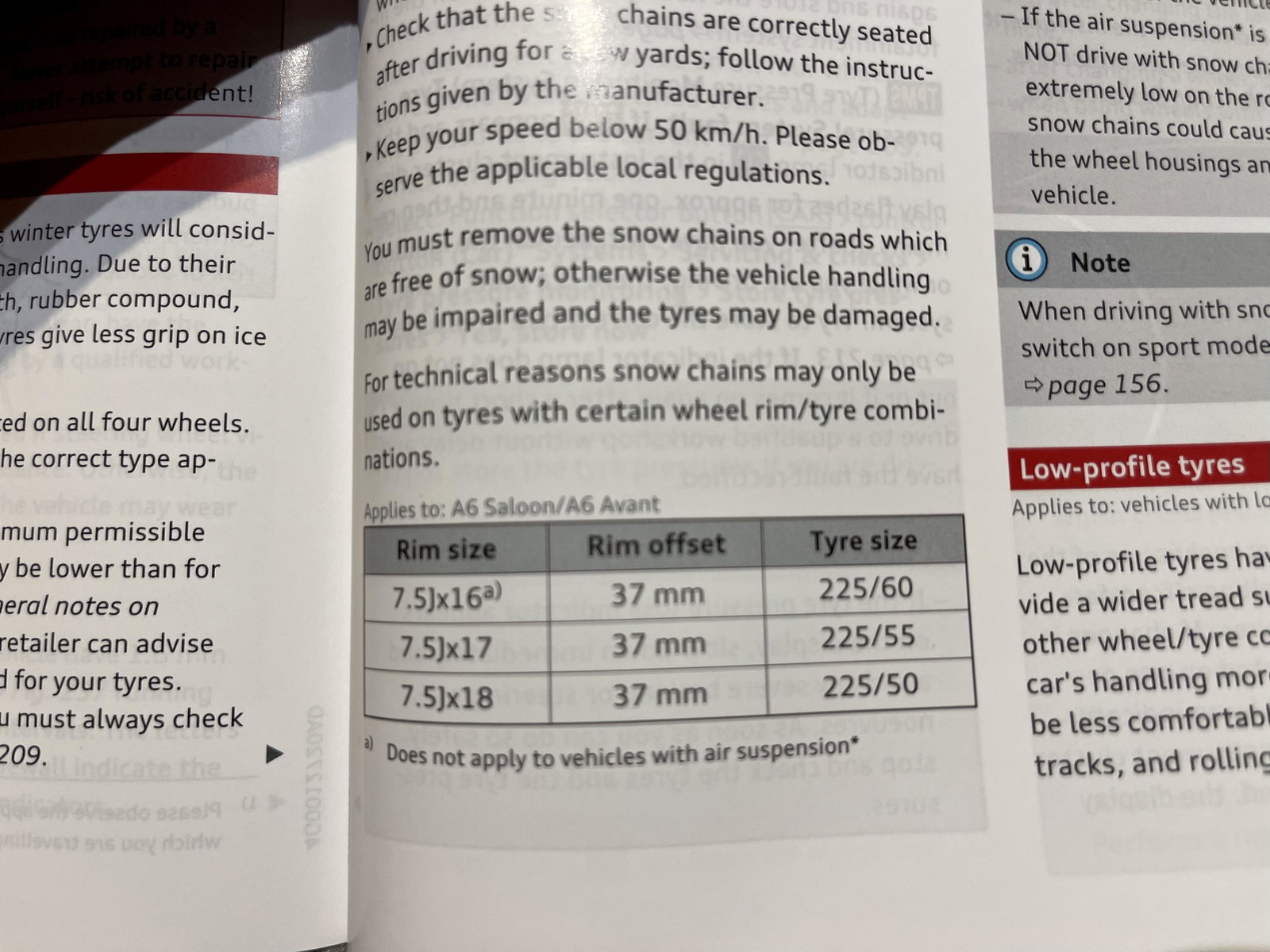

Rafal Posted November 9, 2021 Share Posted November 9, 2021 Morning all, I need help guys. I got A6 2017 S line Black Ed, on 20 inch wheels as standard. Winter tyres in this size are crazy expensive. I have set of 4 winter tyres from my prev Audi A4, 225/55/17. If I’ll get set of rims 17 inch 6,5 or 7J with et 37 or 38 will they fit ? Does my car have bigger brakes than normal A6 SE as they did come with 17 inch wheels sometimes ? Set of 4 rims will cost me 3 times less then new 20 inch winter tyres. And the fact I have set of neraly new good winter tyres in 17 inch its no brainer. Please help me Thanks Quote Link to comment Share on other sites More sharing options...

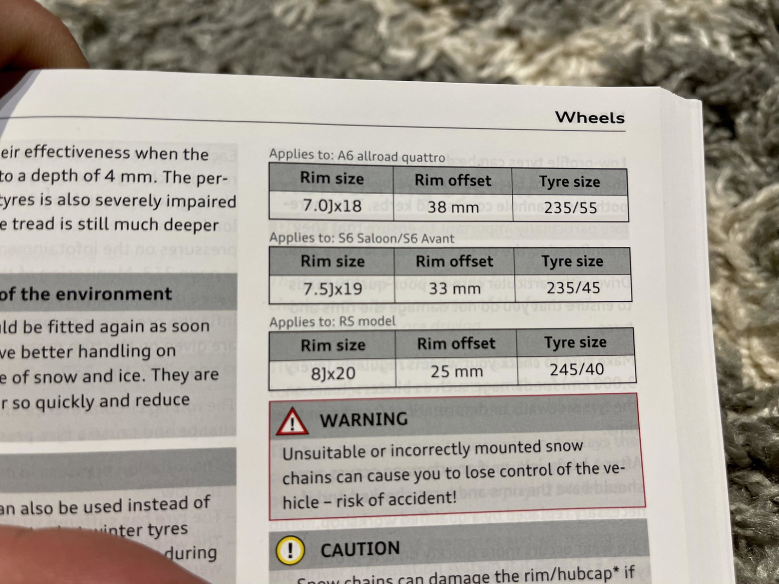

Magnet Posted November 9, 2021 Share Posted November 9, 2021 No problem, but please check my maths, and be aware that the 17 inch tyres are 30mm narrower than the ones you have on now. Don’t discount this, or the need to check what the actual book specified tyre size was for 17 inch wheels which you say could have been fitted as an option when new. Quote Link to comment Share on other sites More sharing options...

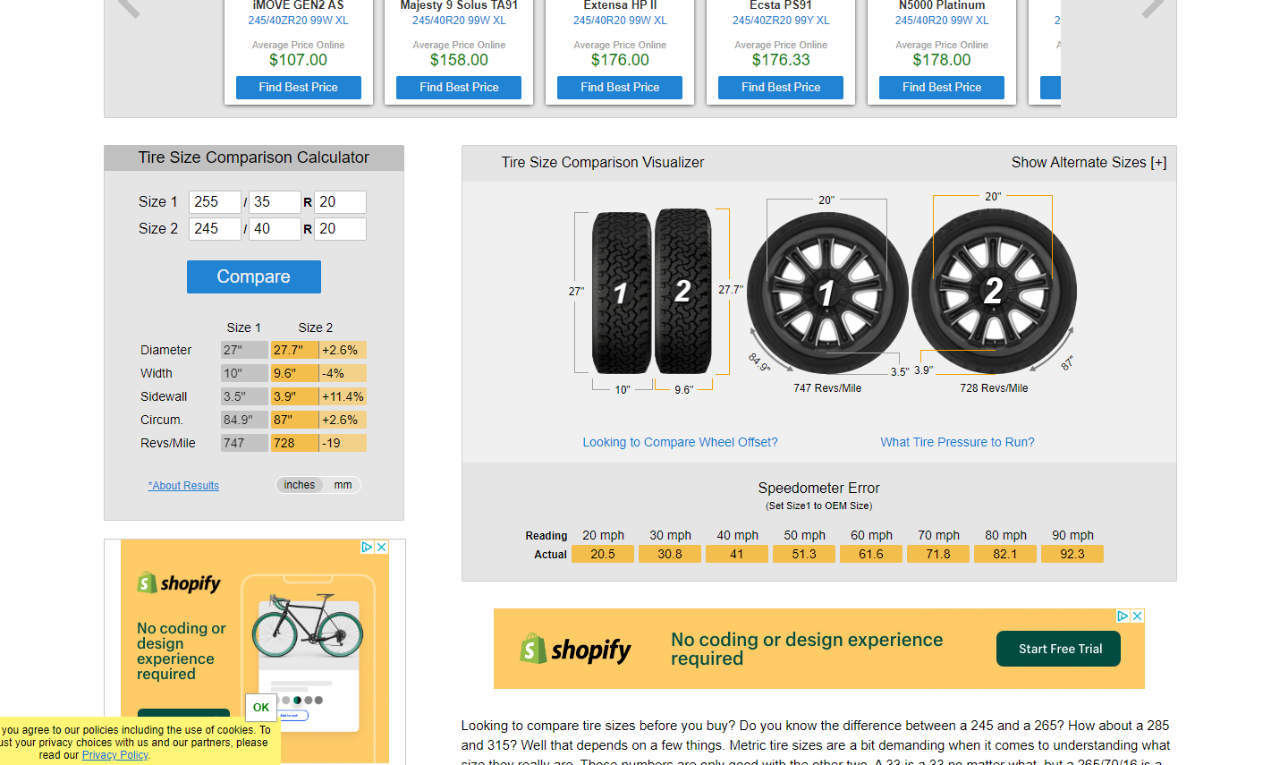

K3v Posted November 9, 2021 Share Posted November 9, 2021 https://tiresize.com/comparison/ That's a good website for checking your maths. Have a check on this but IIRC that there was a BITDI SE that did come with 17" wheels, you could look into those wheels as i guess if they fit a BITDI then they will fit your car. I have an 3.0 272 allroad with 255/40R20 tyres and I'm looking into winter wheels too, have you looked in your manual? I think although 17" will fit my car i think 18" wheels with 235/55R18s are recommended for my car. 1 Quote Link to comment Share on other sites More sharing options...
Rafal Posted November 9, 2021 Author Share Posted November 9, 2021 2 hours ago, Magnet said: No problem, but please check my maths, and be aware that the 17 inch tyres are 30mm narrower than the ones you have on now. Don’t discount this, or the need to check what the actual book specified tyre size was for 17 inch wheels which you say could have been fitted as an option when new. That’s the exact size tyre for 17 inch for Audi not just a6 also a4 Quote Link to comment Share on other sites More sharing options...

Rafal Posted November 9, 2021 Author Share Posted November 9, 2021 (edited) Guys I can’t believe it ! As K3v said, answer is right there in the book: That exactly size of the rim Im after 7,5J x 17 5x112 centre bore 66.5. If anyone come across set of brand new set of steel rims in black please let me know thanks Edited November 9, 2021 by Rafal Quote Link to comment Share on other sites More sharing options...

Magnet Posted November 10, 2021 Share Posted November 10, 2021 Blinking heck Raf, You are wearing out my old brain! Won’t be able to do that until later in the day. ‘Formula’:- For 245/40 - work out 40% of 245mm and multiply by 2. Then add the wheel diameter in mm. I take it you know that to convert inches to mm. you will need to multiply by 25.4. I’ll check it when you have worked it out. For 255/35 - work out 35% of 255mm……….. Kind regards, Gareth. p.s. Sorry, but I just cannot follow your logic when you said ‘225 will always be better than 255 for winter….’ Are you really believing narrower tyres will give you better grip on snow and ice? Quote Link to comment Share on other sites More sharing options...
Rafal Posted November 10, 2021 Author Share Posted November 10, 2021 10 minutes ago, Magnet said: Blinking heck Raf, You are wearing out my old brain! Won’t be able to do that until later in the day. ‘Formula’:- For 245/40 - work out 40% of 245mm and multiply by 2. Then add the wheel diameter in mm. I take it you know that to convert inches to mm. you will need to multiply by 25.4. I’ll check it when you have worked it out. For 255/35 - work out 35% of 255mm……….. Kind regards, Gareth. p.s. Sorry, but I just cannot follow your logic when you said ‘225 will always be better than 255 for winter….’ Are you really believing narrower tyres will give you better grip on snow and ice? Offcourse they will. Not just better grip but better performance overall. Better braking distance etc. Trust me on this one I’ve been using winter tyres from about 20 yrs. Hence the reason Audi recomended 245/40 for 20 inch for winter not 255/35 like for summer Thanks Quote Link to comment Share on other sites More sharing options...
K3v Posted November 10, 2021 Share Posted November 10, 2021 (edited) 16 minutes ago, Rafal said: Offcourse they will. Not just better grip but better performance overall. Better braking distance etc. Trust me on this one I’ve been using winter tyres from about 20 yrs. Hence the reason Audi recomended 245/40 for 20 inch for winter not 255/35 like for summer Thanks If you search the part number of the wheels, you will find the bore/offset etc. any part which starts with 4G is for the audi a6 c7, i believe. If it was me wanting 17s, i think i would be looking for some alloys, there are two or three styles, i think, there are audi winter ones, which are the german ones which are 7.5J and then there are uk spec (SE?) wheels which are 8J, but i think your tyres would be ok on them, id do some research first but its not a big increase in width. There are companies who make/sell steel wheels but as to price, might be more cost effective just to get some second hand alloys. your call on that one though 🙂 Below is the size comparison, as Audi recommend them as i am sure you know, they will be within tolerance, even if not, all it does is alter your speedo reading, but if you are aware of this its ok... Re the widths, it does seem to be received wisdom that thinner with taller tyres is the way to go. Edited November 10, 2021 by K3v Quote Link to comment Share on other sites More sharing options...
Rafal Posted November 10, 2021 Author Share Posted November 10, 2021 So bit of speed different then actual on dash ? That should not be an issue just wonder of they not gonna rubb or something. Honestly I like the look of my car on 20 inch but its so uncomfortable regardless of setting of the susspension and now for winter causing me a big problem… Thanks Quote Link to comment Share on other sites More sharing options...
K3v Posted November 10, 2021 Share Posted November 10, 2021 (edited) Exactly your speedo will read slower than than actual According to the screen grab, the overall diameter is 0.7" larger, so 0.7/2*25.4=8.9mm larger radius and 8.9mm closer to your wheel arch, not a lot really. Edited November 10, 2021 by K3v Quote Link to comment Share on other sites More sharing options...

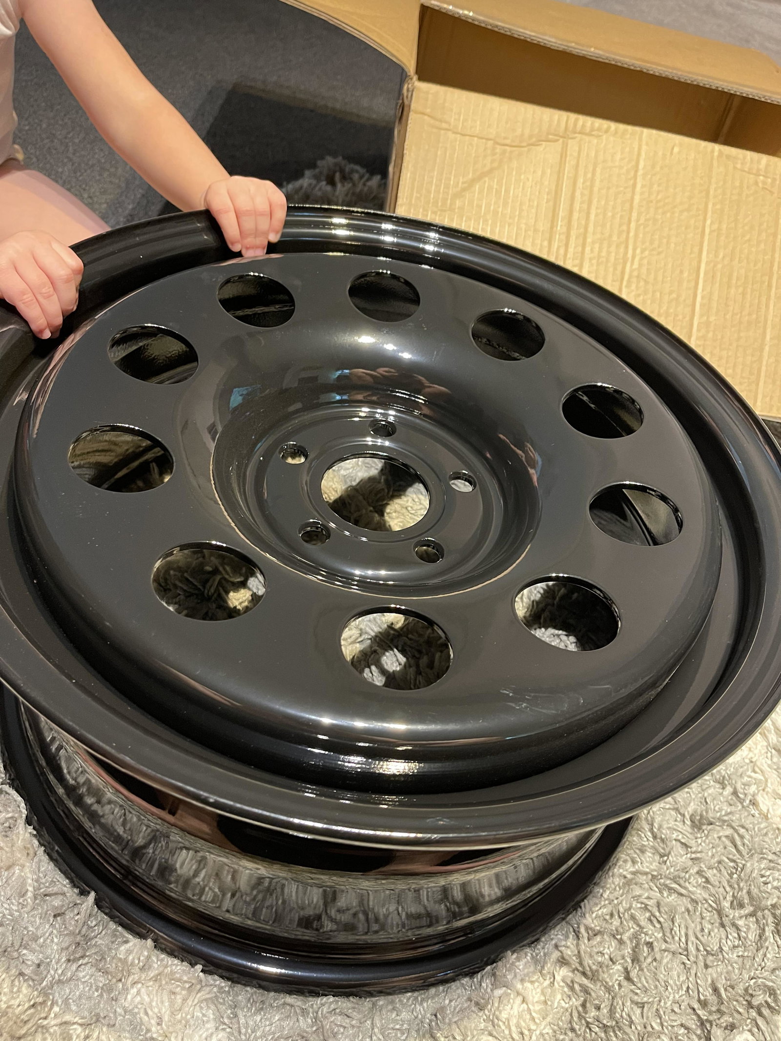

Rafal Posted November 10, 2021 Author Share Posted November 10, 2021 Was able to secure set of 4 steel wheels, exact size and everything I want. I want my car on black steel wheels for winter I always did that way. Thanks for all your help guys and will let you know once fitted. Regards Quote Link to comment Share on other sites More sharing options...
beemerboy9 Posted November 10, 2021 Share Posted November 10, 2021 (edited) 12 minutes ago, Rafal said: Was able to secure set of 4 steel wheels, exact size and everything I want. I want my car on black steel wheels for winter I always did that way. Thanks for all your help guys and will let you know once fitted. Regards For anyone following this, there is an eBay seller offering an apparently unmarked set of 17" alloys with 4 winter tyres, 2 good + 2 poor for £400. My car has come off its 20's and onto 17's for ride comfort. I have bought from these guys before. Edited November 10, 2021 by beemerboy9 Quote Link to comment Share on other sites More sharing options...
Rafal Posted November 11, 2021 Author Share Posted November 11, 2021 Rims just arrived 😉 Will try check if they fit tomorrow. Thanks Quote Link to comment Share on other sites More sharing options...

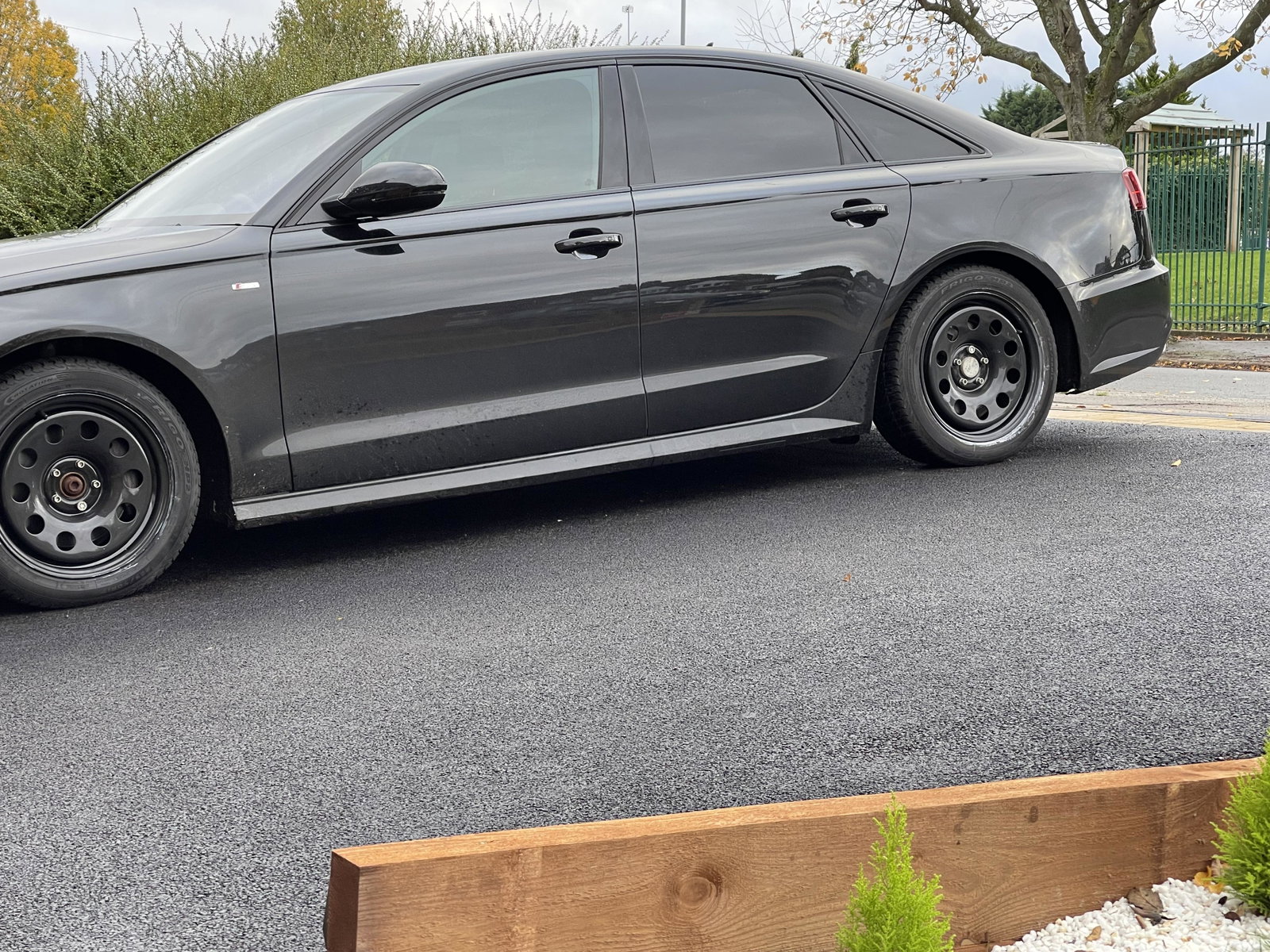

Rafal Posted November 12, 2021 Author Share Posted November 12, 2021 Fitted and looks exactly how I want 😉 Thanks Quote Link to comment Share on other sites More sharing options...
K3v Posted November 12, 2021 Share Posted November 12, 2021 I was expecting the wheels to look lost in the arches, but looks fine! May I ask where you got the wheels from? Quote Link to comment Share on other sites More sharing options...
