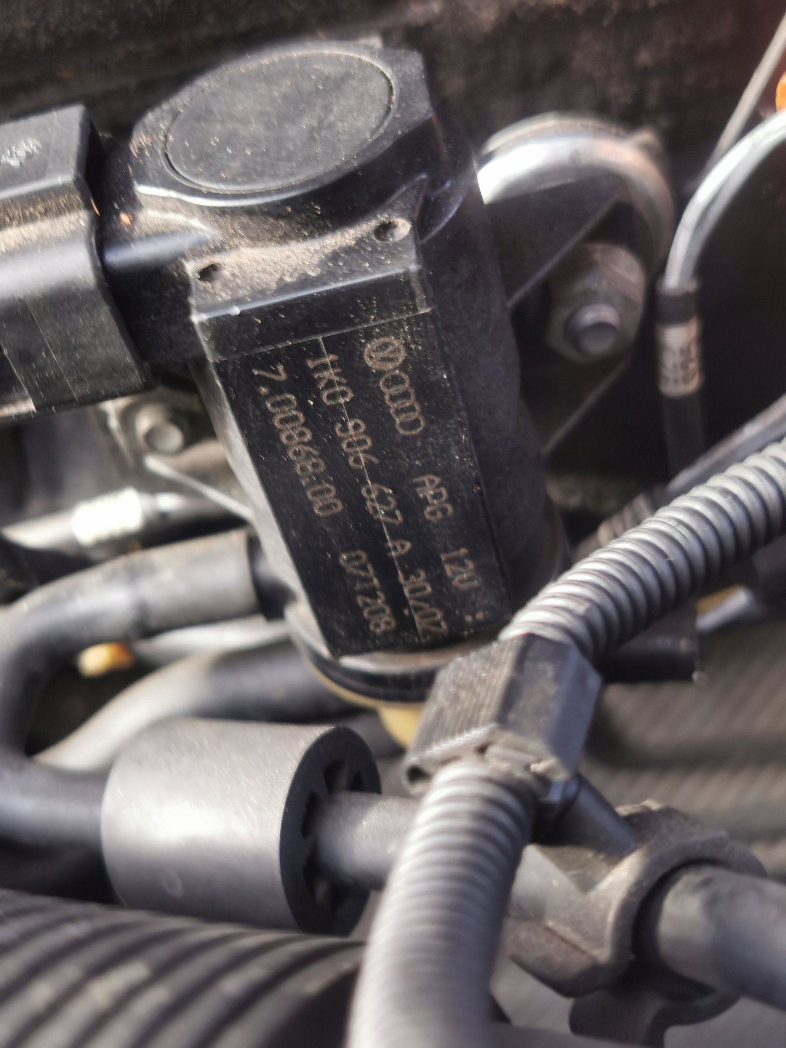

ash_BNM Posted November 14, 2021 Author Share Posted November 14, 2021 Any vagcom experts here? VID-20211114-WA0008.mp4 After spending half of my Sunday diagnosing My N95 valve is continuously opening and closing actuator. Voltage seem to go up and down whilst it opens and closes, when I run a VCDS output test in the valve, it goes steady at just over 1v and actuator stops moving. I am at a lost cause and thinking of moving back to vauxhall! Haha Quote Link to comment Share on other sites More sharing options...
Stevey Y Posted November 14, 2021 Share Posted November 14, 2021 Hi thats cracked it, Just looked and that is your problem if you plumb in to google the part number on your original unit it will come up with loads of them apparently VW use the same unit and its called N75 that is definitely your problem as the solenoid is not holding pressure which is why the actuator is bouncing up and down, just mark the pipes 1-2-3 when you take them off and put a mark diametrically on the old unit for reference, don't go back to Vauxhall otherwise you will be on Valium for the rest of your life Steve. Quote Link to comment Share on other sites More sharing options...
Stevey Y Posted November 14, 2021 Share Posted November 14, 2021 Hi a top of the range pierburg unit on eBay is only about £40, happy hunting. Steve. Quote Link to comment Share on other sites More sharing options...
ash_BNM Posted November 14, 2021 Author Share Posted November 14, 2021 2 hours ago, Stevey Y said: Hi thats cracked it, Just looked and that is your problem if you plumb in to google the part number on your original unit it will come up with loads of them apparently VW use the same unit and its called N75 that is definitely your problem as the solenoid is not holding pressure which is why the actuator is bouncing up and down, just mark the pipes 1-2-3 when you take them off and put a mark diametrically on the old unit for reference, don't go back to Vauxhall otherwise you will be on Valium for the rest of your life Steve. 2 hours ago, Stevey Y said: Hi a top of the range pierburg unit on eBay is only about £40, happy hunting. Steve. Hello Steve, Only me again and part ordered with a wish it fixes this problem. Worth a shot anyway as looking at the current one it may even be the original looking at the date code on that. Part ordered and for anyone else looking for this valve, it's the Pierburg N75 - Part number - 7.00868.02.0 to replace OEM part 1J0 906 627 B or 1K0 906 627 Let's see if we have finally cracked this issue! A pub crawl with unlimited pints on me Steve! Quote Link to comment Share on other sites More sharing options...
Stevey Y Posted November 15, 2021 Share Posted November 15, 2021 19 hours ago, ash_BNM said: Hello Steve, Only me again and part ordered with a wish it fixes this problem. Worth a shot anyway as looking at the current one it may even be the original looking at the date code on that. Part ordered and for anyone else looking for this valve, it's the Pierburg N75 - Part number - 7.00868.02.0 to replace OEM part 1J0 906 627 B or 1K0 906 627 Let's see if we have finally cracked this issue! A pub crawl with unlimited pints on me Steve! Hi thank you, I am pretty sure once the new part is fitted you will be swimming in the sweet smell of success let us know how you get on, I had one of those apart once out of boredom they are basically a diaphragm with a pressure sensitive film running down the middle, good idea in principle but when living in a superheated environment the plastic membrane becomes brittle and won't work, I sincerely hope that fixes it then we can move on the gear box issue. Steve. Quote Link to comment Share on other sites More sharing options...
ash_BNM Posted November 17, 2021 Author Share Posted November 17, 2021 Hello Steve, I got the N95 part, fitted it, to our not so good news, still exact same fault. Do you think this has something to do with the swirlflaps? Something even on idle is causing the actuator to open and close moving the VANES open and close. The opening and closing of the VANES is mirroring when i go in drive and start driving, as even when driving, i can hear the VANES open and close every 5 seconds. I am now looking at swirlflaps, the vac pipe sensor at the front of the engine which has a plastic rod going into the timing belt area(what is this) It is really strange how nobody has posted anything about this fault code even on google. There must be some BNM engine gurus out here who could help. Thank you for all your help. Ash Quote Link to comment Share on other sites More sharing options...
