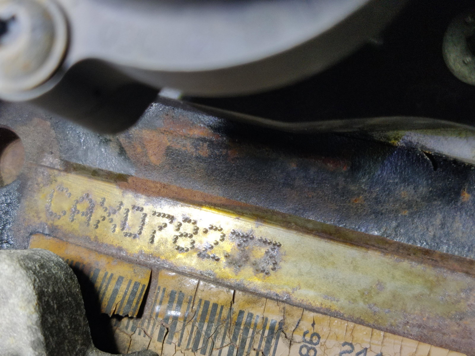

I have an audi a3 1.4 tfsi with a 6 speed manual transmission which I need to replace

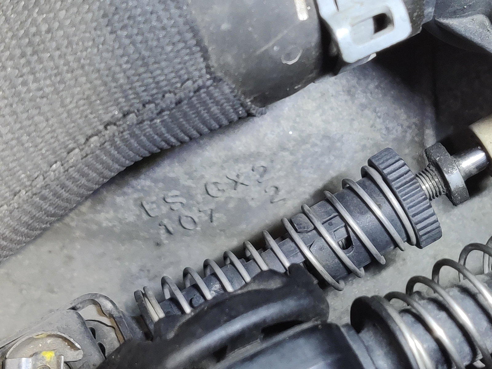

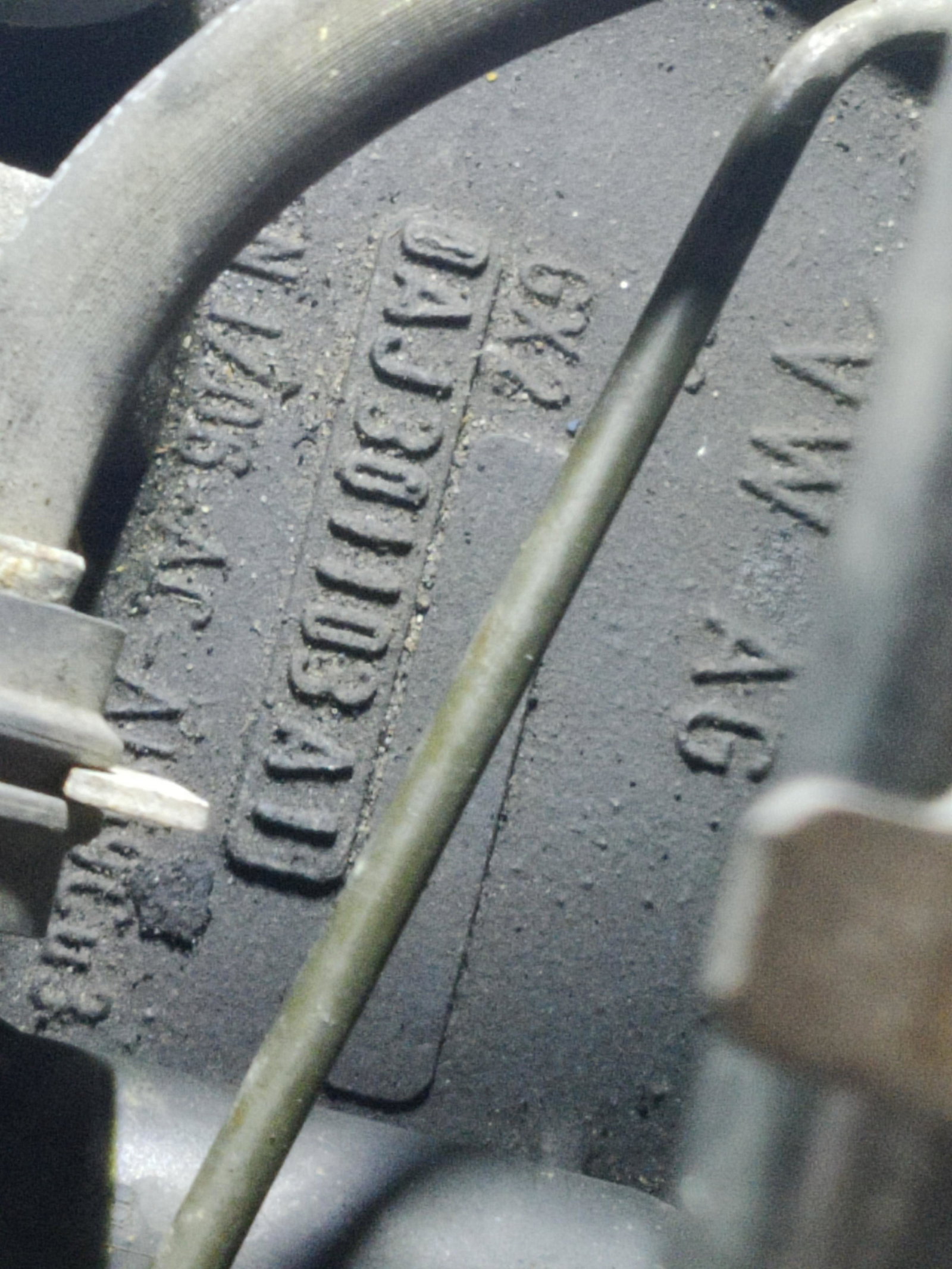

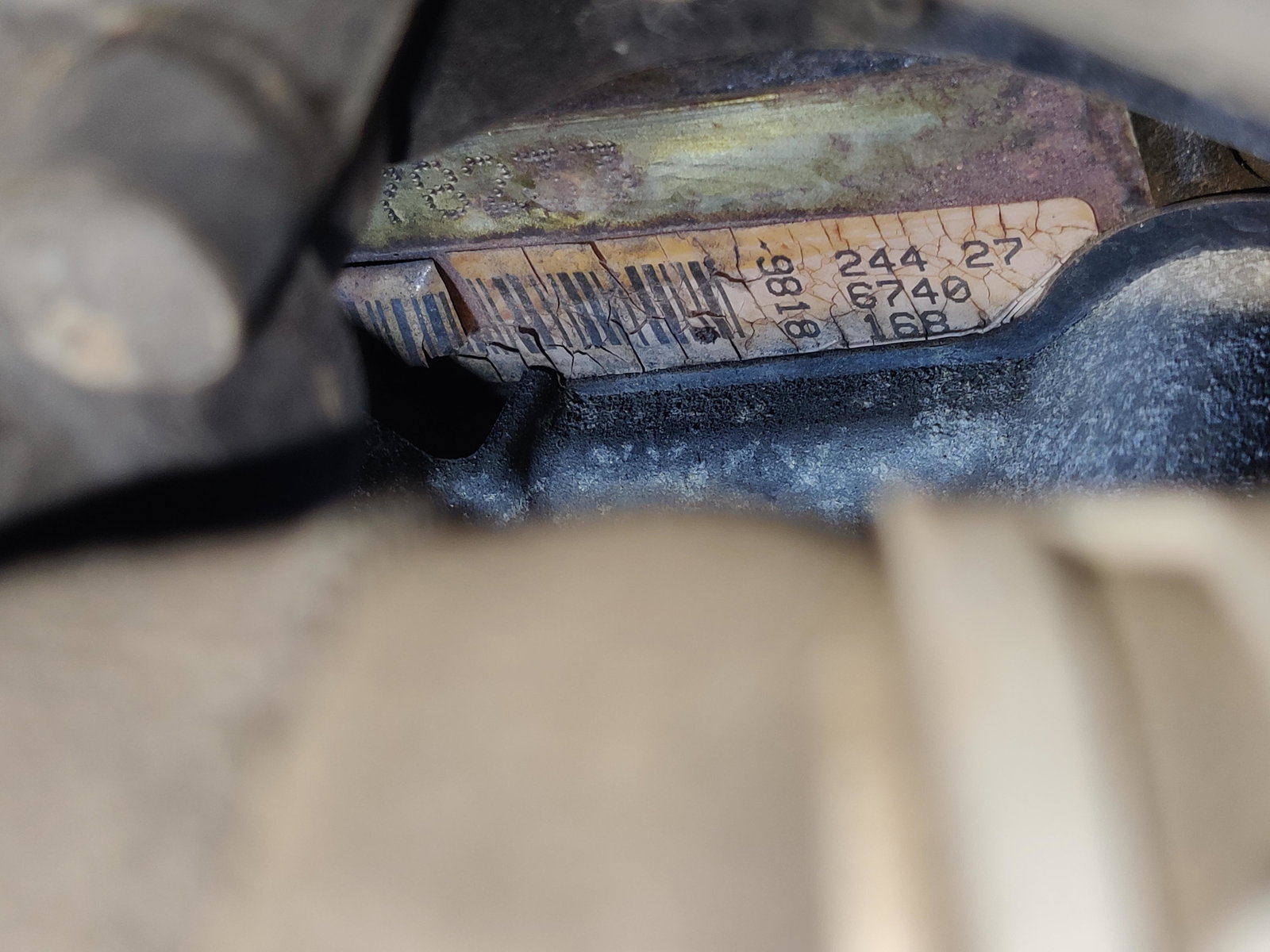

I need some help finding out which code my box is, Im pretty sure that mine is a 0AJ, id appreciate If Somebody Is able to help me confirm that im right by taking a look at the attatched photos ive taken of the visable markings I can see on the top of the bell housing..
Can Somebody Please tell me which code gearbox I can replace this one with
In ones expert opinlon Would anybody recomend that instead of replacing the Whole transmission that i should remove the gearbox, dismantle and identify the issue ( which happens to be a rattle sound coming from the transmission but goes quieter when I put foot down on the clutch ) ( could this be the thrust bearing? ) and then rebuild transmission with new internal parts

Hi you have the correct code but I don't think its the box, it sounds as if it might well be a clutch problem, thrust bearing, flywheel, first motion shaft bearing, drive shafts won't stop rattling if you push the clutch down, especially when you are not moving.
