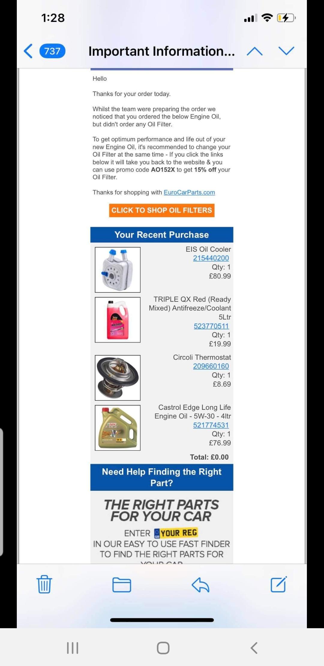

Re. Your? Your garage? - order with ECP, then personally, I would not buy, or fit that brand of thermostat. If you insist on buying from ECP then you will find a selection of other more expensive brands of thermostats to the right of the screen which shows the chosen (cheapest?) one on the left.
Just in passing - I see they are (correctly) pointing you to changing the oil filter as well. Again you will find that they will promote you to buy a Crossland brand - their ‘own’ brand name of a once respected filter manufacturer - now just another bought-out brand name. Would I use one? No. I would only use Mann or Bosch at marginally more expense.
I didn't buy anything the lad done it all an baught all this before i got it i just baught the car on monday an noticed it was losing coolant an blowing cold air wen heater was on hot
Sorry Gary, but you are succeeding in confusing me something terrible!
I’m now getting the impression that that list refers to what was fitted, as opposed to what you now intend to have fitted - but that’s a guess!
Anyway, whatever, my earlier comments apply to what I would fit now.
Yea thats wat he had done an fitted apart from the oil cooler he said he didn't have time to hav it fitted thanks for all ur help i need to buy a decent thermostat an try that
