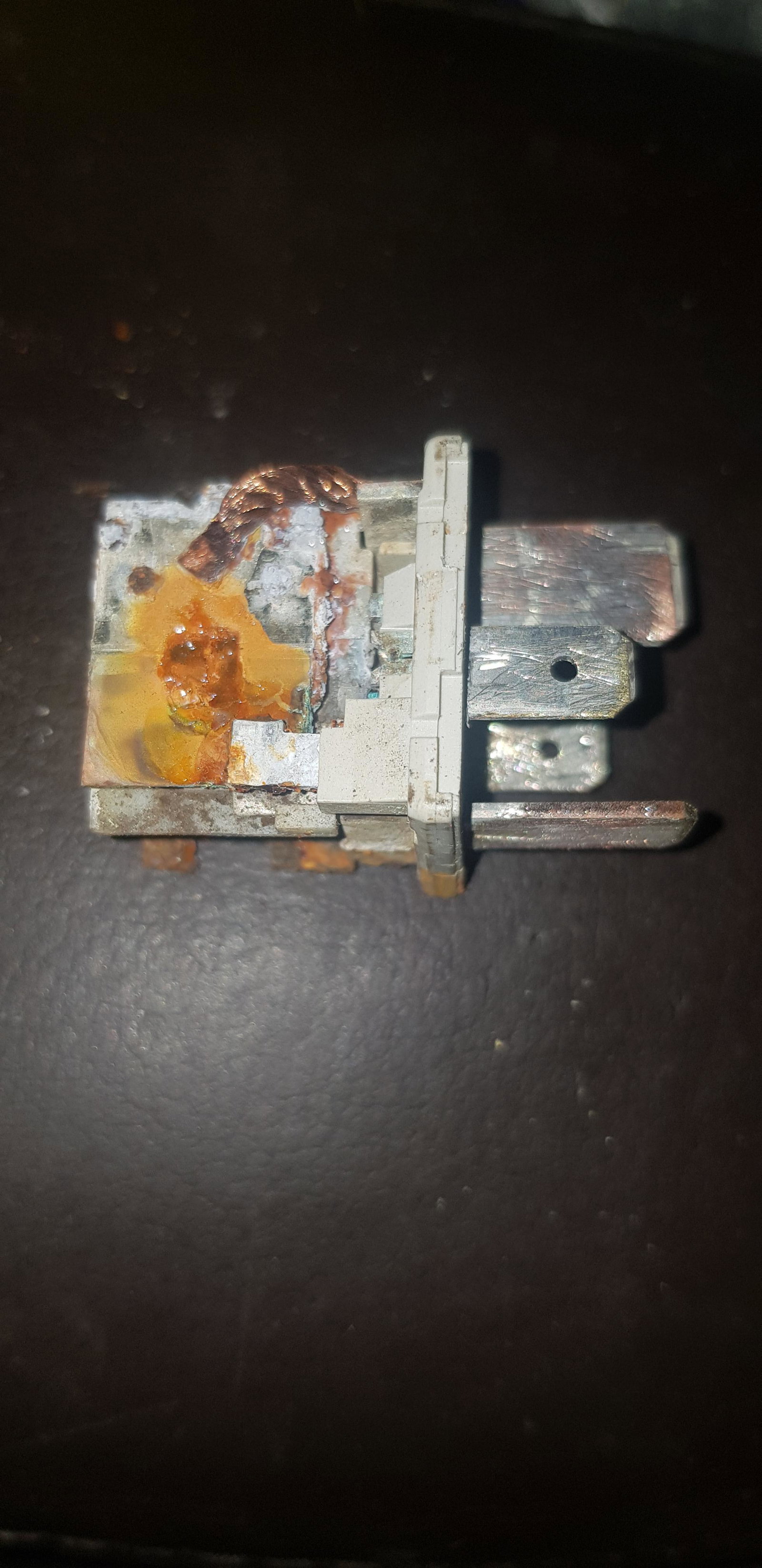

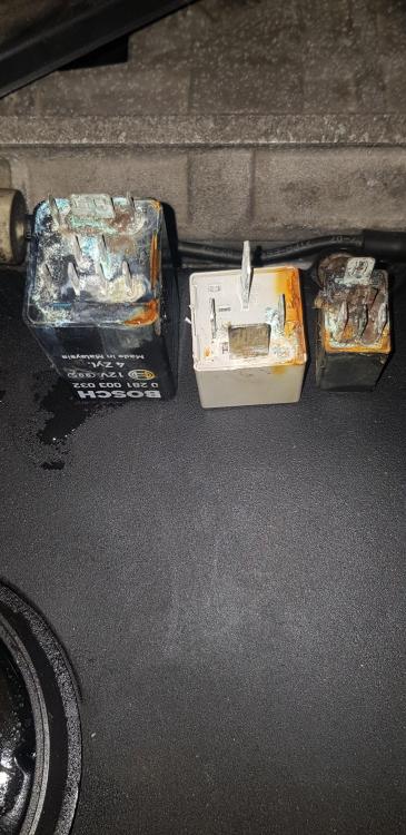

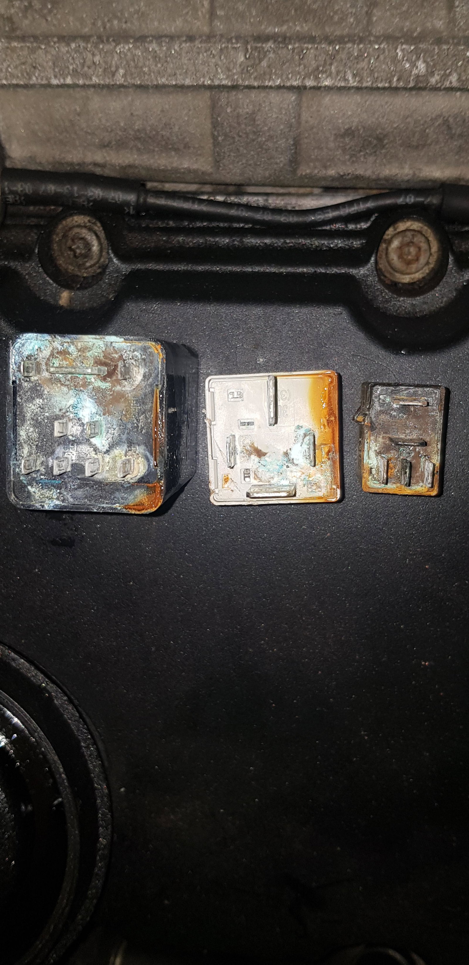

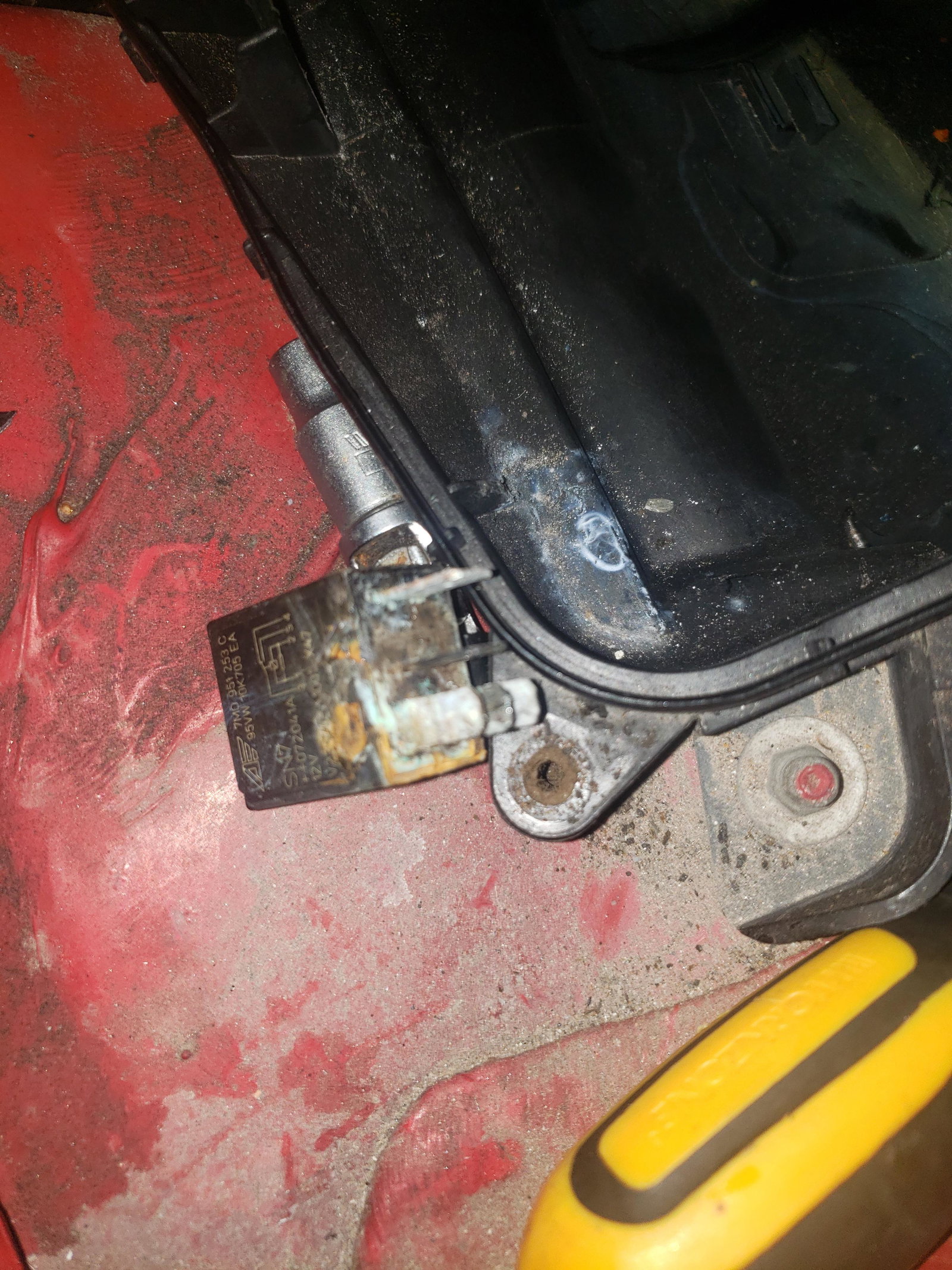

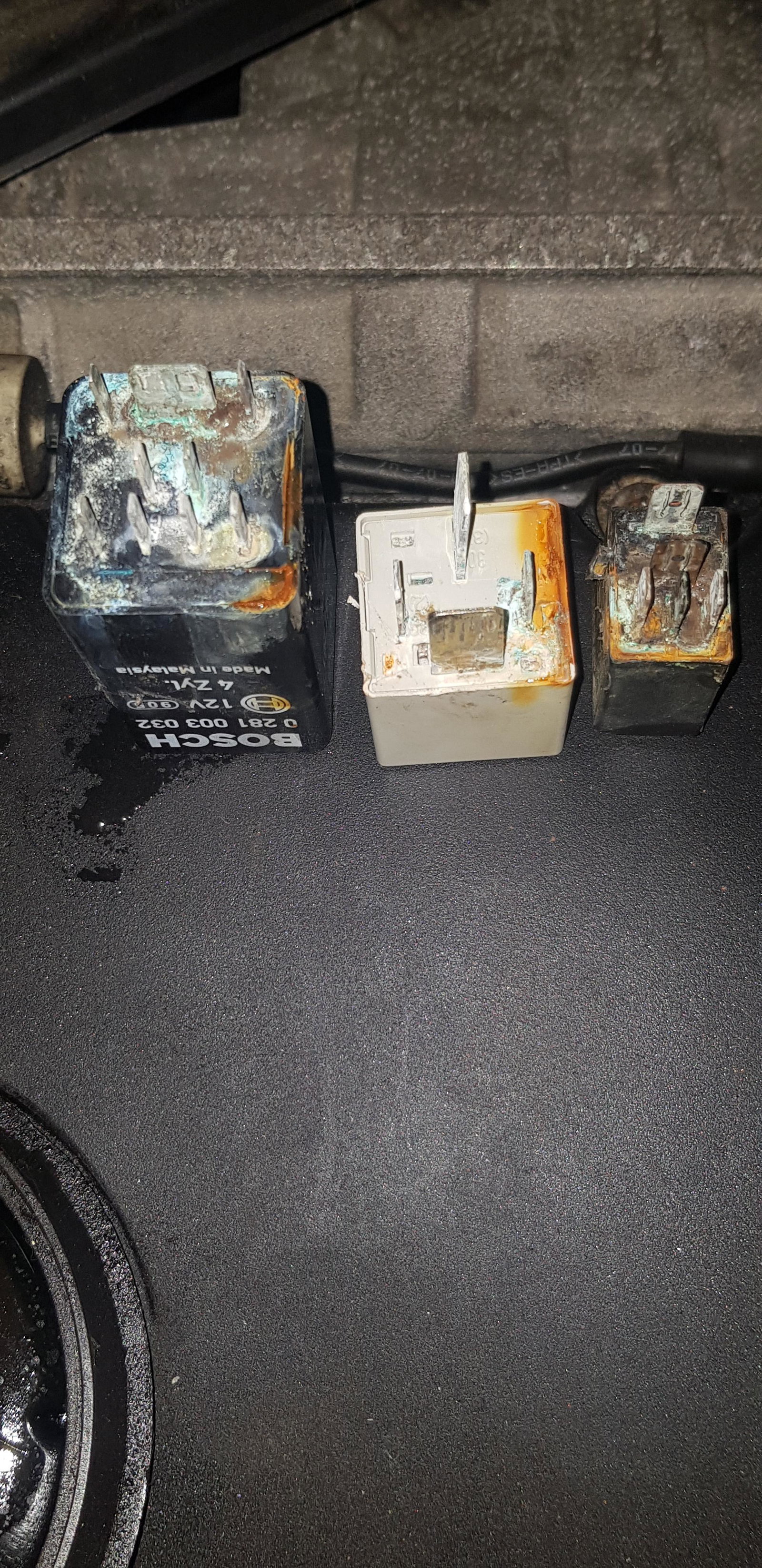

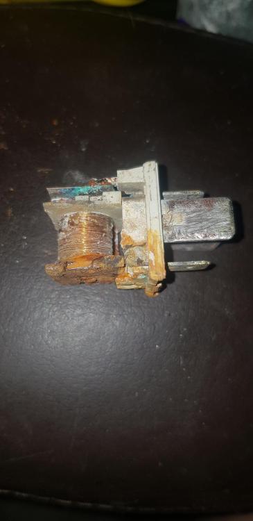

commonasmuckjohnsmif Posted December 6, 2021 Posted December 6, 2021 Hi any help would be very much appreciated I have a similar issue with my A4 B7 170ps Black Edition with the BRD engine the code showing in mine is L3 1-2 the problem started with a possible engine management light coming on & sometimes being sluggish up some slight gradients 2 day it finally gave up, stalled & took ages to start again then 300 metres down the road she died I called RAC out I ended up telling him to leave after I watched him pour diesel out on to the tarmac so she went to be looked at eventually I was told no communication between the fault code reader & ecu so the ecu is at fault a while later I enquire have we any news? Oh the key has gone missing so eventually I got her back minus the key I got a replacement key & an ecu both matching to my car an AQ ecu & 433mhz key I dropped them off & asked again a few weeks later no nothing after 5 months I got the car returned after in 5 days I've found out more than him in 5 months that my relays in the ecu box have been submerged in water I've cleaned the plug contacts up & I've got new relays but the code L3 1-2 is showing
Steve Q Posted December 6, 2021 Posted December 6, 2021 You can try and dry it out but more often than not the components that have got wet will need replacing. Im in a similar situation with my c5 as I need a new ccm after it got wet. It's dried out best it could but I've got intermittent central locking issues etc.

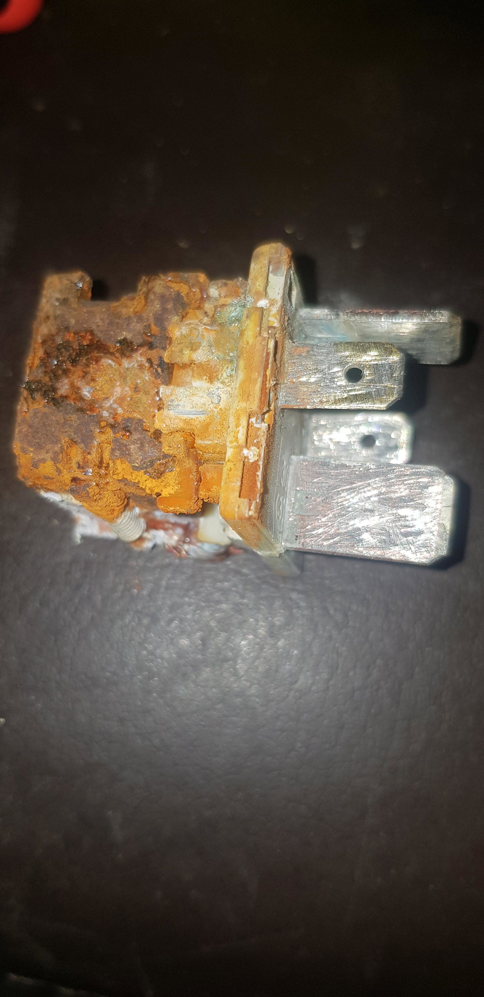

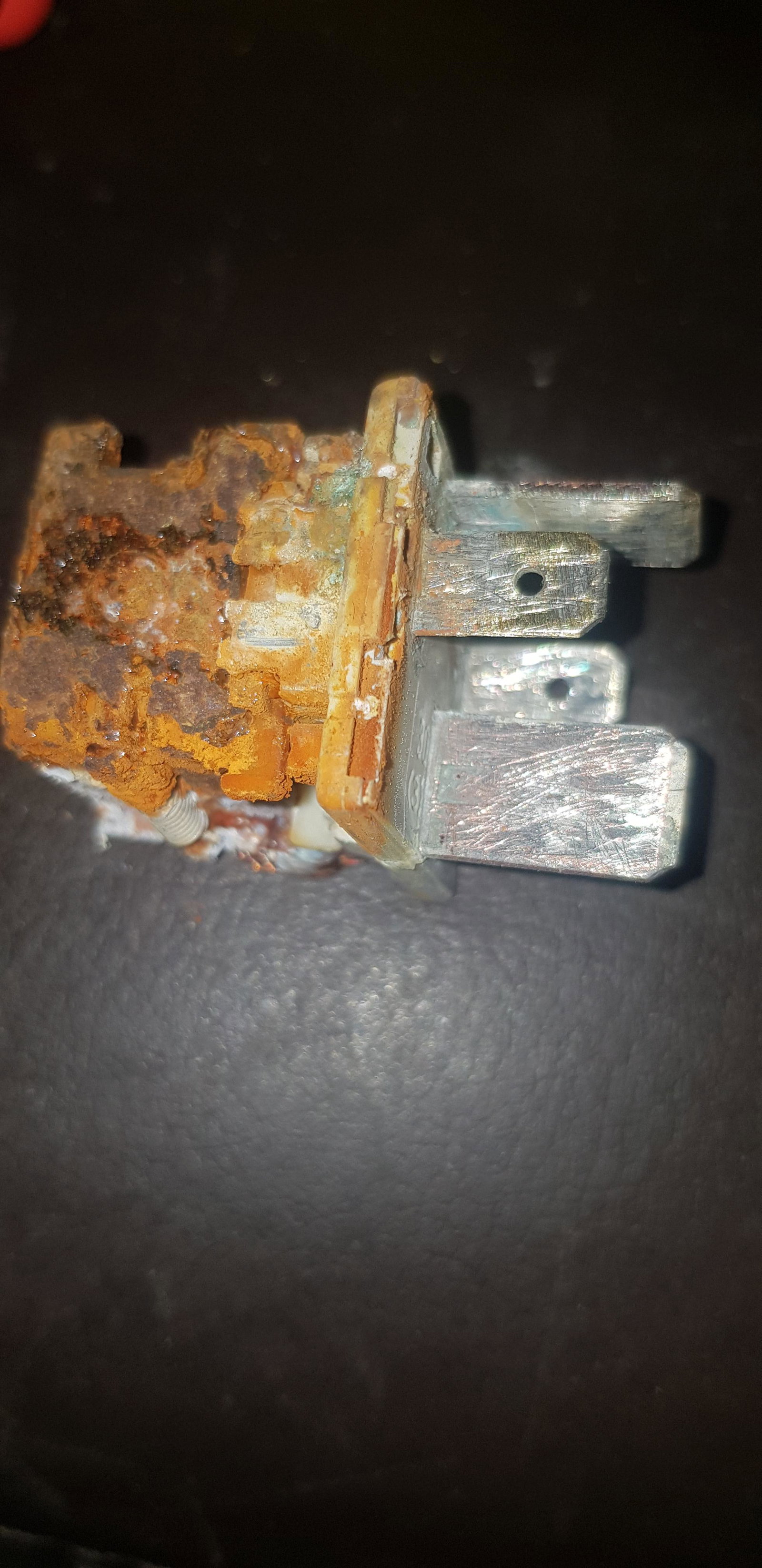

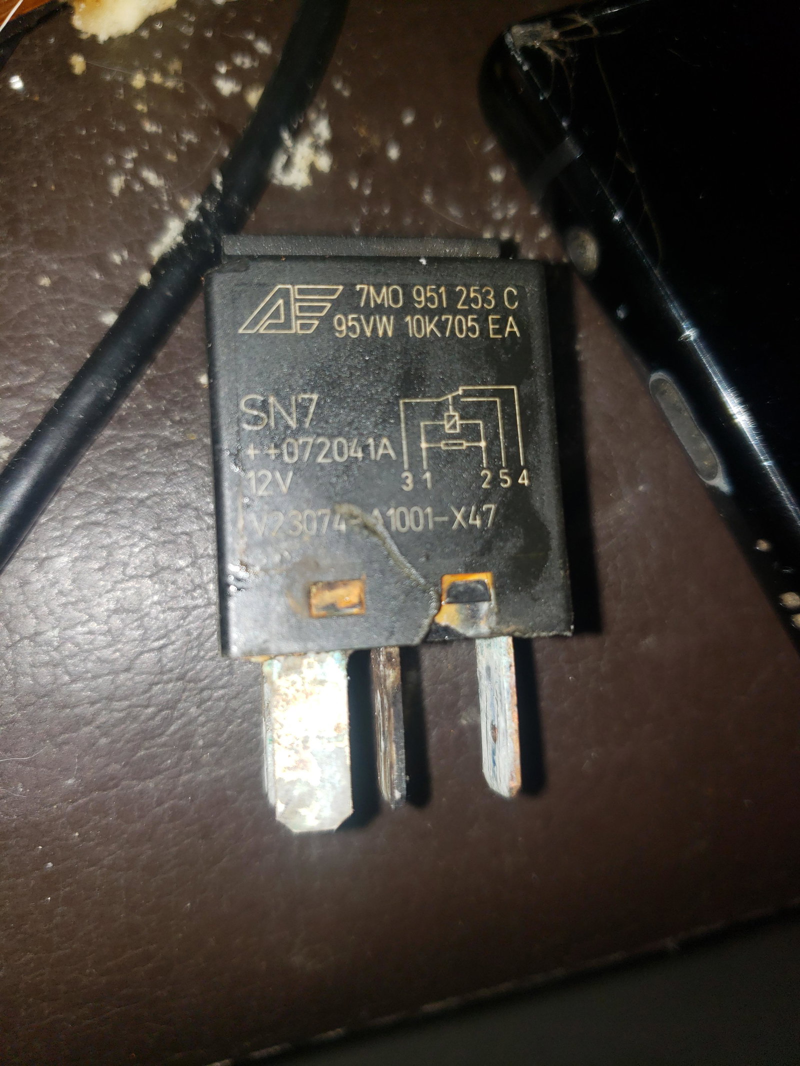

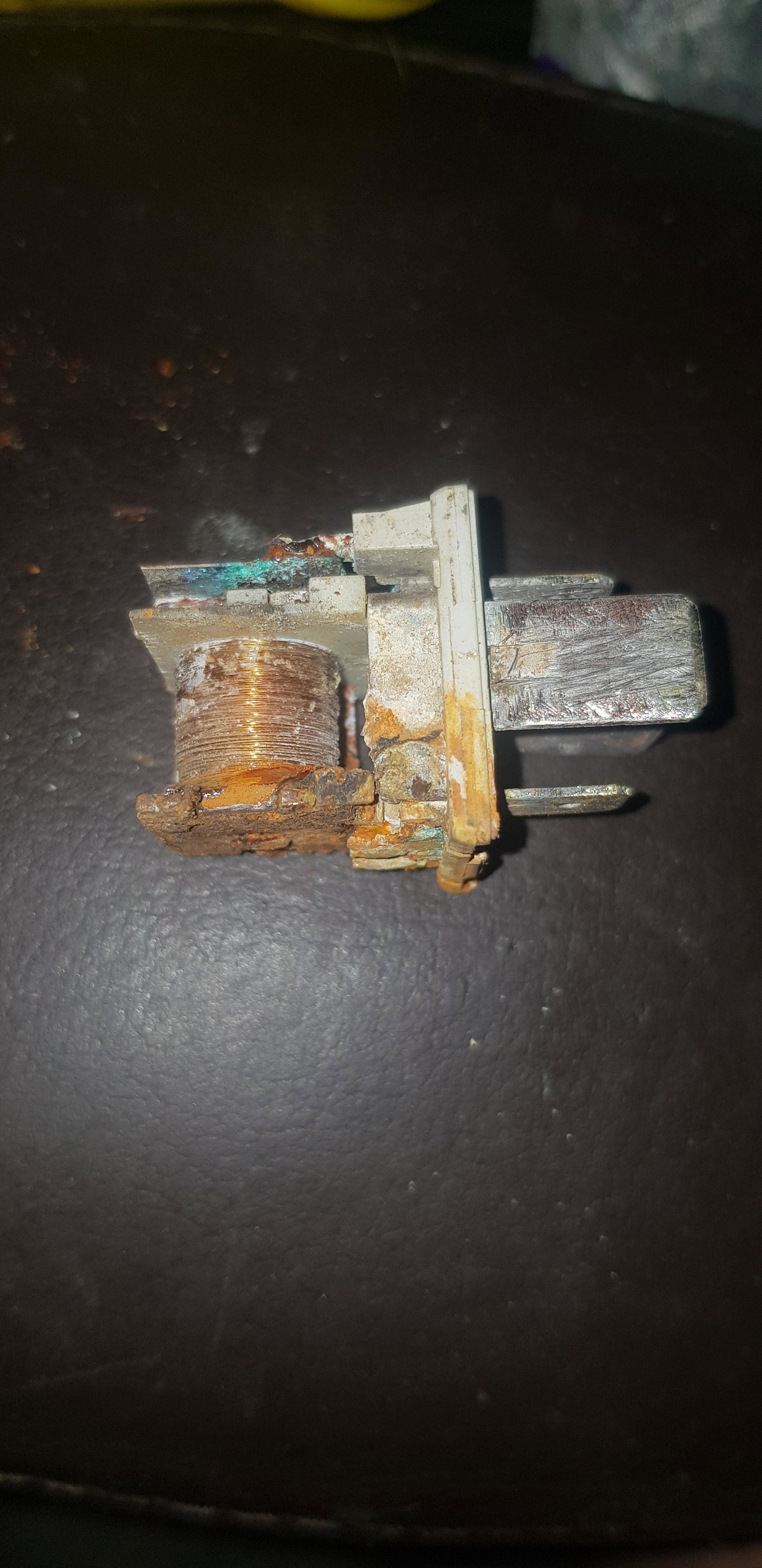

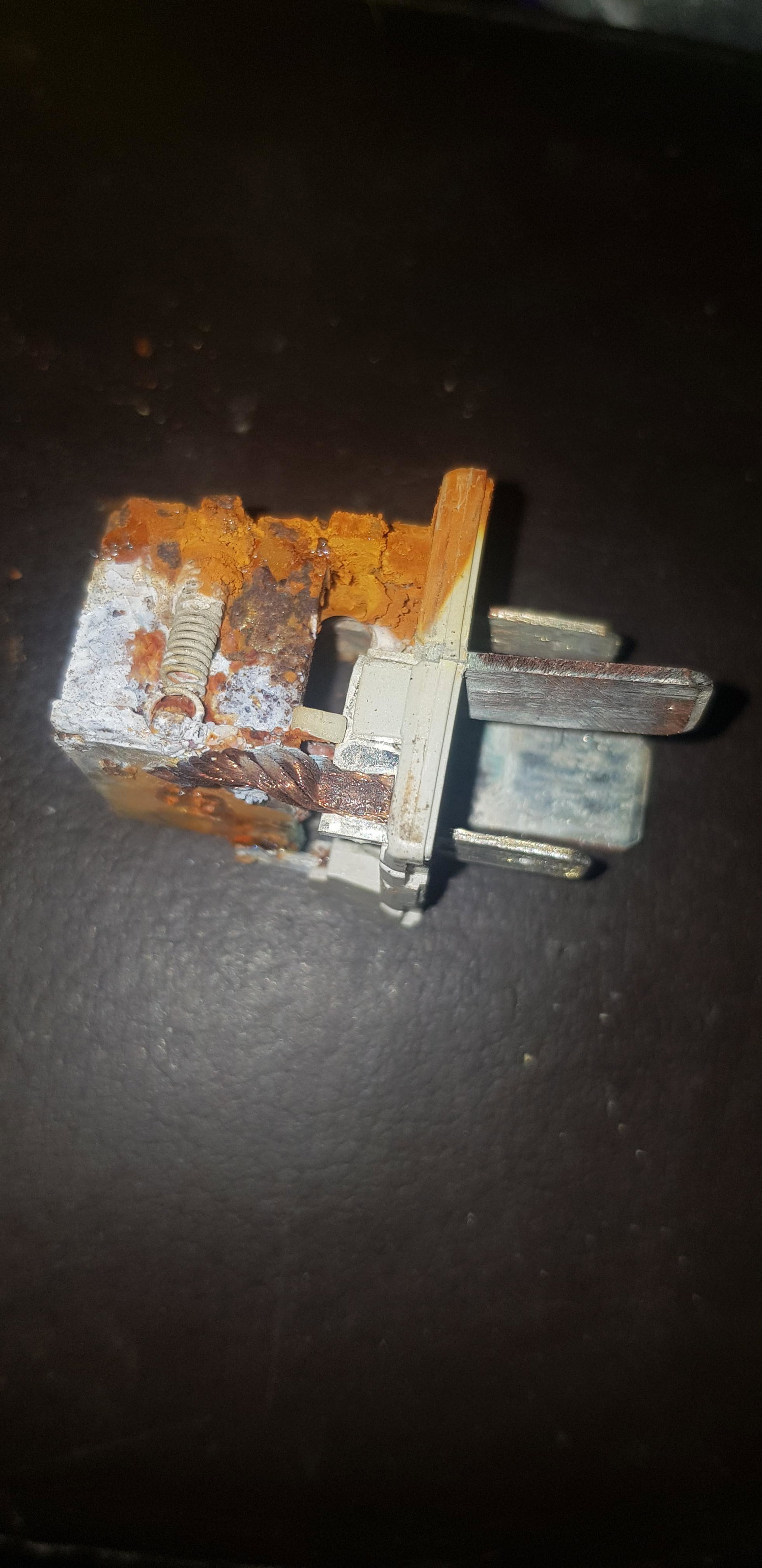

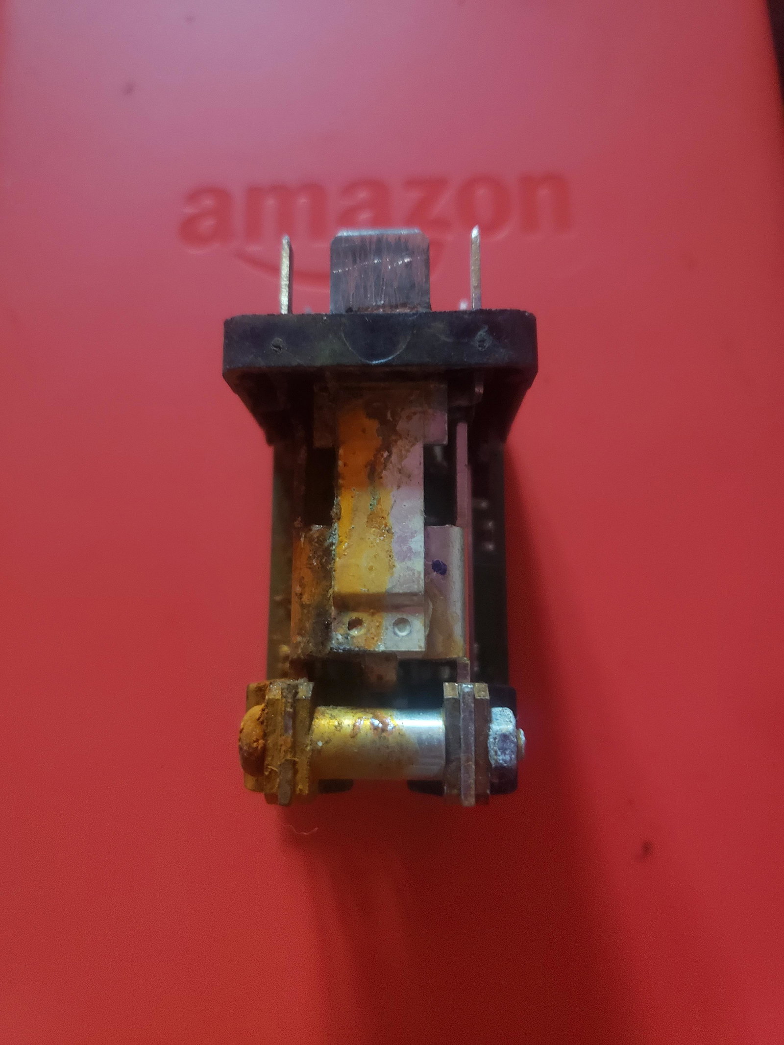

commonasmuckjohnsmif Posted December 6, 2021 Author Posted December 6, 2021 Yes thanks I've dried it all out & made a temporary 'umbrella' to go over the top of the ecu lid & I've already fitted 2 brand new relays & the 3rd is the expensive 1 that didn't suffer like the other 2 they were absolutely beyond it I've done continuity tests on the relay plugs I remember now when I had purchased an oem key from volkservice in Blackpool when they were coding the new key there was a code on the dash very similar to the 1 on my dash
Steve Q Posted December 6, 2021 Posted December 6, 2021 If you changed the relays and that's not fixed it then either the housing for the relsys or wiring further along will.need changing in my opinion.
commonasmuckjohnsmif Posted December 7, 2021 Author Posted December 7, 2021 The wiring loom is ok I've done a continuity test on that I'm just waiting to see if a fault code reader picks up the ecu now & as well vag com is saying anything else it didn't help with the place I thought would have been ok doing the work but he lost the key & after 5 months of seeing nothing much being done I got the car back finding more out myself than he did

commonasmuckjohnsmif Posted December 12, 2021 Author Posted December 12, 2021 On 12/8/2021 at 12:53 AM, Steve Q said: Totally agree, it's trying to find trusted garages a d once you find one you stick with it. Sounds like the quality of their work has gone down hill in this case. Thanks very much to those that suggested solutions to my problem & a special big shout out to Steve Q it's not who I knew it's what I knew after cleaning up my relay plug contacts & 2 relays posted from Autodoc online from Germany the 3rd I managed to clean up I found the coded spare basic blade key which stopped the alarm from sounding (the 3 button original was lost by redman autos Poulton Le Fylde) the dash code L3 1-2 was for the key that wasn't coded so the correct key in the ignition, the fuel filter now filled with fuel there was a sound I remembered from a while ago after almost 9 months she's running again this clip wasn't a cold start but thanks for all the help 20211211_185914.mp4
