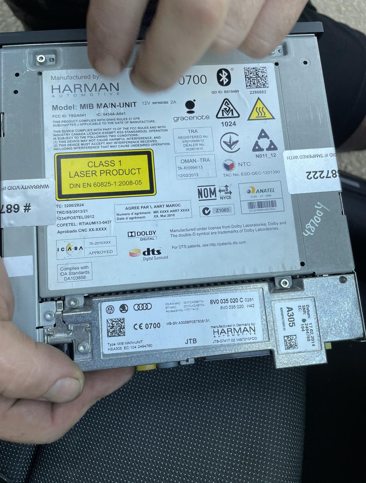

YpowT Posted December 20, 2021 Posted December 20, 2021 Hi all, TL:DR; Having a reoccurring issue with my ‘14 A3 (8V) stereo system. Ideally don’t want to sell, but investigation by multiple garages and a private remote ex-Audi master technician has not provided a permanent solution. Don’t want to go directly to Audi as expect them to tell me a new MMI box required (~£3k). Inclined to ditch it to a car buying company, even though the car is mechanically sound. Longer version 6 months or so ago I got in my car one day and started it up to discover I’d lost all sound output. This was a day or two after I’d just done a long distance journey where it was working perfectly normal. The MMI screen, centre console controls, car menu, radio options etc. all still worked, but there was just no sound output from any of the speakers. On a couple of trips after this discovery, it came back to mid journey until I turned off the ignition. Upon restarting it was back to no sound. Went to a couple of Audi “specialist” garages to investigate (one of which managed to reset my MMI and wipe my Sat Nav…), neither managed to find a root cause as there was no error / fault codes coming up during any diagnosis they did. Ended up being pointed towards an ex-Audi master tech who now works privately as remote mechanic, who has been very helpful so far. He managed to find a ECU (?) company (apparently one of a small number in the UK who could repair the MMI box I have) to take a look at it. They assessed it and ended up replacing some “amp chips” on the main PCB, before returning it (~£550 in the end). When refitted, it seems to fix the issue and everything was back to normal. That was until about a month later when the same issue dematerialised. It was under warranty and such was sent back to reassess. Since then, it has been back twice to be repaired i.e 3 times in total (second time they mentioned a specific part of the board was causing the amps to break). Since the last fix - it was again working fine until a slightly different issue arose. This time, lost sound in the front drivers side door / dash speakers, but all other speakers were fine. I double checked the mixer / fader in the sound settings to make sure something hadn’t been messed up there, but it was bang right in the middle where it needed to be. Company are offering to take a look at it - but again discussing it with the master tech, who is acting as the middle man, he agreed that we can’t just keep going back and forth - and if I wanted he would refund me what I paid and reclaim his cost from the company. I offered to get it looked at one more time - and then in the event they could repair it - look to ditch it with Motorway or similar, as would not feel comfortable selling privately on the basis I know it may break again. The other suggestion was to try and get a second hand MMI box to see if that fixes the issue, but again that’ll be ~£500 (if I can find one) on eBay, and there is no guarantee that it’ll work OR it won’t break in the same way - hence that will again be dead money. Issue is - I like the car, I’ve not long had the cam belt replaced and ideally I’d keep it (especially given the used car market is so high at the moment), but I don’t want a car without a working stereo. Having researched early on and spoken to a few family / friends (one of which is a mechanic), I suggested a few things to those I’d spoken to throughout the process, based on what I found / was told, such as: Checking the wiring in the door harnesses Checking the alternator was working properly and not causing a surge Inspecting the boot (albeit I don’t have the BOSE system so didn’t think there is anything there). The guy I’ve been dealing with has been great throughout, but I’m close to throwing up the white flag and taking the financial hit (albeit it I’ve been quoted £11k which is only £1k less then I paid for it 2 or so years ago), but this is a last ditch attempt to see if there is anyone has any other ideas or suggestions for where I could take it to be properly investigated (other than Audi directly). Any guidance or thoughts would be greatly appreciated. Thanks Jon

YpowT Posted October 14, 2022 Author Posted October 14, 2022 1 hour ago, SFIRTH said: Hi YpowT, Did you manage to solve this problem as I have exactly the same issue with my 2014 A3 Cabriolet. My Audi main dealer wants £165 + vat per hour to diagnose the fault. Hi SFIRTH. I did in the end! As I mentioned in my previous post I was working with a private ex-Audi master tech / mobile mechanic, and he managed to find a company to take a look at it who ultimately fixed it. I believe it was Hazzy Days, would suggest giving them a try directly. https://www.hazzydayz.com/ Essentially, mine went back and forth a few times to repair blown amp chips two-three times, but the same reoccurring issue kept blowing them, hence concluded it wasn’t just the chips. Eventually it went back again and they had a senior engineer look at it, and while I can’t remember the exact reason, it sounded like that there was some unwanted contact with the top of the MMI metal case and the PCB which was causing the issue? Not sure exactly what they did, but my understanding was it wasn’t something they’d ever come across before, hence they took a note for future repairs. I am making an assumption that you have the exact same MMI unit as me, but even if not I’d recommend trying them anyway. 2
