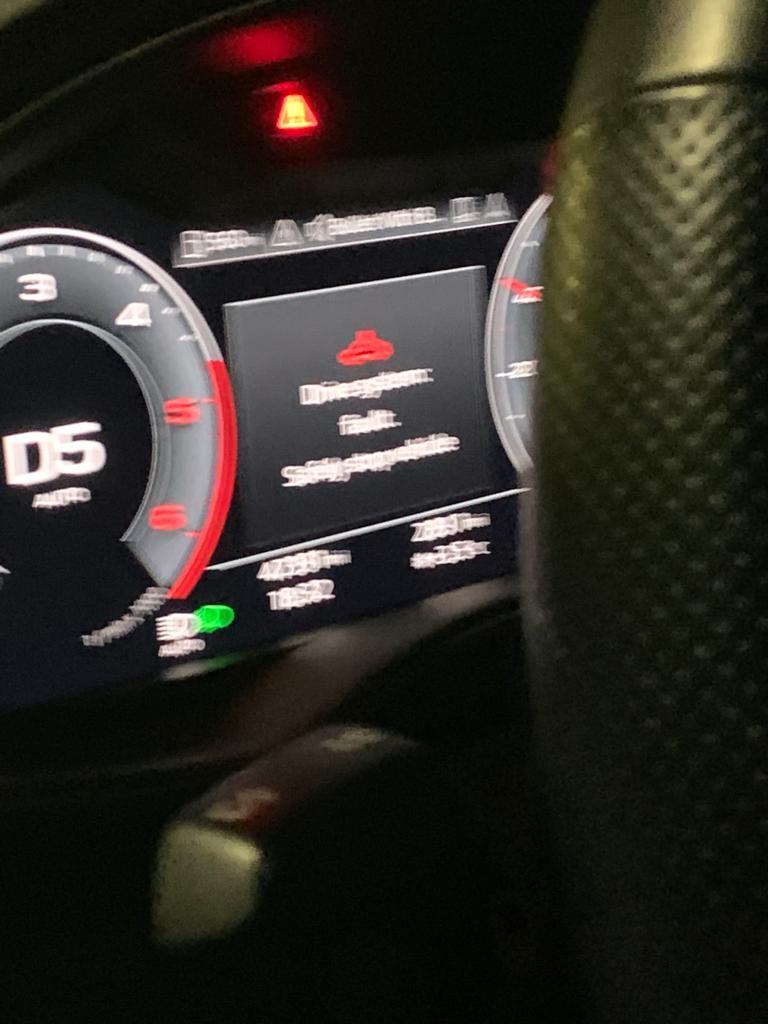

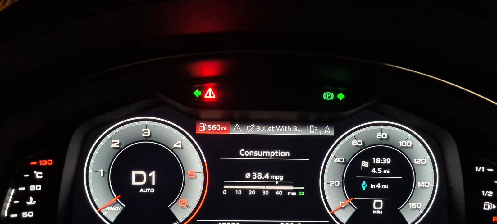

Gordano Posted January 8, 2022 Posted January 8, 2022 Hi, had this warning up 3 times, any words on this before it goes back to dealer. System warning no power at all. 40 tdi s line 2019
Steve Q Posted January 8, 2022 Posted January 8, 2022 As I suspect the car is still under warranty I'd be taking it back to main dealer pronto. As fault codes will be stored on the ecu. The fact it's red would imply it's more of a concern. As a yellow warning says to contact your local dealer. Sorry I can't help more but with the a3 8v a similar issue was down to a faulty fuel pump. And on the a4 b9 it was down to various issues. 1

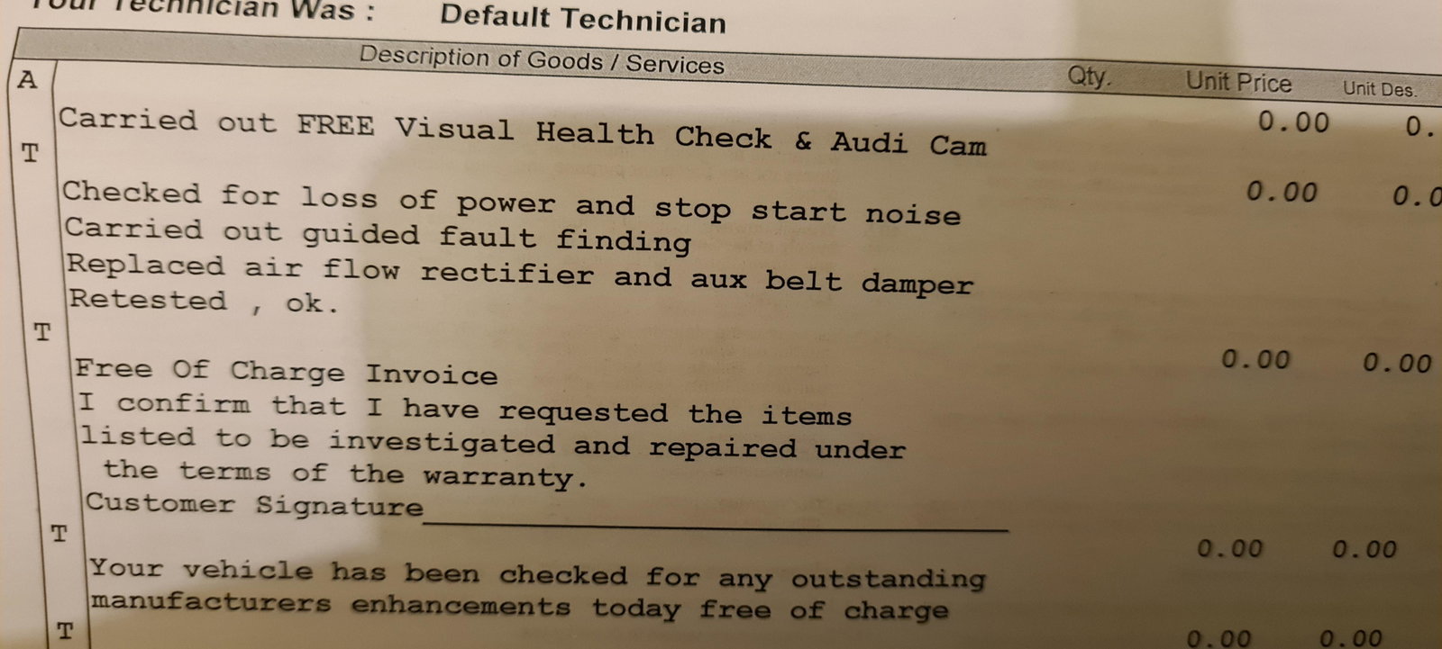

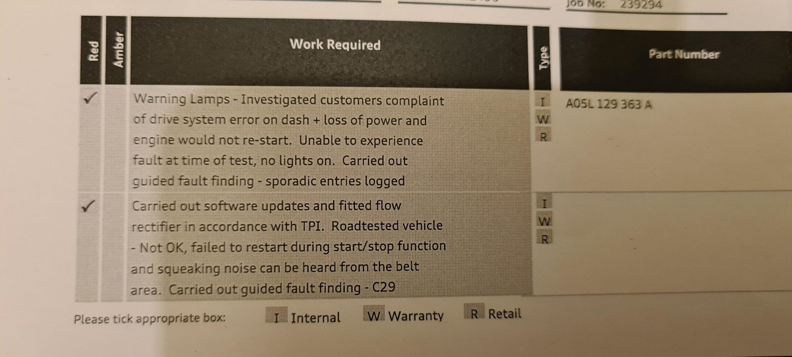

Gordano Posted January 20, 2022 Author Posted January 20, 2022 33 minutes ago, Magnet said: Thanks Tim, but has the fault - non start issue now been resolved? I guess it must have been, but I’m having difficulty in trying to interpret why the subsequent non- start bit and the resolution of that, but it could be me missing something. Kind regards, Gareth. Hi, yes all working now. The problem was stop start at stand still and I guess the same system puts the car into coast mode when driving. That was when driving is when the warning came up. 3

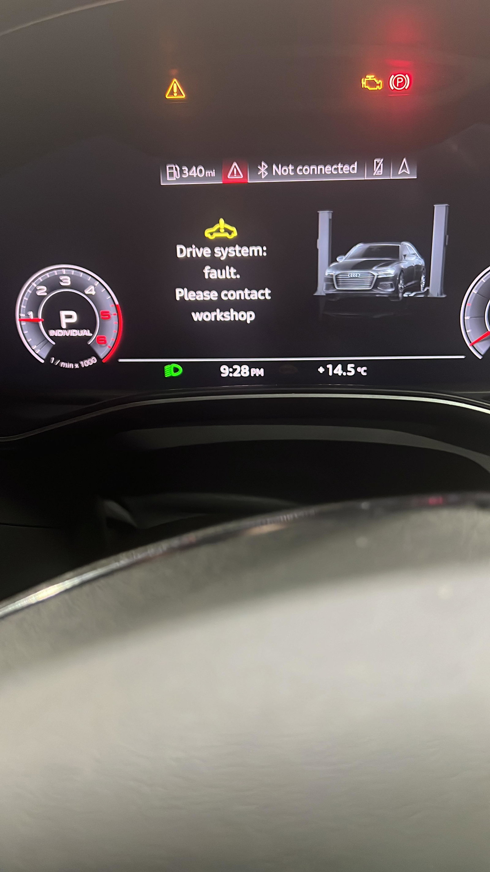

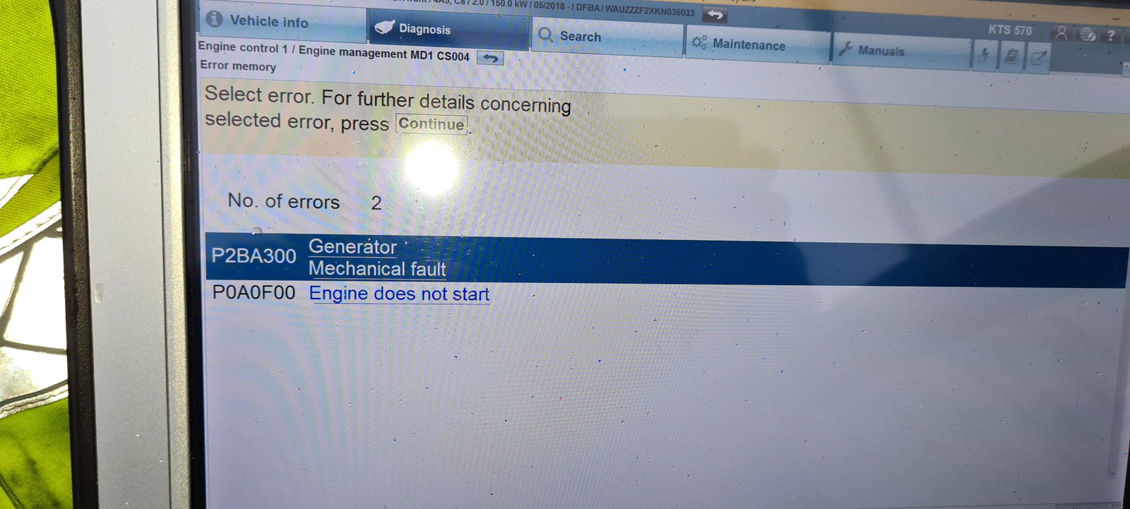

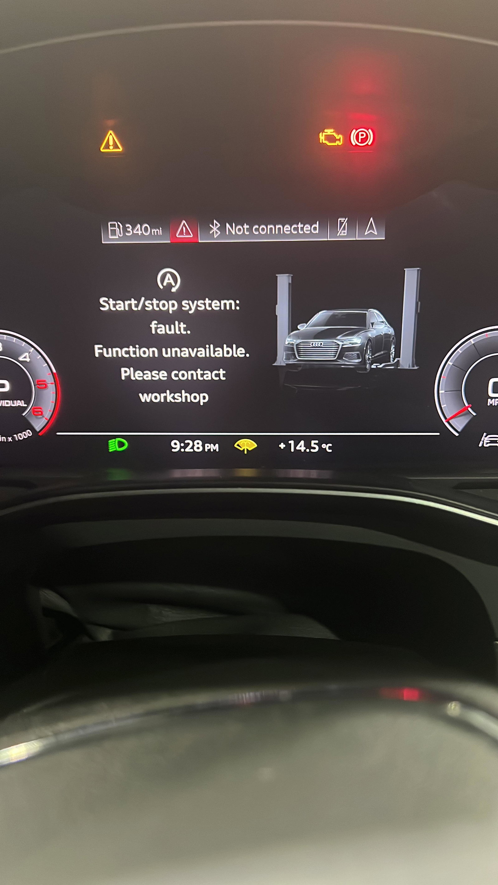

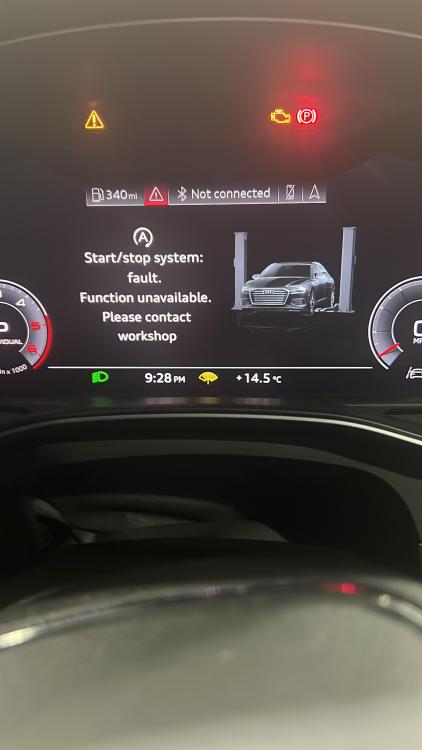

AudiA62019 Posted November 2, 2023 Posted November 2, 2023 Hi guys this is my first posts so I hope I’m doing it right ! A few weeks ago I got the start stop fault contact work shop followed by drive system fault contact work shop my car was booked in with Audi an is still with Audi an it is approaching nearly one week with them I hadn’t loss any power or anything car was driving as normal no extra sounds or any problem with therostat gauge only had the two fault codes… anyway Audi had said my cambelt had jumped an under the warranty it was replaced now they said after changing the cambelt that the signs still remained an they are now saying it’s needs injectors… I shall find out tomo if this fixes the problem but I am slowly getting worried after searching the forums that these issues can be a combination of a lot of things has any one else had the dealer fix’s these problem with Audi please reply to this

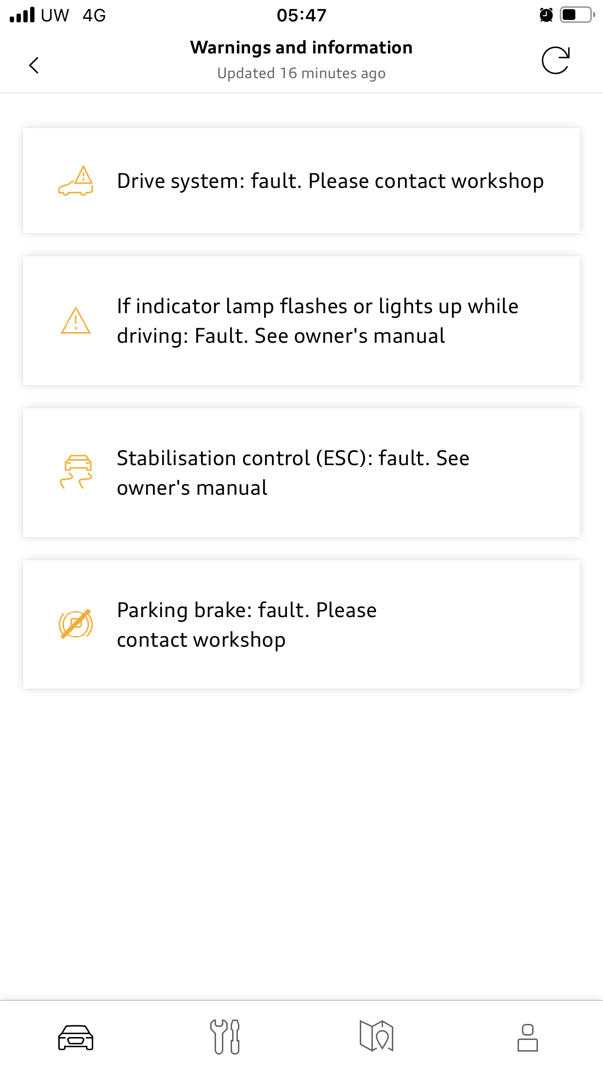

David Hirst Posted November 11, 2023 Posted November 11, 2023 Hi how did you go on with your issues?got a similar problem with my A6 40 2019 , it’s booked in with Audi on the 21st , I had my battery (in boot of vehicle) replaced by RAC a year ago car has been perfect up until end of October when I came to start it fired up straight away and as I moved off came with various warnings , got told could be alternatir and charging issues?? Below picture from my Audi app
Magnet Posted November 11, 2023 Posted November 11, 2023 Welcome to the Audi Owners Club ! Good to have you onboard. Hello David, So are you going to get the alternator output checked, and the battery efficiency tested ( once charged)? Halfords should be able to do that at one of their shops pre. your book-in. This could save you a considerable amount of money. Make of battery - as a matter of interest? Kind regards, Gareth.
David Hirst Posted November 11, 2023 Posted November 11, 2023 Cheers pal will get it booked in with Halfords straight away thanks for the quick response 👍

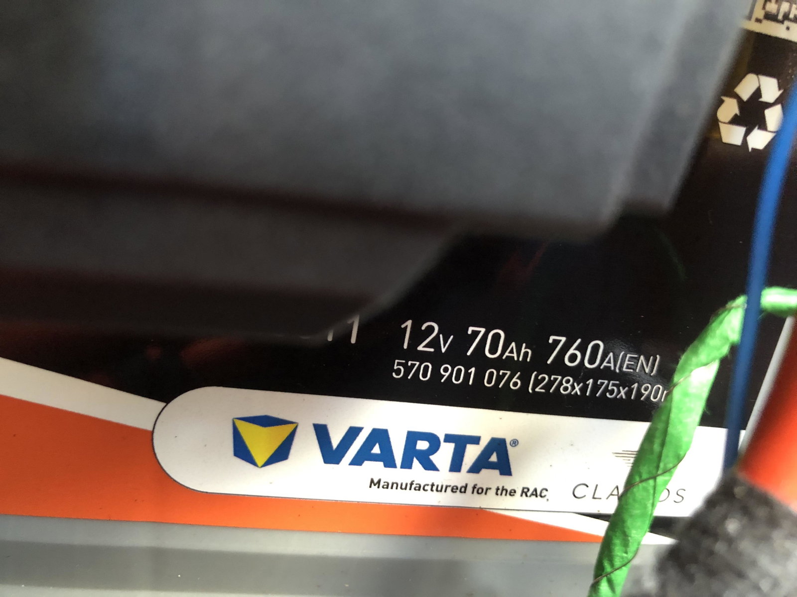

David Hirst Posted November 11, 2023 Posted November 11, 2023 The Battery was replaced by RAC last November and it’s a Varta, been to a local independant vw/ Audi garage who have suggested it’s the wrong battery ! Called RAC back anc they will only change it if it’s below a certain voltage which it’s not so I was advised to go to Audi ?

Magnet Posted November 11, 2023 Posted November 11, 2023 Thanks David, Last thing first - no disrespects, if you are asking how/where to charge a battery, then just close the bonnet before you engage in anything you wish you hadn’t started! Just don’t attempt it. Apologies for questions:- Can we take it your vehicle is equipped with stop start? If so, does the battery say anything like AGM or stop/start, S/S on it anywhere? Do you know if the RAC or anyone else coded the new battery to your vehicle? You shouldn’t (and I wouldn’t anyway) book the car into Halfords (Autocentre). Their retail shops should be able to check battery efficiency on a walk-in arrangement. Varta is a prime make of battery. Made for RAC suggests it could be manufactured down to a price -? RAC and warranty. There is far more to a battery’s efficiency than simply voltage. Let us know how you get on with getting it checked. Kind regards, Gareth.

Magnet Posted November 12, 2023 Posted November 12, 2023 Thanks David, If it isn’t marked AGM or S/S then it’s likely to be the wrong battery, so it now becomes important that Halfords not only checks the battery efficiency - inc. the cold cranking current - but that the battery is the correct type and size for the vehicle. Let’s hope it is. If it isn’t, then any warranty claim against the RAC, would not be simply the battery efficiency, but whether they fitted the right type. If it were mine, I would simply be noting whatever Halfords tells you - asking them to write it down for you would be great - but I wouldn’t be entertaining purchasing a replacement at this stage - if all isn’t well in terms of type or efficiency. Just let us know how you get on. Don’t forget to ask them to check the alternator output as well. Kind regards, Gareth.

David Hirst Posted November 13, 2023 Posted November 13, 2023 Went to Halfords (approx 1.5 mile away) and got them to check battery,engine not warmed up and showing just 1bar lit on temp gauge , battery showed less than 12.5 volts, and 570 start power from 760 , official battery is AGM096 (less than (£200) at Halfords, Phoned Audi at Wakefield to confirm battery but all they would tell me is the official battery is £316 and it has 390 amps, gone onto eBay and even on there the proper batteries are over £300 ! Halfords did say the Battery was faulty so I suppose my next option is to speak to the RAC and explain the situation??
David Hirst Posted November 13, 2023 Posted November 13, 2023 Meant to say the varta battery that the rac put in is AGM096 but like the guys at the garage pointed out is how long has the battery been in that van and also not an oem battery so will see what RAC say 🤞🤞
Magnet Posted November 13, 2023 Posted November 13, 2023 Thanks David, Situation as we now know it:- RAC fitted the correct battery type. It has now been checked and found to be below par. RAC fitted this battery about a year ago, but we need to be specific, since it might only have had a 1 year guarantee via. the RAC. Being pessimistic, if it’s slightly over a year old, then they may claim it’s simply out of warranty, despite batteries normally having more than 1 year warranties. We know this battery is graded ‘Manufactured for the RAC’ and this maybe a lower than normal graded battery. Any success with a warranty claim will depend more on a determined and constructed approach, rather than ‘will see what RAC say’. Not sure where you are looking on eBay, but it really surprises me that a AGM 096 is over £300, compared with Halfords sub £200. Have a look at Tayna Battery website and give them your registration number. They are likely to quote you for their own Enduroline brand - which is likely to be dearer than the premium Exide ( which is my current go-for brand - I used to prefer Varta/Bosch). If you then go on eBay and search their shop, you should come up with the correct Exide equivalent, but beware they offer the cheaper Excel grade, and the better ‘Premium’ grade, which I go for. They were offering an eBay discount of 8% via. code SAVES8, so even cheaper! Just a personal opinion, but you could consider forgetting about the RAC and their warranty, and just biting the bullet and buy a new battery. Let us know what you think. Kind regards, Gareth. p.s. Alternator output?
