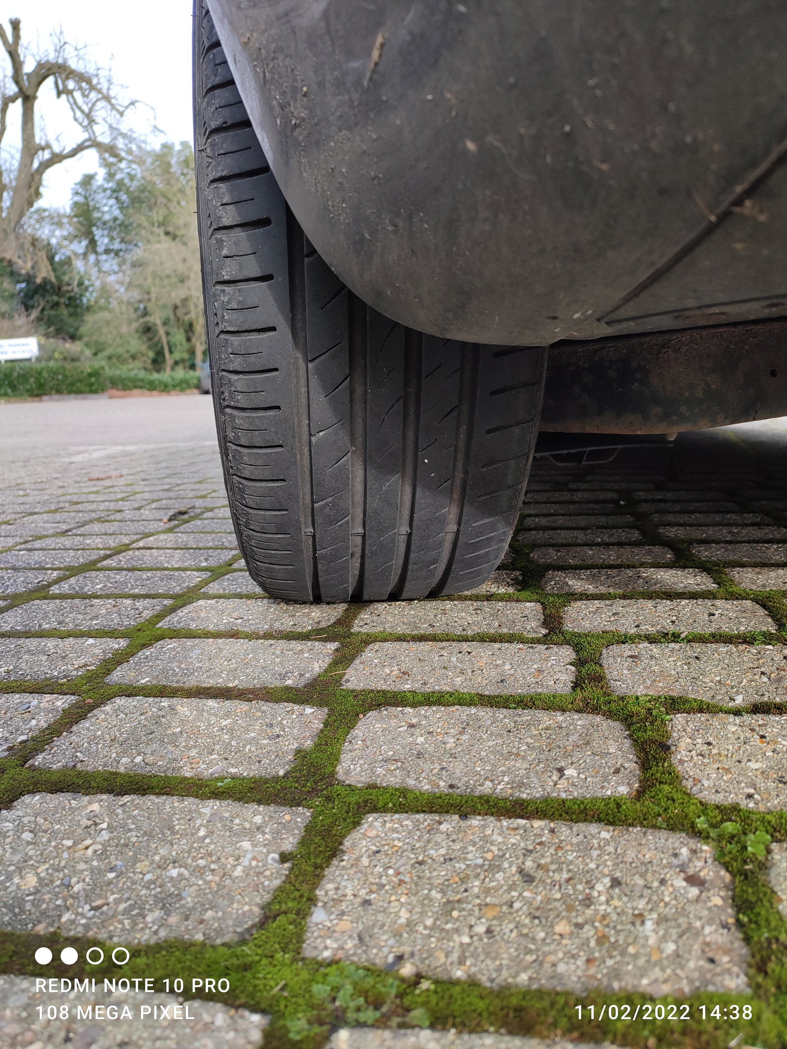

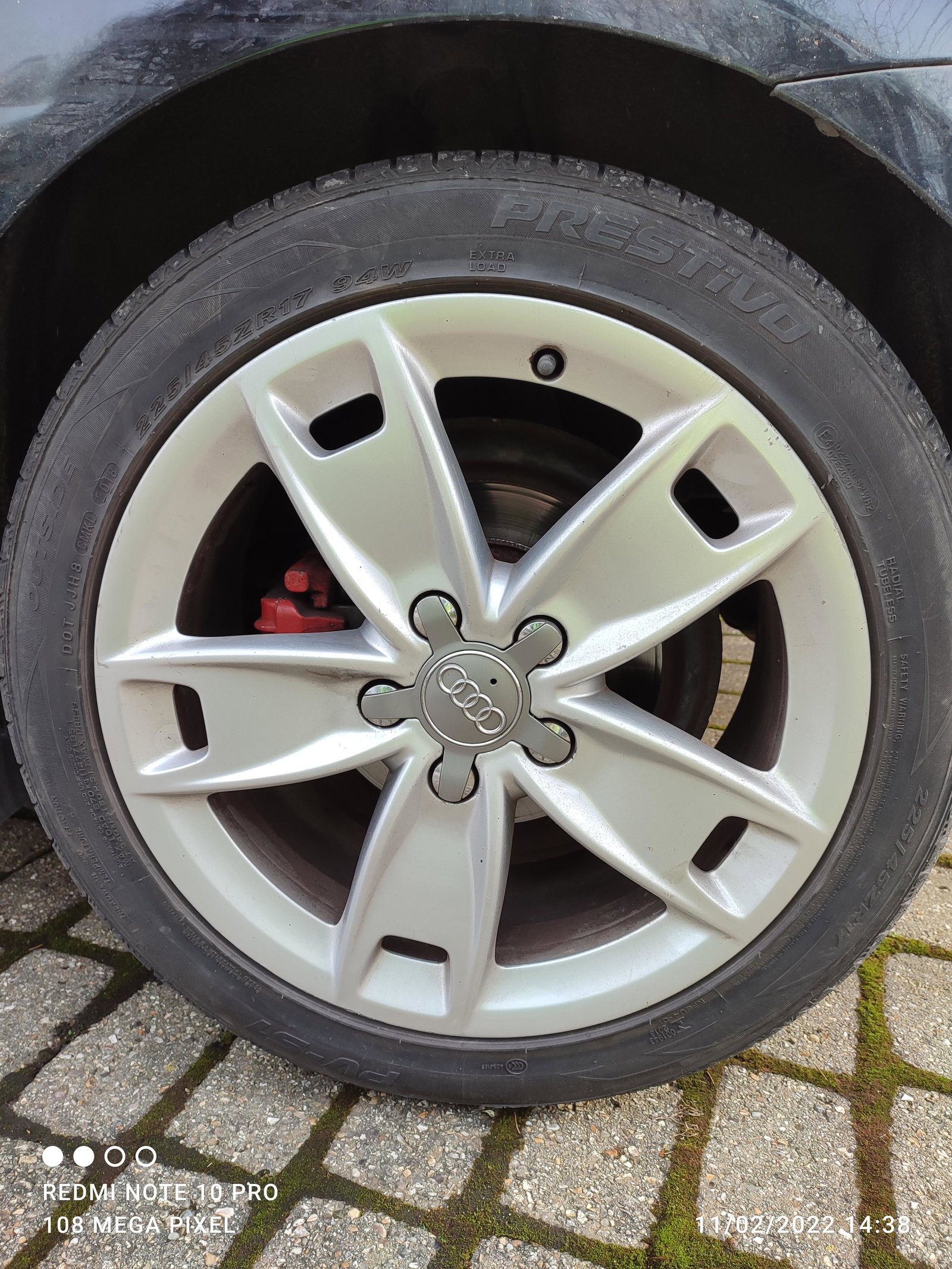

A3car19tdi Posted February 11, 2022 Author Share Posted February 11, 2022 (edited) Here is the tyre image. The tyres were already on the car when I had it. Edited February 11, 2022 by A3car19tdi Extra picture Quote Link to comment Share on other sites More sharing options...

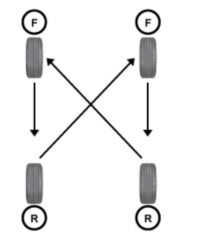

JMKC82 Posted February 11, 2022 Share Posted February 11, 2022 those tyres look fine. But if you wanted to rotate them, do this. I assume they are uni-directional. Quote Link to comment Share on other sites More sharing options...
A3car19tdi Posted February 11, 2022 Author Share Posted February 11, 2022 Yes they are normal. Nothing states they are directional. I could try rotating them. It's just strange. I can detect the sound at slow speeds even 10 mph but it's quite a change crossing onto a very smooth surface at 20/30/40mph. It almost virtually dissapears then. Cross Back on to a rough tarmac and it starts howling away. Quote Link to comment Share on other sites More sharing options...
Stevey Y Posted February 11, 2022 Share Posted February 11, 2022 2 hours ago, A3car19tdi said: Yes they are normal. Nothing states they are directional. I could try rotating them. It's just strange. I can detect the sound at slow speeds even 10 mph but it's quite a change crossing onto a very smooth surface at 20/30/40mph. It almost virtually dissapears then. Cross Back on to a rough tarmac and it starts howling away. Hi Budget tyre won't help, Prestivo is not one I have ever heard of, example being as a cab I use a lot of rubber in a good year so went to my local tyre supplier for new fronts, as he didn't have my usual Nexen tyres in my size he asked me to trial these new tyres he was thinking of selling called Stomil, ok I said, as soon as I reached the first roundabout all hell broke loose and it sounded like both front bearings had collapsed so I took it back and gave him a test drive, he wasn't impressed so he fitted the only other tyres he had in that size Semprit which were dearer but wouldn't take the difference in the price, these were about as quite as you can get with a 68db noise rating and peace was restored, there are so many mid range good tyres out there, Next ,Debica, Roadstone, Mid range is as low as I go. Steve. Quote Link to comment Share on other sites More sharing options...
