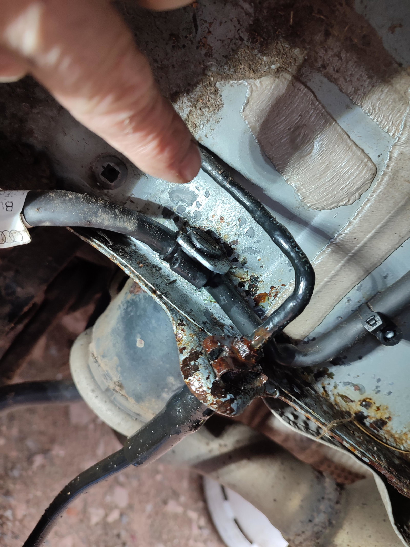

Simon france Posted January 27, 2022 Share Posted January 27, 2022 Got a leaking rear brake pipe just before the flexible one, can you cut off the bad bit (corrosion) and splice a new bit of pipe and connector for the flexible pipe? Garage said I would have to replace entire pipe, ridiculous as it goes from back brake all the way to abs unit (I e just taken all covers off underneath to check)any thanks Quote Link to comment Share on other sites More sharing options...
Steve Q Posted January 29, 2022 Share Posted January 29, 2022 I'd get a second opinion from another garage but I wouldn't be cutting any corners where the braking system is concerned. 1 Quote Link to comment Share on other sites More sharing options...
Simon france Posted January 29, 2022 Author Share Posted January 29, 2022 Hi, to replace that entire pipe you have to remove fuel tank etc etc and I haven't got the funds, I'd have to scrap car, but luckily I've bought some professional brake pipe joint connector s and a tool to make the bubble joints on brake pipes from Germany, so all is not lost! Quote Link to comment Share on other sites More sharing options...
