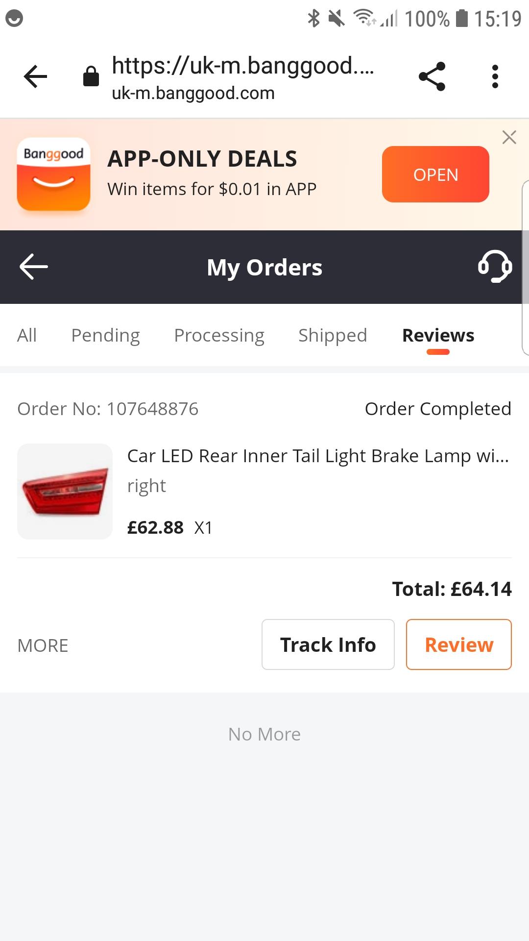

hello thanks for the reply. Both inner boot clusters indicator LED have now started blinking rapid. the outer clusters work fine. Have not checked the fuse yet. As its LED cant get an led strip. do you know how much they go for. on eBay averaging £120.

3 hours ago, Paul cairney said:
Hi good find and thanks for publishing it, if the people who have the problem can be bothered to look its a great piece of information, well done.
