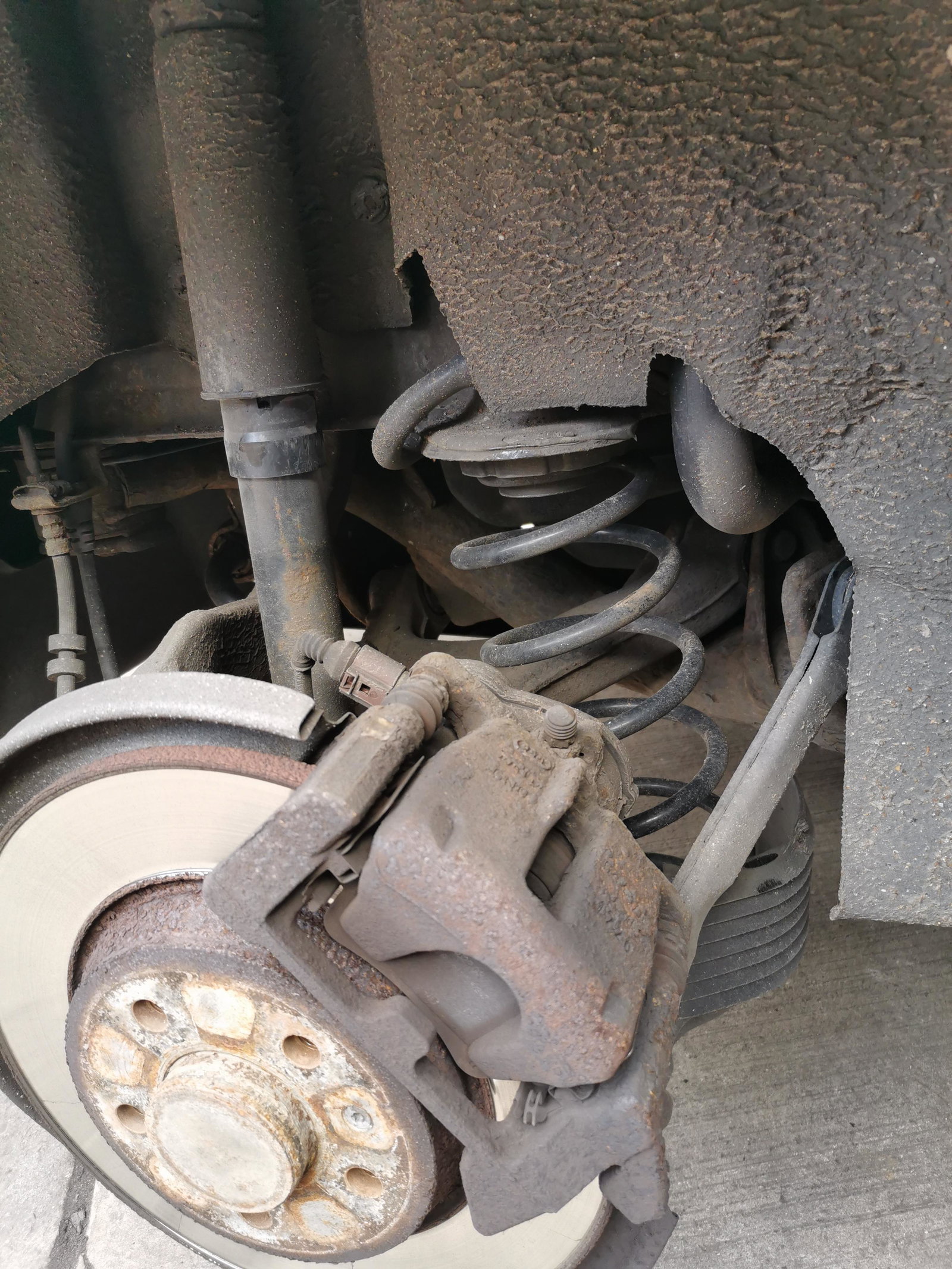

Shaf Posted February 10, 2022 Share Posted February 10, 2022 Hi does anyone know what mm a standard a4 b8 has? My car is an s line model, so when the garage changed one of my rear suspension I noticed it was way higher then the rest, I just assumed because it was a new one it would settle down but it hasn't so now I'm looking to replace it but I don't know what the height is. Thank you Quote Link to comment Share on other sites More sharing options...

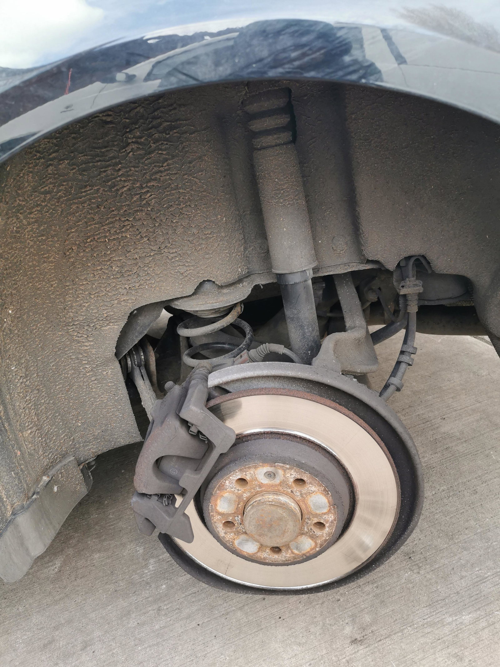

Shaf Posted February 11, 2022 Author Share Posted February 11, 2022 2 minutes ago, Shaf said: As you can see one is considerably higher. Quote Link to comment Share on other sites More sharing options...

Stevey Y Posted February 11, 2022 Share Posted February 11, 2022 15 hours ago, Shaf said: Hi Shaf the first picture nails it as you can plainly see the top of the spring is not sitting in the spring mount and has one coil wrapped around the top of the spring mounting if you look at the other picture as this one its sitting in the top mount on its rubber vibration cushion, technically you should always replace springs in pairs as what is classed as the good side has a fair amount of corrosion at the top, tbh the bad side looks like its been fitted upside down. Steve. 1 Quote Link to comment Share on other sites More sharing options...
Shaf Posted February 12, 2022 Author Share Posted February 12, 2022 16 hours ago, Stevey Y said: Hi Shaf the first picture nails it as you can plainly see the top of the spring is not sitting in the spring mount and has one coil wrapped around the top of the spring mounting if you look at the other picture as this one its sitting in the top mount on its rubber vibration cushion, technically you should always replace springs in pairs as what is classed as the good side has a fair amount of corrosion at the top, tbh the bad side looks like its been fitted upside down. Steve. Thank you Steve really appreciate it. I will get them replaced together. Quote Link to comment Share on other sites More sharing options...
