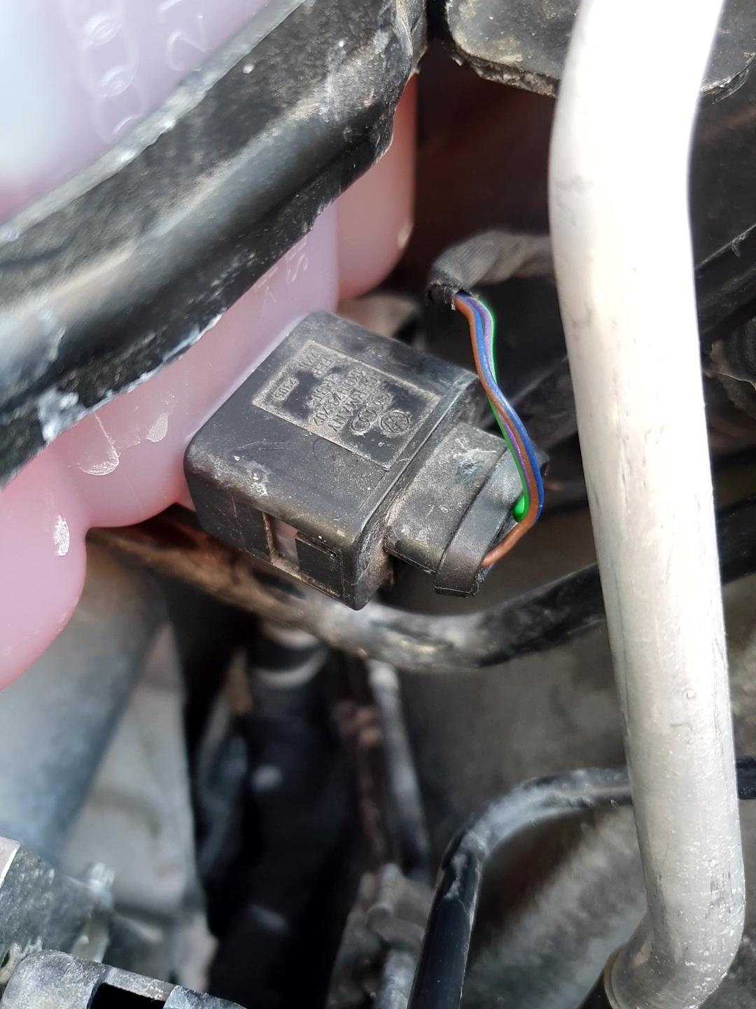

Entwood Posted February 11, 2022 Author Posted February 11, 2022 Hi, many thanks for the prompt reply, appreciate it. Attached a photo of the connector, wth the wires "bent" to the position that appears to give the least number of warnings !! Still happen , but just not as often ! Your idea if cleaning up the pins was in my mind, but I'd also like to check the readings via a meter if possible. Thanks again E
Stevey Y Posted February 11, 2022 Posted February 11, 2022 4 hours ago, Entwood said: Hi, many thanks for the prompt reply, appreciate it. Attached a photo of the connector, wth the wires "bent" to the position that appears to give the least number of warnings !! Still happen , but just not as often ! Your idea if cleaning up the pins was in my mind, but I'd also like to check the readings via a meter if possible. Thanks again E Hi give it a good soak in WD then using a small electrical screwdriver under that square tang at the front next to the pink square and prise it gently out whilst pulling it away from the tank, once you get it going give it a wiggle and it should fall off, don't be surprised if the tang snaps off but thats no major drama as its 聽a tight fit anyway and you can put a good quality ty wrap on it just to give it a bit of extra squeeze. Steve.
Entwood Posted February 11, 2022 Author Posted February 11, 2022 Brilliant, many thanks ... will attack it tomorrow !!聽 I might take meter readings anyhow and publish them just to see what the "hive mind" thinks ! I'm starting to think that - as the frequency of the warnings changes with the bending of those two wires - that the problem is probably in that plug somewhere... be it corrosion, a bad connection or a nearly broken wire ...聽 be interesting to see whats inside it ! 1
Stevey Y Posted February 11, 2022 Posted February 11, 2022 58 minutes ago, Entwood said: Brilliant, many thanks ... will attack it tomorrow !!聽 I might take meter readings anyhow and publish them just to see what the "hive mind" thinks ! I'm starting to think that - as the frequency of the warnings changes with the bending of those two wires - that the problem is probably in that plug somewhere... be it corrosion, a bad connection or a nearly broken wire ...聽 be interesting to see whats inside it ! Hi worse case scenario is get another plug from the breakers with a suitable amount of wire left on it at cut and shut the wiring and solder it together. Steve.
