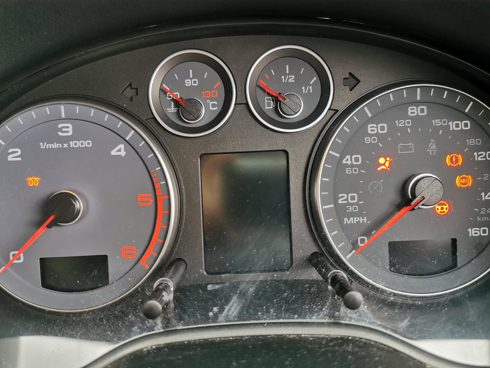

Hax Posted February 20, 2022 Posted February 20, 2022 Hi all, I'm hoping someone can give me some advice. I got in my car (a 2012 8P A3) last night, first time after Storm Eunice, and when I started it, the intrument cluster didn't light up as expected I had a series of warning lights illuminated (shown in the photo). The day before everything was working fine and the car was just left parked up during the day of the storm so I'm wondering if it is a case of water being blown in causing a problem somewhere. I have checked the fuses and all look intact to me. The car still starts fine and seems to run OK - I just have no movement in the speed, rev, fuel and temperature gauges and the display is in complete darkness. Any help or advice is greatly appreciated. Many thanks, Adam
cliffcoggin Posted February 20, 2022 Posted February 20, 2022 Adam. It is not unknown for the A3 instrument cluster to develop faults and need repair or replacement, but it's a bit of a coincidence it went wrong during the storm. Can you get the car under cover for a day or two with the fuse boards and any connectors open to allow any moisture to dry? Maybe use a hair dryer, not a paint stripping hot air gun, to warm them. If that fails you may well need to have the cluster repaired, though wait for other responses on the forum before taking it out. Are there any other seemingly unrelated electronic problems such as limp mode, loss of cruise control etc that began at the same time?
Hax Posted February 20, 2022 Author Posted February 20, 2022 Hi Cliff Thanks for your reply. As far as I can tell, the car is running perfect. I have just driven 12 miles to my office and back again without any problem. There are no signs of water in the fusebox under the bonnet - the question is whether is has managed to get anywhere else. Unfortunately, I don't have a covered area to park in. I found one video on YouTube where someone else had the same problem and after they checked everything out, they read that a low battery can cause this to happen and so took their car on the motorway and the problem "went away". My car has been sat for long periods as I am working from home mostly - but normally I get a message telling me the battery is low - at which point I take the car for a reasonable run. The 24 mile round trip to the office hasn't solved it. I've now left it with the negative battery terminal disconnected for the last 15 minutes - I'll go and reconnect that and if it doesn't fix it I'll go for a short run on the motorway to make sure there is some juice in the battery. Otherwise, I guess I'll be sending the cluster off to one of these repair services. I'll post back if anything changes after my motorway run... Wish me luck! Adam
cliffcoggin Posted February 20, 2022 Posted February 20, 2022 Adam. A defective battery can indeed cause false warnings in the instrument panel as well as other odd behaviour. It's why I asked about other symptoms. If you have been getting battery warnings recently then I would put money on it, if I was a betting man, being the cause of the false warnings. Your only realistic option is to fit a new battery. Charging the existing battery will not solve the problem.
Hax Posted February 20, 2022 Author Posted February 20, 2022 Hi Cliff I've just returned and as expected, no change. Interestingly, in the four years I have owned this car, the stop/start has only ever kicked in maybe 5 times. During this journey, it kicked in twice - the first time it caused a bit of panic as I was worried the car had died completely!! The battery warnings are more prevalent in the really cold weather - it happened last Winter too. Maybe tomorrow I will pop to Halfords and ask them to test the battery for me...

Hax Posted February 22, 2022 Author Posted February 22, 2022 So, I had the new battery fitted today and the problem still persists - sadly 😞 Now to decide on the next course of action - book the car into a local garage for a diagnosis or just send the instrument cluster off for repair... At the moment I'm leaning towards the garage option just to understand what the problem actually is.
Hax Posted February 23, 2022 Author Posted February 23, 2022 The garage I use can not fit me in until Tuesday next week so I have decided to just bite the bullet and go ahead and try the service offered by ECU Testing as I can possibly have a fixed unit back by the time I even get the car to the garage - or at least I will know soon enough if there is no fault and then I can book the car in anyway.
cliffcoggin Posted February 23, 2022 Posted February 23, 2022 17 hours ago, Hax said: So, I had the new battery fitted today and the problem still persists - sadly 😞 Now to decide on the next course of action - book the car into a local garage for a diagnosis or just send the instrument cluster off for repair... At the moment I'm leaning towards the garage option just to understand what the problem actually is. That's unfortunate, but the money was not wasted in view of the warnings the car gave you.
