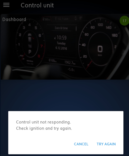

So, my OBCeleven arrived this afternoon and I've been out to run a scan for fault codes.   The "interesting" areas are at the bottom.
Note that nearly every modules complained about the loss of communication with the instrument cluster.  And whilst the "Dashboard" says "No trouble codes found", in reality when I tried to access that section OBDeleven was coming back with the following message:
Also, just as I was about to get out of the car, some life came back to the instrument panel in the form of these randomly flashing lights:

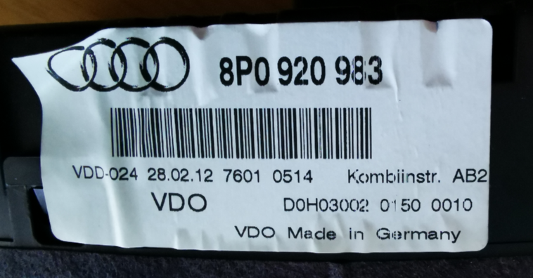

@Stevey YBefore I sent the unit off thte first time, I took a photo of the only label I could see on it.  I'm not sure what the required code would look like, are you able to advise if it is contained on this label please?
