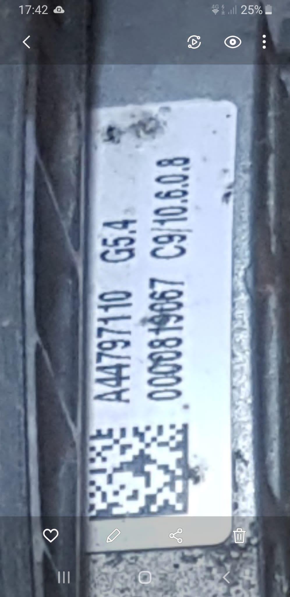

8 hours ago, mr angry said:
This is the label for the controller but looks like it may be integral to the fan itself
Hi thats not the part number thats a manufacturer number, and yes it detaches from the fan pack it is either one or two torx screws and a couple of wiring clips to each fan they do a replacement unit on line for about £70.
I have searched everywhere and was given the part number as "4H0959455AD" from a garage who want £1500 to sort it which seems a lot.  Is there any way of confirming the part number and where best to buy the controller?
Hi looking at it on my parts system it does come up as a one piece unit for that part number, have a look at eBay item number 393394784912 it is not cheap but about £150 in labour it still won't come anywhere near £1500.
