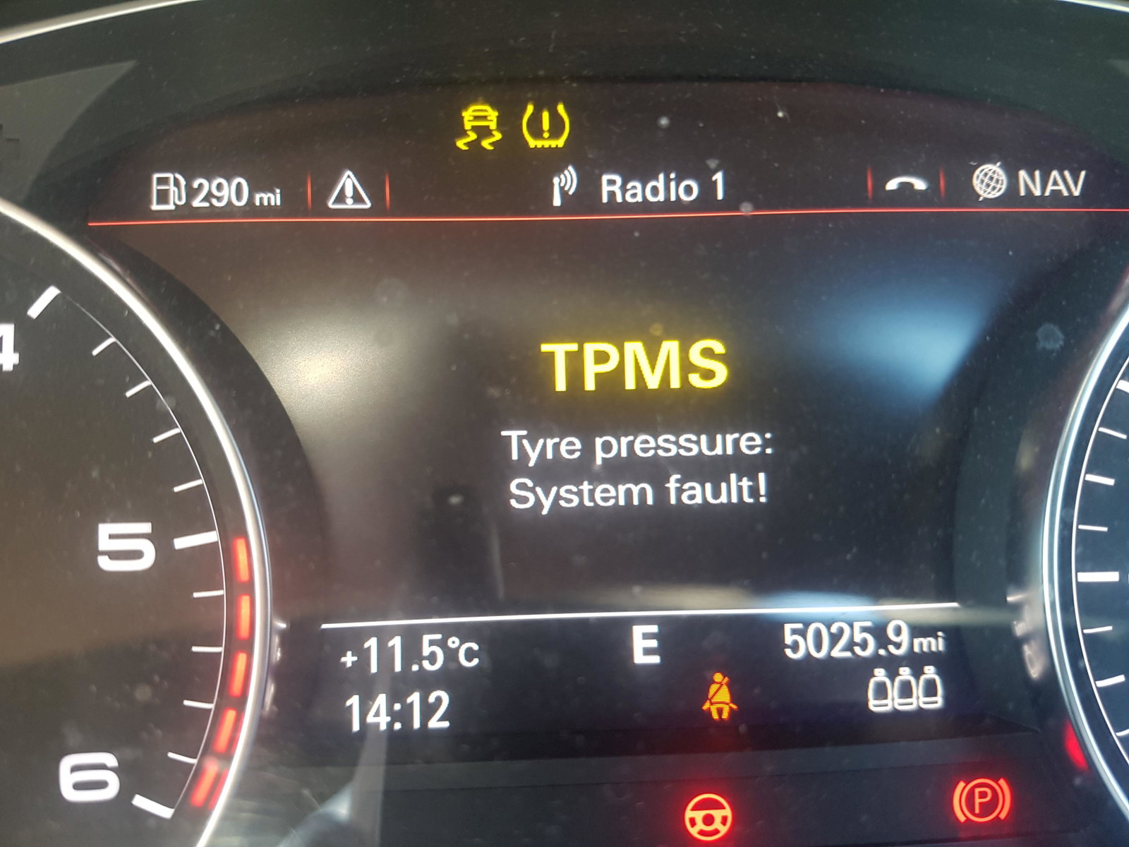

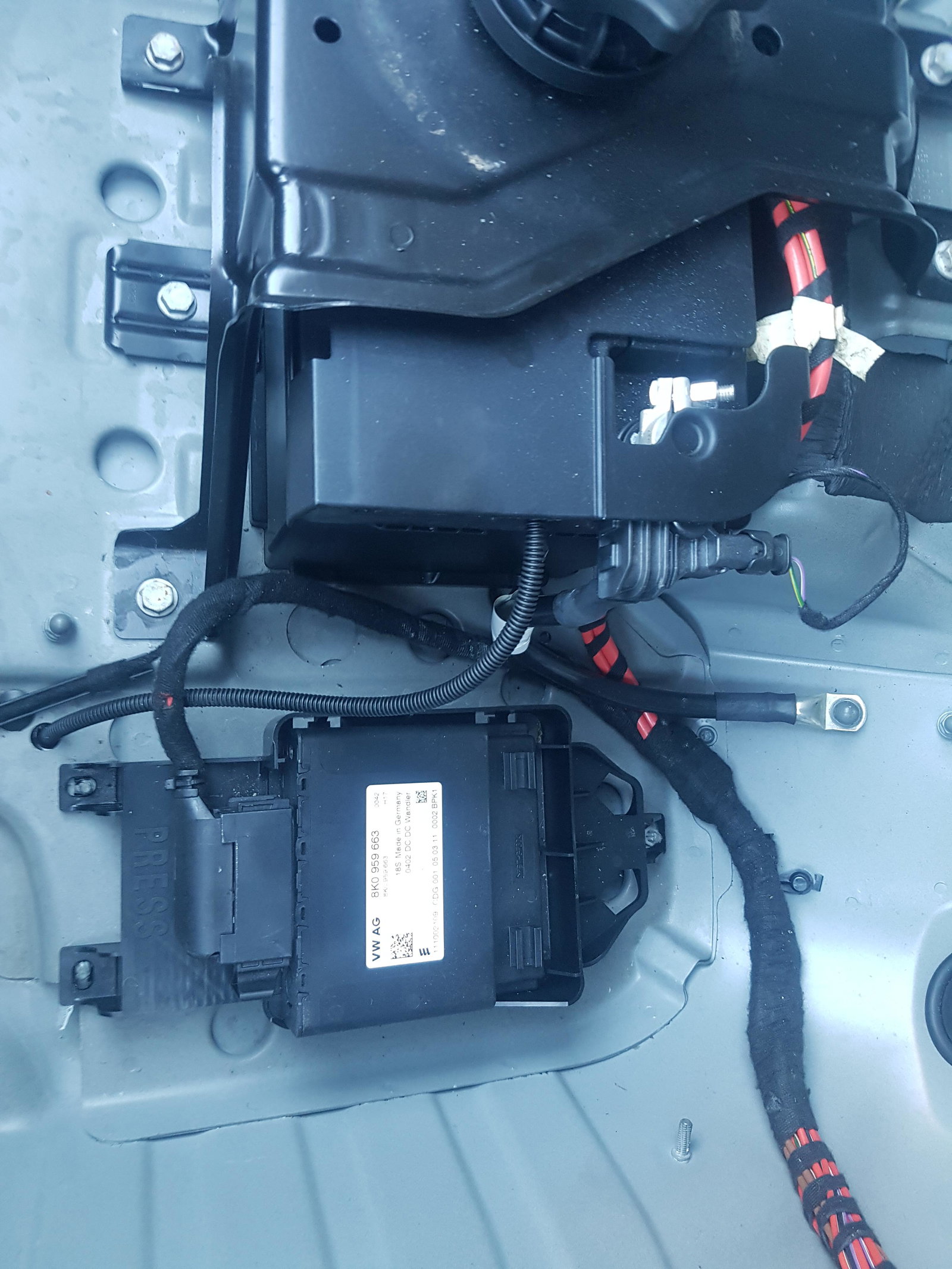

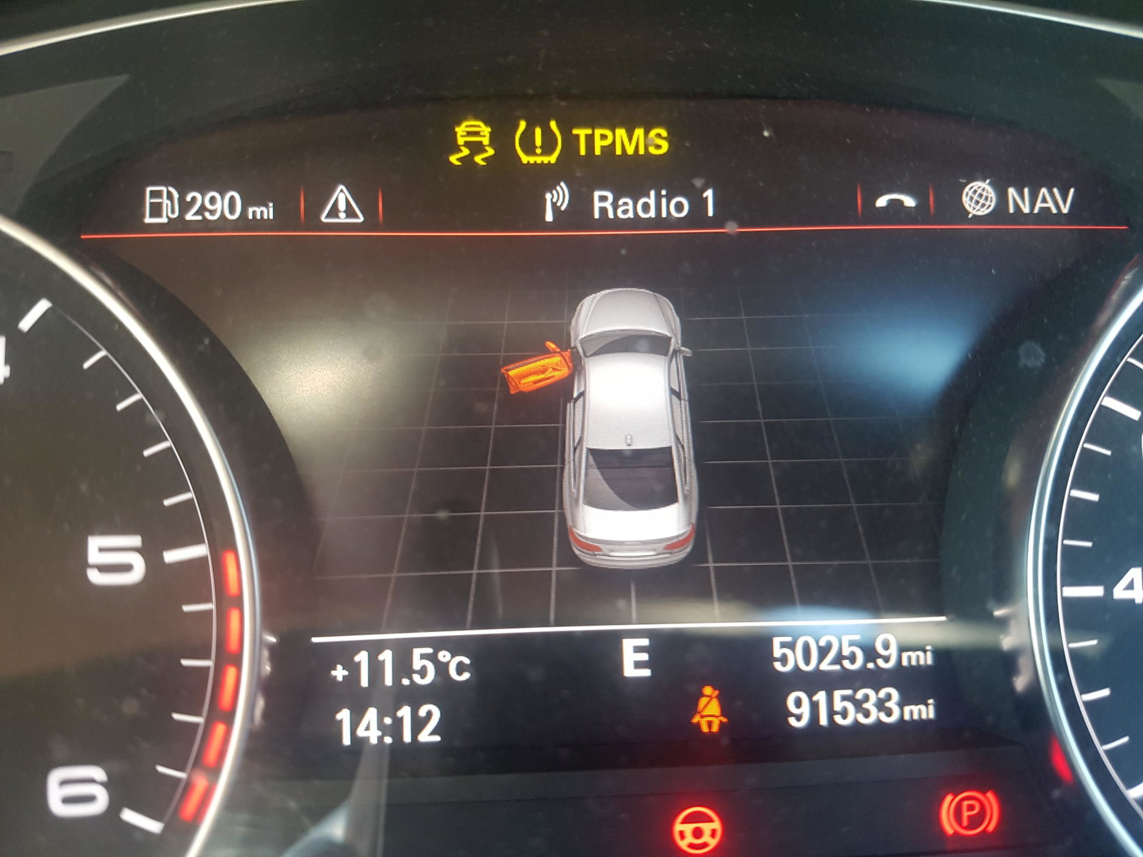

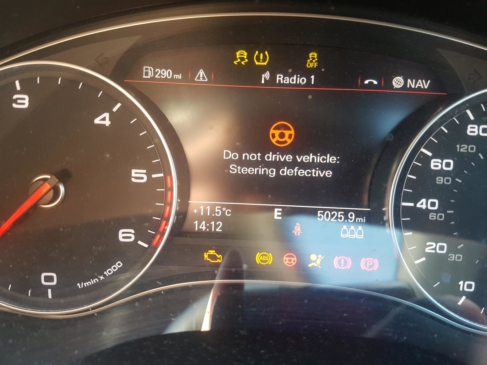

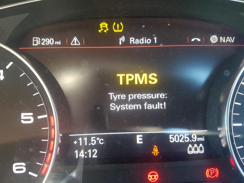

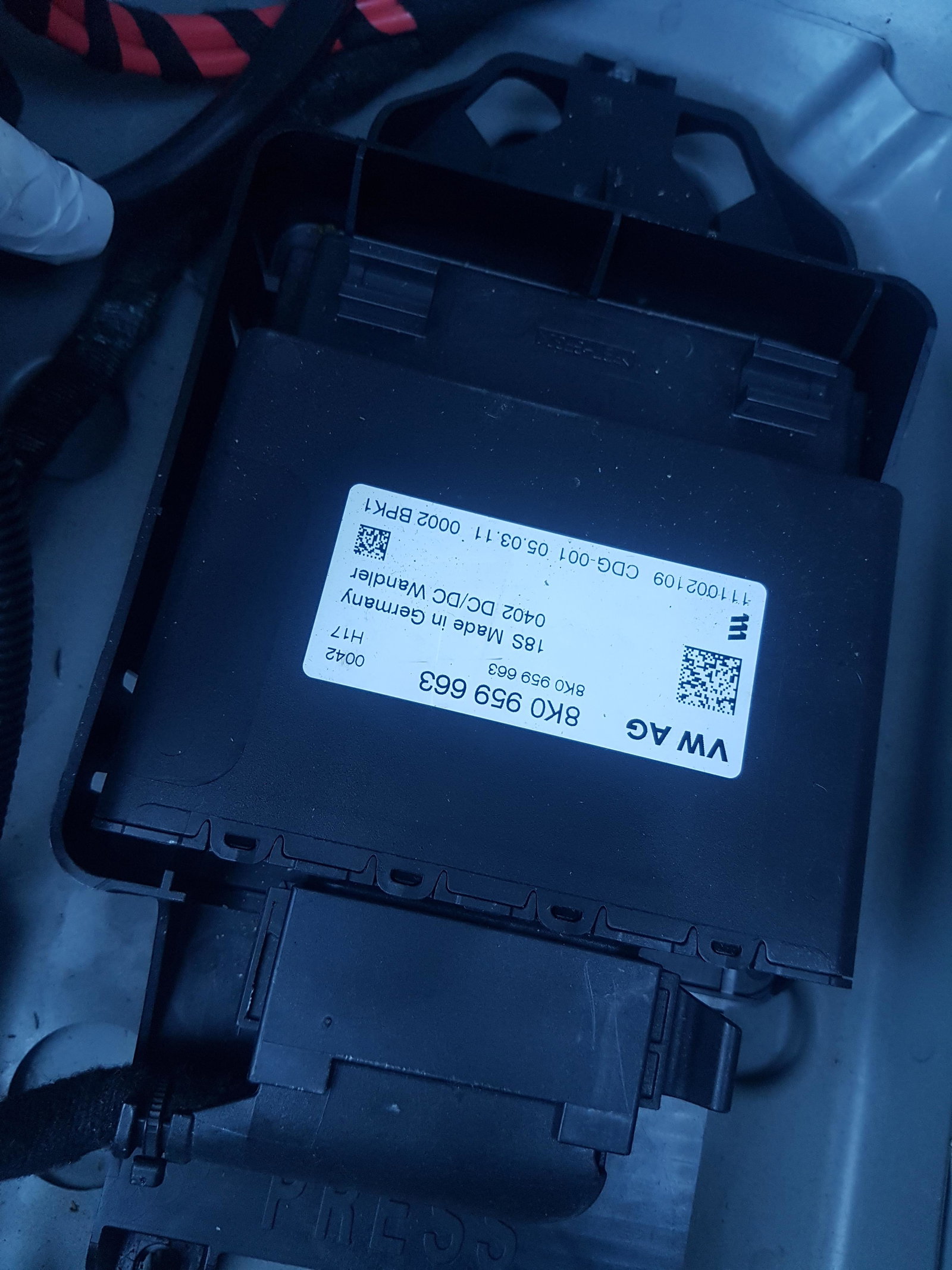

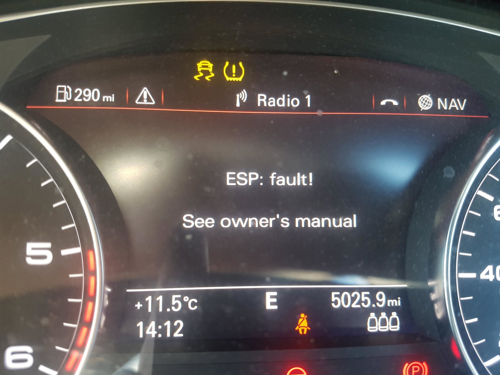

Paul cairney Posted March 19, 2022 Posted March 19, 2022 Can anyone tell me what this box is its in the boot next to battery boot had some water in it rook to halfords for battery health check and its at 93% and is charging ok so not battery that is problem thanks in advance
Stevey Y Posted March 19, 2022 Posted March 19, 2022 1 hour ago, Paul cairney said: Can anyone tell me what this box is its in the boot next to battery boot had some water in it rook to halfords for battery health check and its at 93% and is charging ok so not battery that is problem thanks in advance Hi I think thats a voltage stabiliser module, nothing in the boot enjoys water. Steve.
Anton8 Posted March 20, 2022 Posted March 20, 2022 You are quite right Steve. It is a voltage stabiliser module. ( Checked part number online)
Stevey Y Posted March 20, 2022 Posted March 20, 2022 44 minutes ago, Anton8 said: You are quite right Steve. It is a voltage stabiliser module. ( Checked part number online) Hi Tony, can you expand on the multiple faults you titled this post with ?. Steve.

Stevey Y Posted March 21, 2022 Posted March 21, 2022 14 hours ago, Paul cairney said: Hi I hate to say this but these are ALL classic symptoms of a failing battery, I don't know how old your old battery is but if it was not readapted to the car when fitted it will fail in record time, do you have access to any diagnostics as I am sure these lights are communication fault caused by inconsistent battery voltage, in the old days a car could run on a knackered battery mostly on whatever the alternator puts out but later vehicles won't as the alternator currents always fluctuating. I would start in the boot and check all the wiring and plugs that were anywhere near that water the easiest way to check would be connect the car to a slave battery and run the car on and off a few times to see if any of the lights disappear but TBH plugging in is really the only definitive answer. Steve. 1

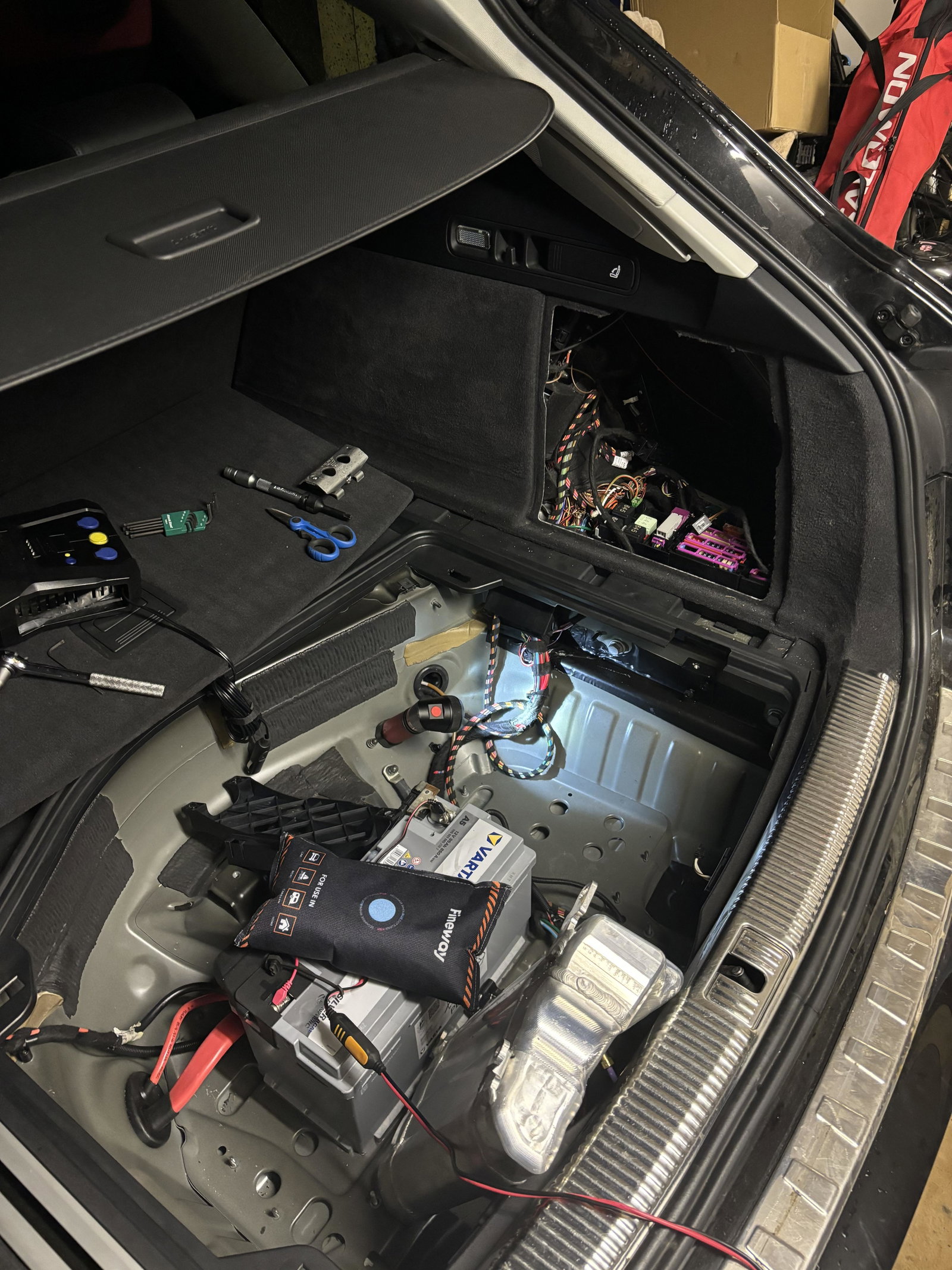

Jonny G Posted March 24, 2024 Posted March 24, 2024 Like others on the thread, I’m beginning to think that this is all due to moisture. On further investigation, I found that the carpet in the boot was soaking, as was the boot floor. Stripped it all out and dried everything off in the sun. I’ve sealed all the rubber plugs and dried the Voltage stabiliser unit. I’m hoping that this will solve the problem.
Jonny G Posted March 26, 2024 Posted March 26, 2024 My joy has been short lived. The car is fine when driving in the dry, but today in the rain, all the faults have returned. I spent an age trying to seal any and all holes in the spare wheel compartment of the car where I keep finding moisture, but I keep finding moisture in the bottom and a damp patch on the carpet, drivers side under the spare wheel, below the Bose sub woofer. Does anyone else have any suggestions?

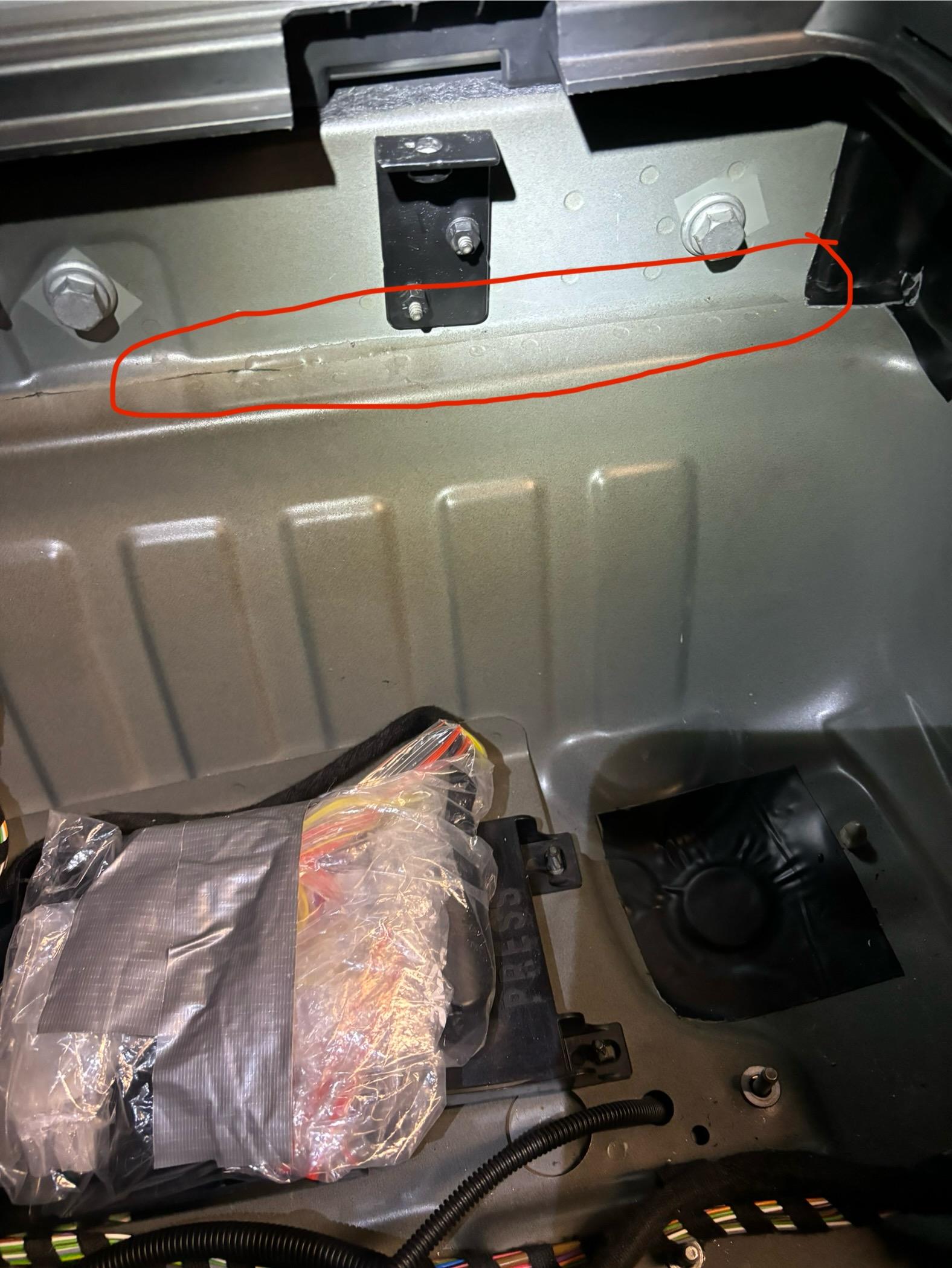

Jonny G Posted March 26, 2024 Posted March 26, 2024 Thanks yes, saw that thread. It seems a common issue with the C7, they like to let water in as much as possible. Further investigation this evening and I narrowed down the leak. See the picture attached, but the leak is coming through a seam in the side wall. Circled the area in red. I have sealed this area with Gorilla waterproof patch & seal tape. I removed the Voltage stabiliser unit to dry it out, and also moved the wiring loom for the Voltage Stabiliser unit up and back out of the spare wheel well up into the area where the main fuse board unit is. I hope that these two actions will cure the problem. 1
