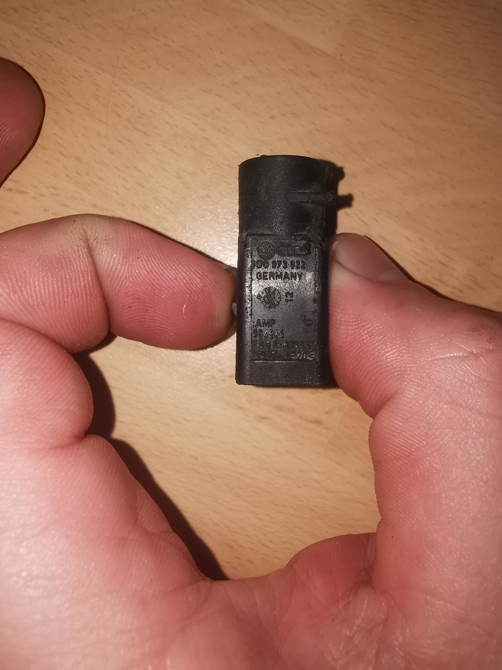

Unluckyme Posted March 27, 2022 Author Share Posted March 27, 2022 12 hours ago, Stevey Y said: Hi anything that is disconnected will cause a problem as the whole car is full of CCM modules which talk to each other therefore if one is silent, a break in the circuit the rest of the modules throw a hissy fit and won't work properly, have a look in daylight and see if you can work out which way the connector fits as it can only connect one way and they normally have a strange shaped piece of plastic on the male side that only allows it to push in one way. Steve. So, been out and identified this as the connector. It has a part number of 8D0973822. I cannot find for the life of me what it's actually for, however one advertised on eBay labels it as a battery negative connector..? Quote Link to comment Share on other sites More sharing options...
Magnet Posted March 27, 2022 Share Posted March 27, 2022 Hello Stephen, We take it this damaged plug actually plugs into a counterpart, as opposed to just being open ended - for some other unused component. If as we would believe, it’s part of a ‘plug into something else’ then you might find it will be part of the loom, and not a separate part ( although the same type of connector may have been used elsewhere on the car). Just two wires associated with this plug? If so, why not simply join the two wires to their counterpart? I would certainly not use crimp type connectors, but solder the connections and run a length of shrink sleeving to cover and properly insulate the joins. Kind regards, Gareth. 1 Quote Link to comment Share on other sites More sharing options...
Stevey Y Posted March 27, 2022 Share Posted March 27, 2022 8 hours ago, Unluckyme said: So, been out and identified this as the connector. It has a part number of 8D0973822. I cannot find for the life of me what it's actually for, however one advertised on ebay labels it as a battery negative connector..? Hi unfortunately the eBay connector looks different from the original, as asked do you only have the two wires going into the plug? in which case they should be coloured so matching one side to the other should be easy if you go the cut and shut route just make sure the key is nowhere near the car when you do it, just unlock it and leave the car for ten mins to settle before commencing work. Steve. Quote Link to comment Share on other sites More sharing options...
Unluckyme Posted March 27, 2022 Author Share Posted March 27, 2022 1 hour ago, Stevey Y said: Hi unfortunately the eBay connector looks different from the original, as asked do you only have the two wires going into the plug? in which case they should be coloured so matching one side to the other should be easy if you go the cut and shut route just make sure the key is nowhere near the car when you do it, just unlock it and leave the car for ten mins to settle before commencing work. Steve. Yeah I went the cut and shut route. I'm laughing at the fact I've fixed the issue, but I still don't know what I've actually fixed. Still.... It works so that's good enough for me. Lol Quote Link to comment Share on other sites More sharing options...
