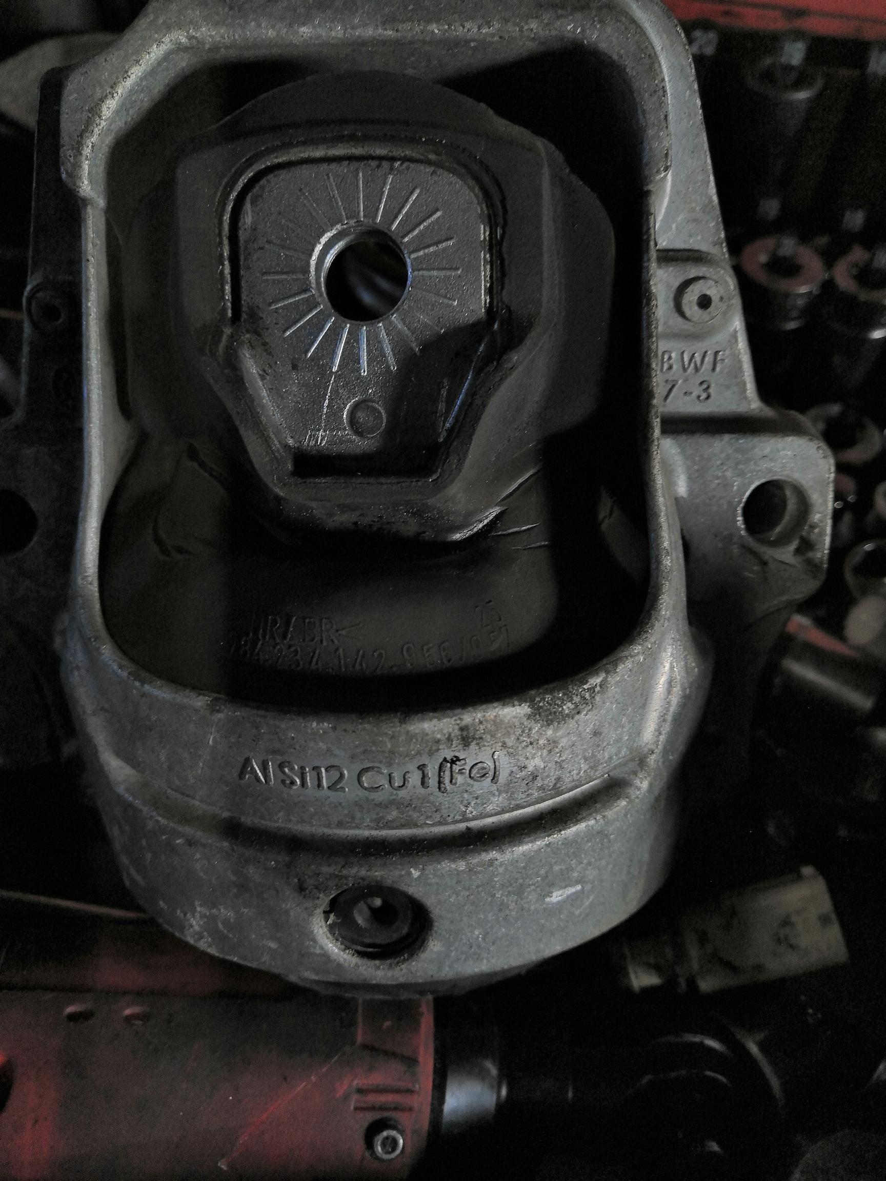

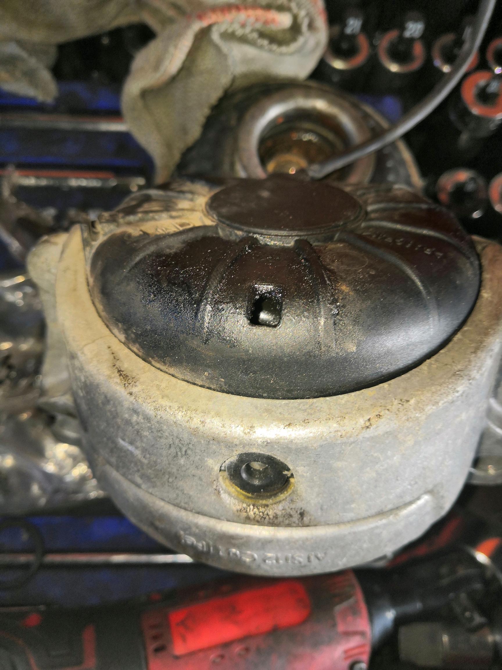

RoyBrown Posted April 16, 2022 Author Share Posted April 16, 2022 On 4/12/2022 at 9:50 PM, Stevey Y said: Hi I had the same thing on my A6 which is not that different with how it works, my educated guess is its the engine and gearbox mounts, what happens is the engine mounts are Hydro mounts which are filled with oil and controlled electronically and stiffen up when stressed, the problem is they wear/split and the resulting vibration and movement knocks out the gearbox mount which is bonded rubber/metal, I got all three mounts on line from carparts in motion and if you ring them they are very helpful and what you want is listed normally on eBay and a damn sight cheaper than Audi, all the parts I bought were Febi and all movement ceased, I use the car as a cab and done over 9k since fitting just before Christmas and had no problems. Steve. Hi Steve, Thanks for the reply, good you got your car sorted! Did your happen to shake at idle or just when driving? Quote Link to comment Share on other sites More sharing options...
Stevey Y Posted April 16, 2022 Share Posted April 16, 2022 1 hour ago, RoyBrown said: Hi Steve, Thanks for the reply, good you got your car sorted! Did your happen to shake at idle or just when driving? Hi just when driving and you could see the gearstick moving backwards and forwards when accelerating and decelerating, that part won't be noticeable as much in an auto equipped vehicle, the main benefits were smoother gear changes and the cabin was a lot quieter as one mount had spat all its oil out and the other wasn't far behind it, due to the torque the rear mount had gone soft so I replaced that as well Steve.. Quote Link to comment Share on other sites More sharing options...
Stevey Y Posted April 16, 2022 Share Posted April 16, 2022 2 minutes ago, Stevey Y said: Hi just when driving and you could see the gearstick moving backwards and forwards when accelerating and decelerating, that part won't be noticeable as much in an auto equipped vehicle, the main benefits were smoother gear changes and the cabin was a lot quieter as one mount had spat all its oil out and the other wasn't far behind it, due to the torque the rear mount had gone soft so I replaced that as well Steve.. This is not a DIY job as you need a four poster ramp and a hydraulic gearbox cradle to take the weight of the engine, the mounts are available from Carparts in motion on eBay for about a third of what AUDI want for just one you can buy the pair and if you phone them they will tell you which listing to buy, my units have done 15k since fitting all fine and dandy, as you can see the dry one on the right is beginning to delaminate and the left had no oil. Steve. 1 Quote Link to comment Share on other sites More sharing options...
