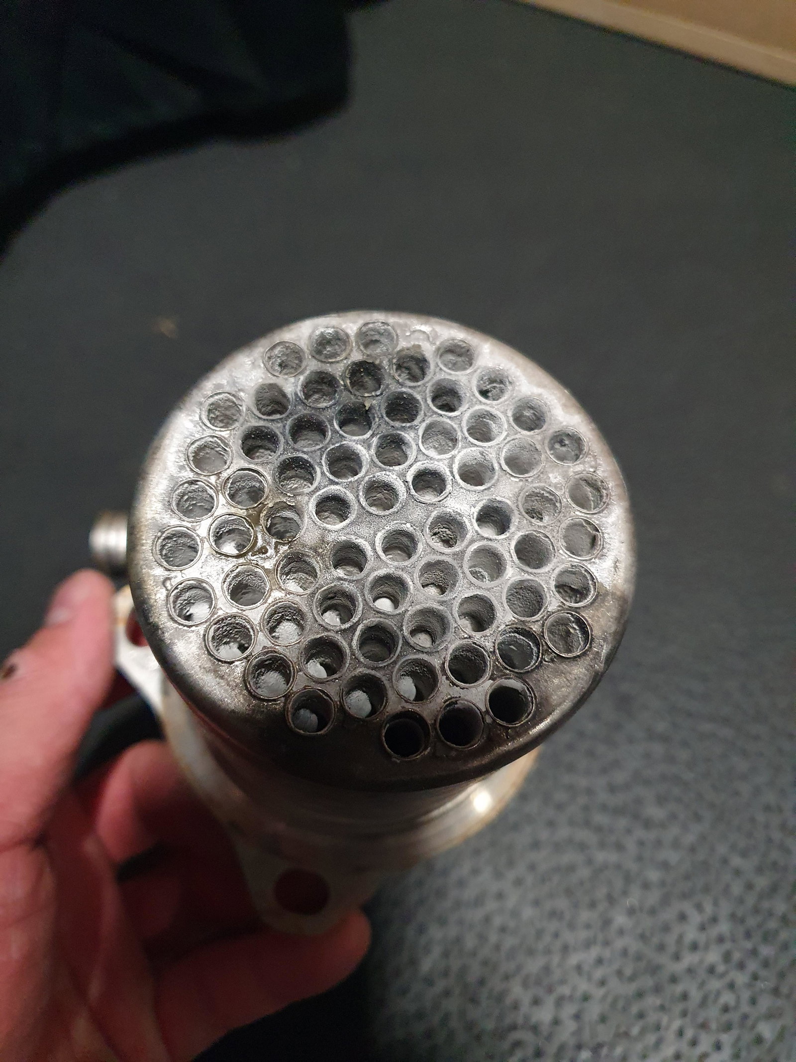

Hi I think I have found your problem, spoken to a rather drunk Audi tech last night who explained that its probably the EGR cooler beginning to block up as that will make the ECU think its the DPF blocking, the cooler can be found hanging out of the back of the DPF under the turbo, Audi issued a TSB to the dealers about this a while ago as it was becoming a frequent problem.

Hi Steve, thank you for considering this, and for the feedback.
Was is TPI_2050077-7 posted on Apr 27th? I enquired about the EGR cooler with a VAG specialist I've taken the cars to for around 8 years (to get a feel for the "what if") and they said it's a 6 hour job totaling ~£900 with a new EGR valve and cooler assembly.
Cleaning is a possibility but they didn't recommend it because most of the cost is labour.
They also recommended changing the sensors for the reasons you suggested, as the overall cost is insignificant. And the quality of AdBlue can attribute to this greatly.
Definitely not on the same level as the A4 ha. It wouldn't be my luck for it to come down to the sensor.
I had the MIL come on the dash, so I've raised it with the warranty company and will see how it goes.
Given these engines can do in excess of 300k if serviced, the recirculation system is a disaster.

Hi the worst of it is they have TWO EGRs one below the cat and one on the inlet manifold, I wonder what brain dead moron thought that one up, if its any consolation what you have been quoted is pretty cheap considering Audi want over two grand.
I didn't know there are two. Have just looked through the workshop manual:

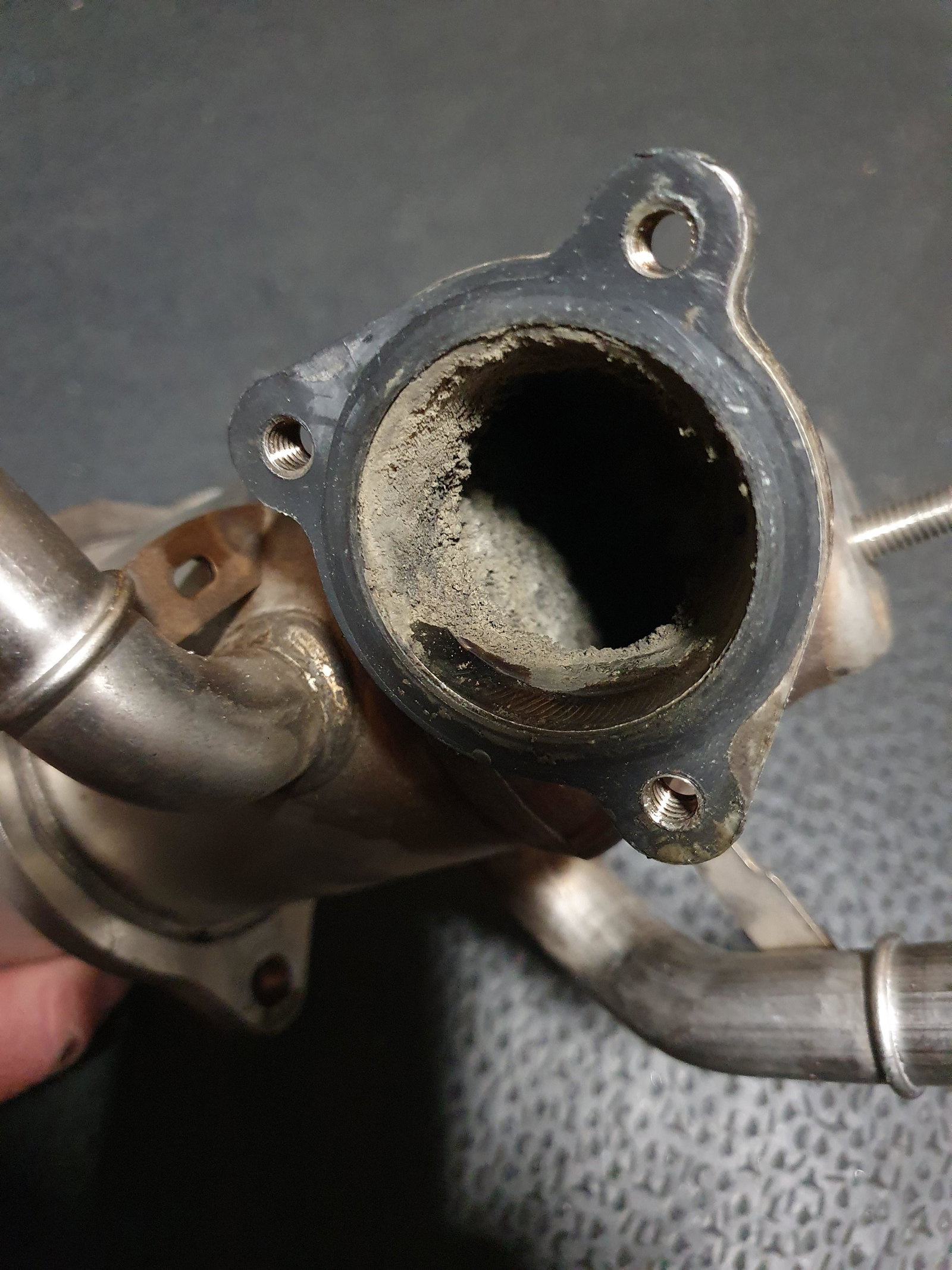

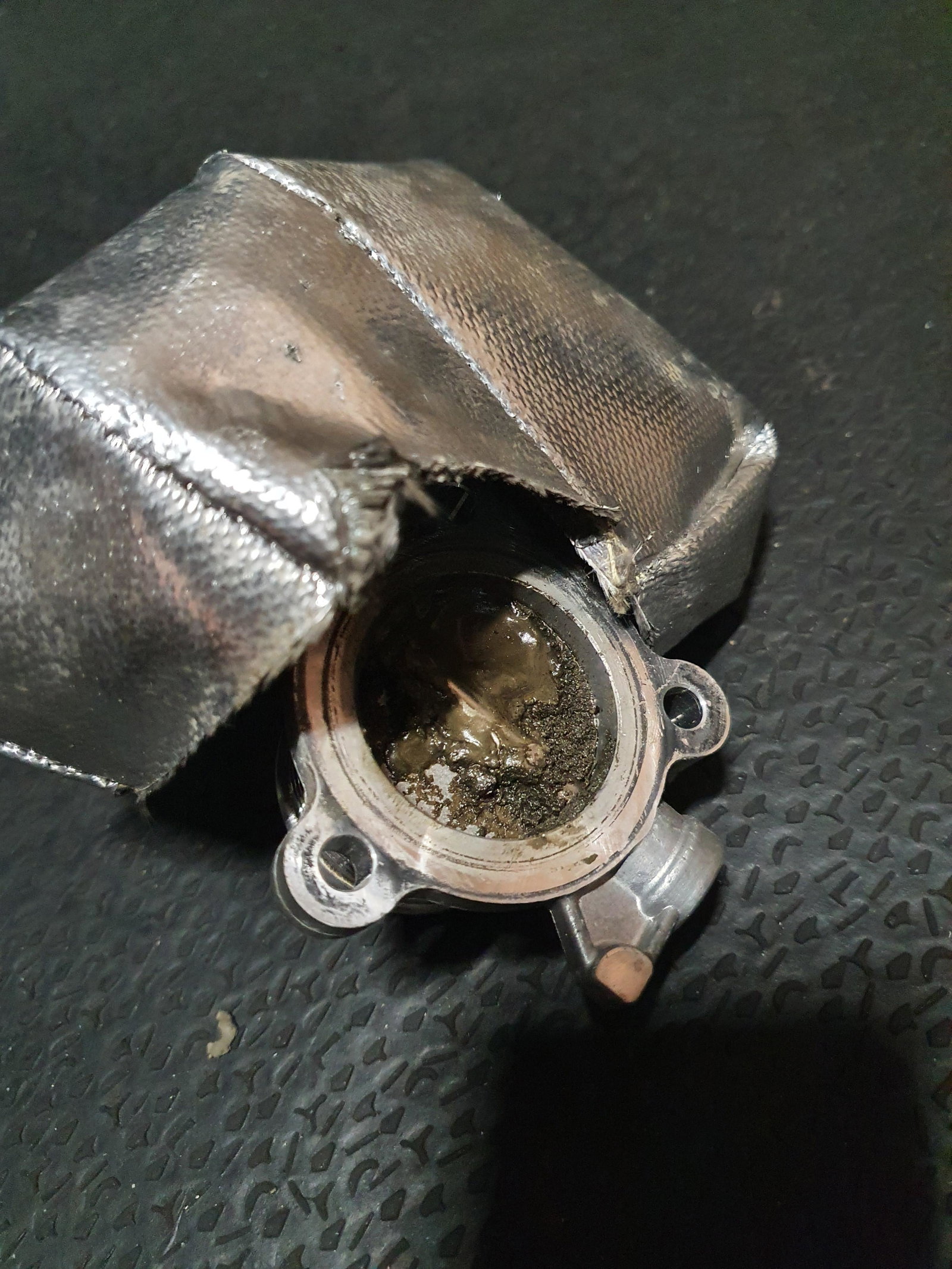

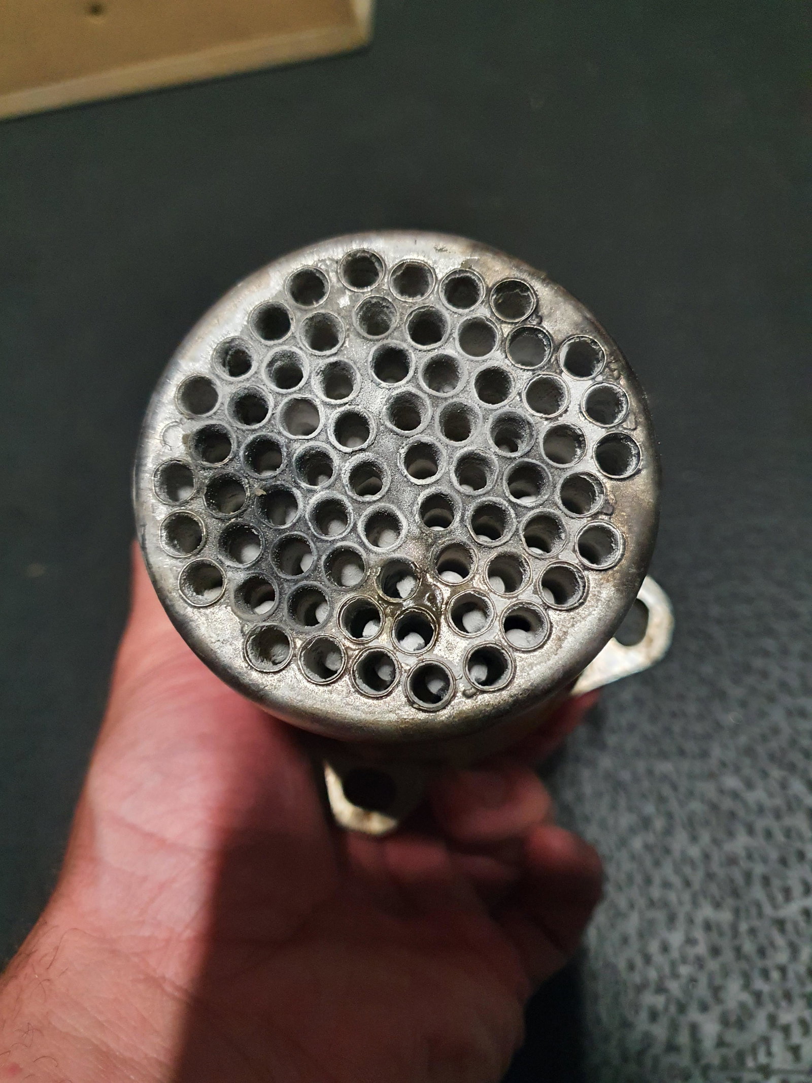

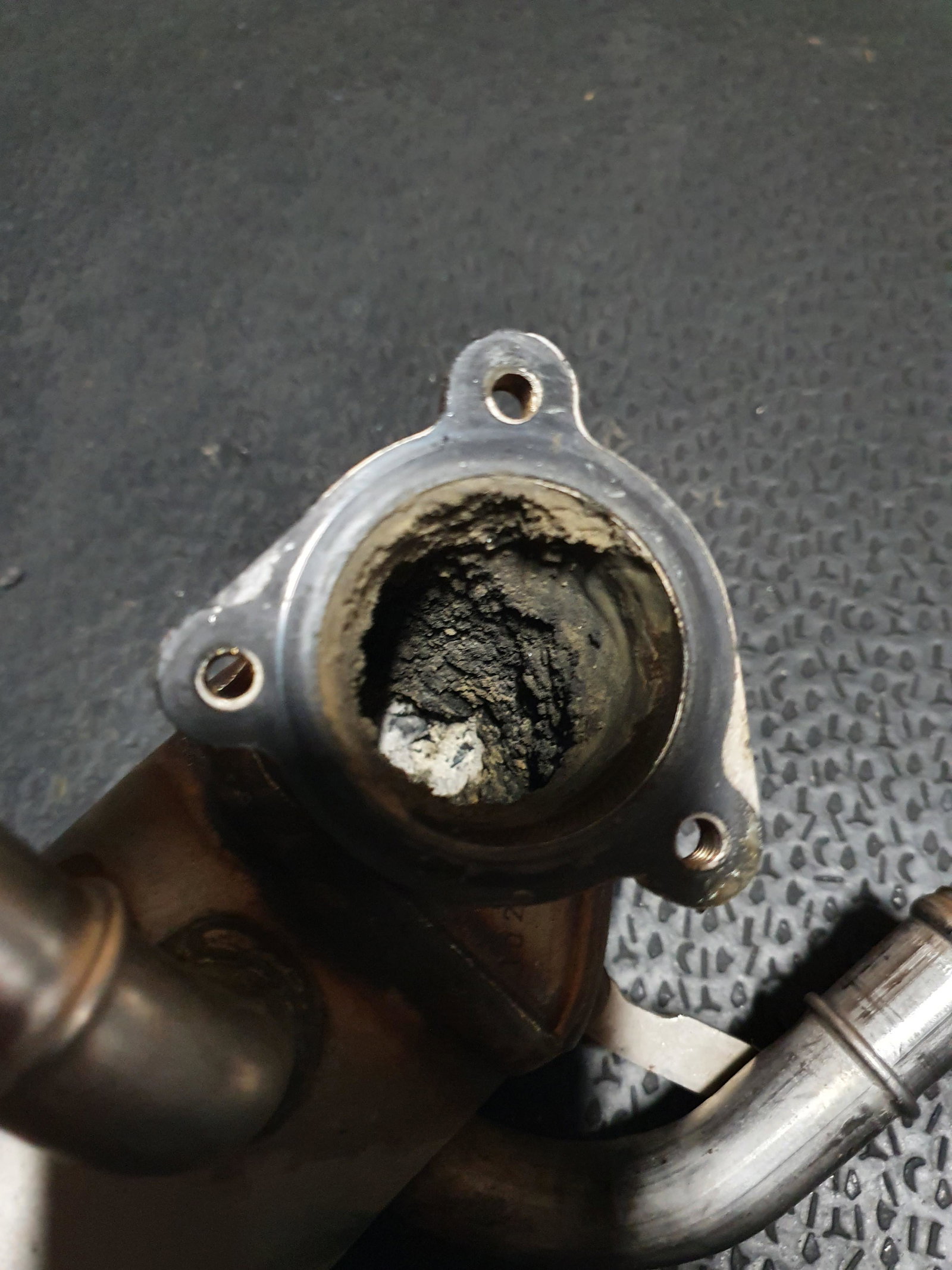

Car is booked in to have the EGR Valve and Cooler replaced. I'll get some photos of the old parts, and do a quick summary of my experience and learning when it's done.
  • 4 weeks later...
This P2002 00 code (as far as I can tell) was first logged on Oct-27 2021 at 69669 miles according to the scan I had done when I purchased the car in March with not many more on the clock
The MIL first came on in April at approx. 61k miles, and again in May at just over 72k miles
From that point it came on every 170-200 miles so I was clearing it each week
There was the familiar white smoke deposited on the exhaust pipe, which became much more noticeable after the MIL light came on for the first time
I had both the EGR valve and cooler replaced a few days ago at just under 75k miles as indicated by TPI 2050077/7
My new EGR valve was not adapted
So just to clarify there is no need to consider your DPF for this code as I did initially, however before you rush in to having the parts replaced, check your G450 sensor voltages because it could be that at a cost of around £80
The warranty company requested photos, so I kept the parts and have uploaded them here
Thanks to everyone who has contributed to the thread, and my learning - I hope someone else finds it useful
Hi no need to worry about the DPF as that will carry on regenerating as normal, your parts removed are exactly the same as mine were and if you look at my post with the pictures of the cooler after I cut it in half you will see the crystallised Adblue has invaded the coolant area around the gas tubes, I also had a small amount of crystals in the expansion tank, this is not ideal and means the gas tubes running through the cooler have been compromised and are letting the Adblue steam and crystals into the water jacket but being as the coolant is heavier this tends to push the other way causing the syrup like substance in your pictures, the main problem with this cooler is the cooling length is to short and unlike most other designs used on older engine set ups which have a lot more narrow O.D. set ups but longer cooling runs our shorter larger coolers will always promote corrosion of the cooling tubes because of the heat involved being mounted so close to the DPF core allied to the fact Adblue rots all base metals, most other manufacturers mount the coolers on the outer fringes of the engine block where the ambient temperature in the engine bay helps cooling.
