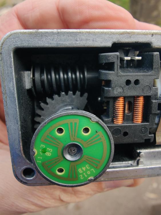

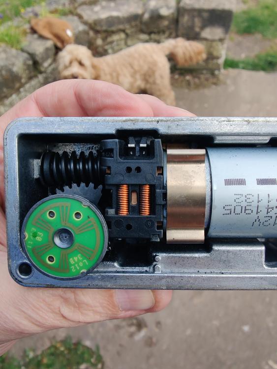

ThomasG Posted April 29, 2022 Author Posted April 29, 2022 Crappy plastic gears. What !Removed!. Took the garage a wee bit to find this, even though I mentioned it. But they also caught a failing solenoid. Attached is pic of those !Removed! plastic parts. Worn worm screw and teeth chipped off the gear. So much for a "glow-plug" warning!
Stevey Y Posted April 29, 2022 Posted April 29, 2022 1 hour ago, ThomasG said: 1 hour ago, ThomasG said: Crappy plastic gears. What !Removed!. Took the garage a wee bit to find this, even though I mentioned it. But they also caught a failing solenoid. Attached is pic of those !Removed! plastic parts. Worn worm screw and teeth chipped off the gear. So much for a "glow-plug" warning! Crappy plastic gears. What !Removed!. Took the garage a wee bit to find this, even though I mentioned it. But they also caught a failing solenoid. Attached is pic of those !Removed! plastic parts. Worn worm screw and teeth chipped off the gear. So much for a "glow-plug" warning! Hi Thomas the Ford ones were a bit different they had bigger gears with more teeth to strip I rebuilt a couple of mine but ended up buying a new unit it was cheaper than keep buying repair kits which only lasted about 40k, they are a real engineering atrocity.
