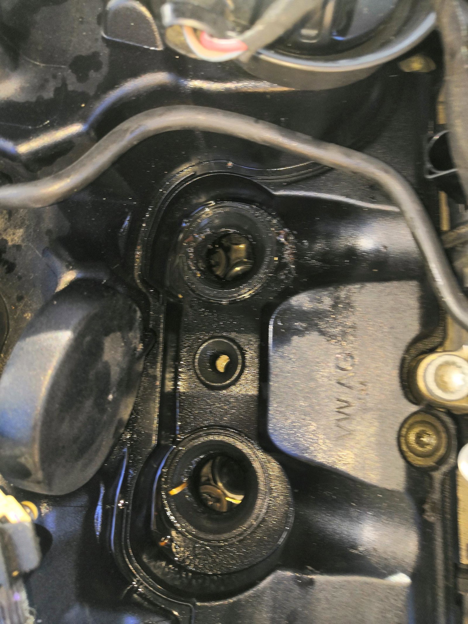

Stevey Y Posted April 26, 2022 Posted April 26, 2022 Hi, over the last couple of months I have been loosing engine oil albeit very slowly, the only sign was around the cross frame and the drivers side of the gearbox, cleaned it off monitored it but despite my best efforts could not find the leak until finally it gave itself away in the recent higher ambient temperatures, I now had fumes from the engine oil in the car and the prime suspect was a blocked PCV valve as that had oil vapour all over it but on closer inspection with a very bright pencil torch it turns out its no 3+4 rubber seals around the injectors allowing the engine to breath through those rather than the PCV which is an integral part of the rocker cover, new cover just shy of £200, two copper injector seals and two rubber seals £36, changed them in just over an hour and am now stink free. Steve.
