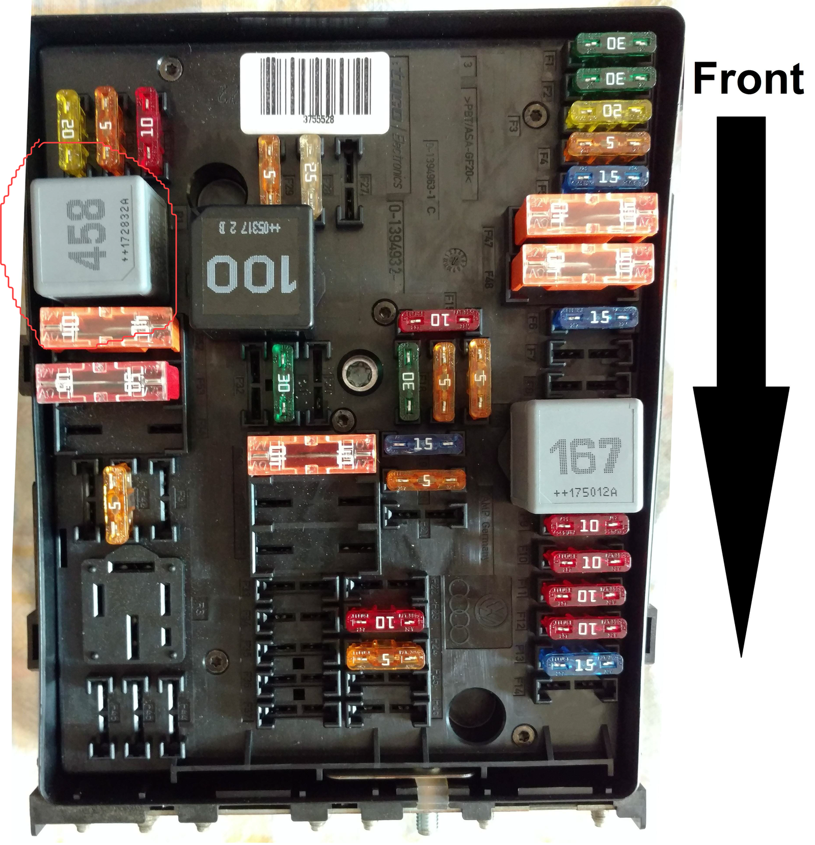

Schoess Posted March 12 Posted March 12 Hey guys, wanted to share my solution here. My 06 2.0t A3 had an issue where it would crank and crank and crank but no start. Eventually I got it to stumble start and it was then running down on at least 1 cylinder. After giving it some gas it would finally clean up and then run fine. I did not immediately have a CEL, but when checking with an OBD2 reader I got these 5 codes, P0688 - ECM/PCM Power Relay Sense Circuit/Open P2149 - Fuel Injector Group B Supply Voltage Circuit/Open P0300 - Random/Multiple Cylinder Misfire Detected P0303 - Cylinder 3 Misfire Detected P0302 - Cylinder 2 Misfire Detected After some research here and online, no clear answers were given. I saw a lot of people replacing a lot of parts and spending money by blindly throwing parts at the car. When reading over the codes, I felt like most of them were "symptom" codes. The misfires are probably related to injector issues and the injectors not getting power is probably related to the PCM code. So I decided to replace my PCM relay, which in my car was not listed online or in the manual hardly anywhere. Here is a photo of the fusebox. The PCM relay is slot R1, circled in red. After replacing the PCM relay, my car is running properly without issue. Hope this helps someone :) 1
