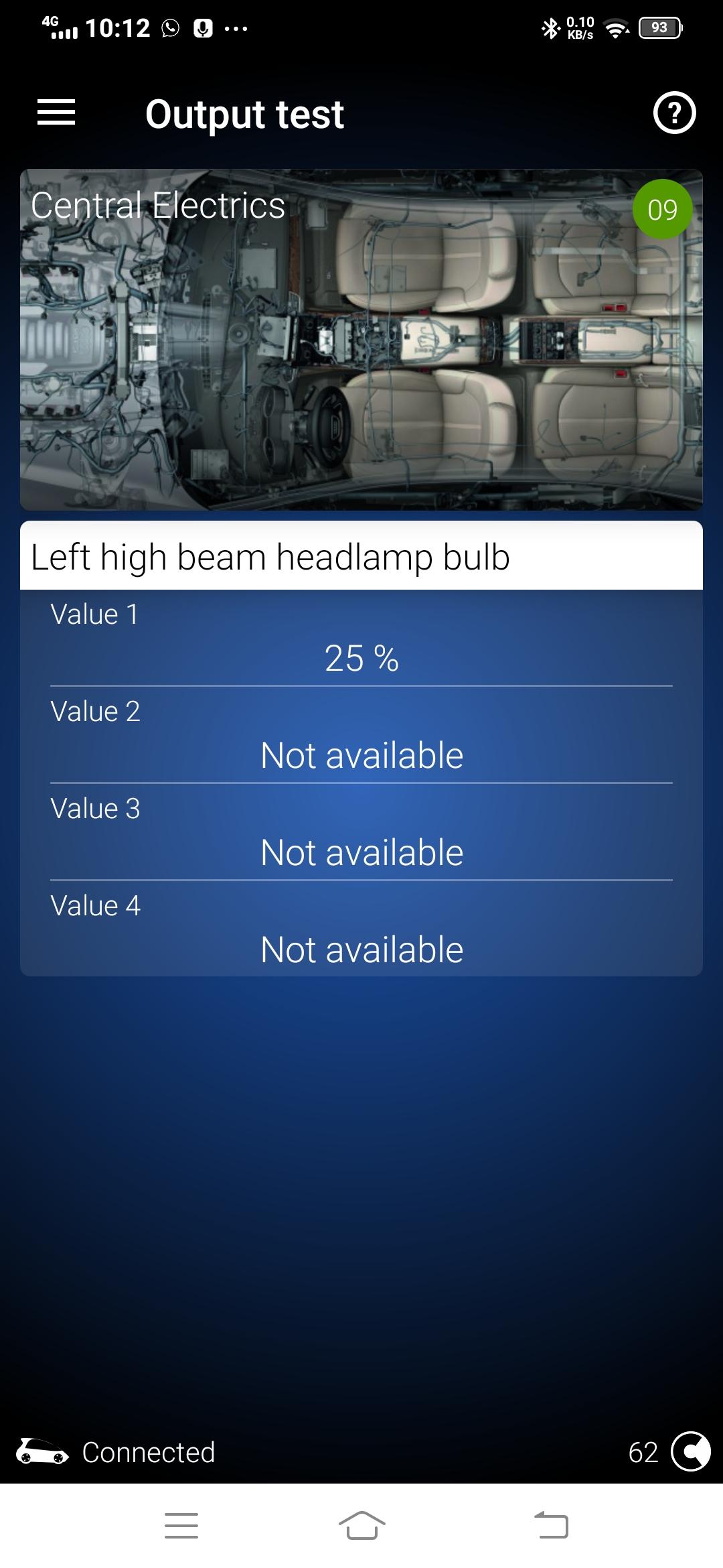

The LED headlights on my A6 C7 do not flash on to high beam when the stalk is pulled towards the steering column or switch to high beam when the stalk is pushed away. The blue headlight indicator icon does come up on the dash.

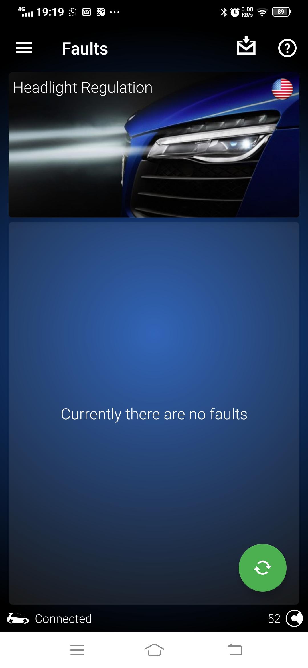

OBD11 comes up with no errors.

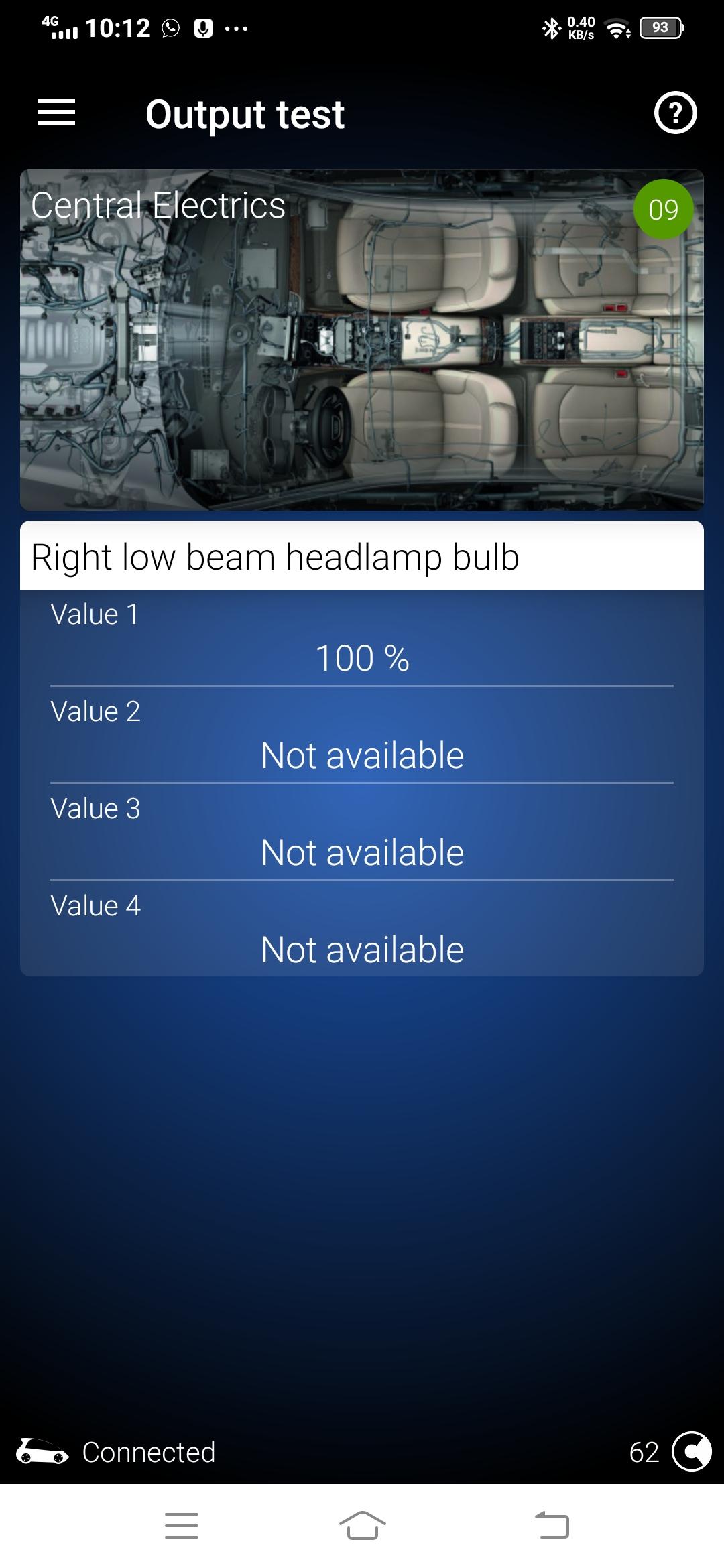

On OBD11 i went into Central Electrics and did an output test. The screenshots are below:
Any ideas on what might bethe problem? Thanks

Having seen the screenshots now that would have been my first question - if the lights at high beam are reporting they're only using 25% of expected output/load then is the system expecting a high watt Halogen bulb rather than LEDs...? Are they coded correctly? (Were they switched out from Halogen to LED and not re-coded correctly?)
But you have found the answer now - glad you got it sorted.
