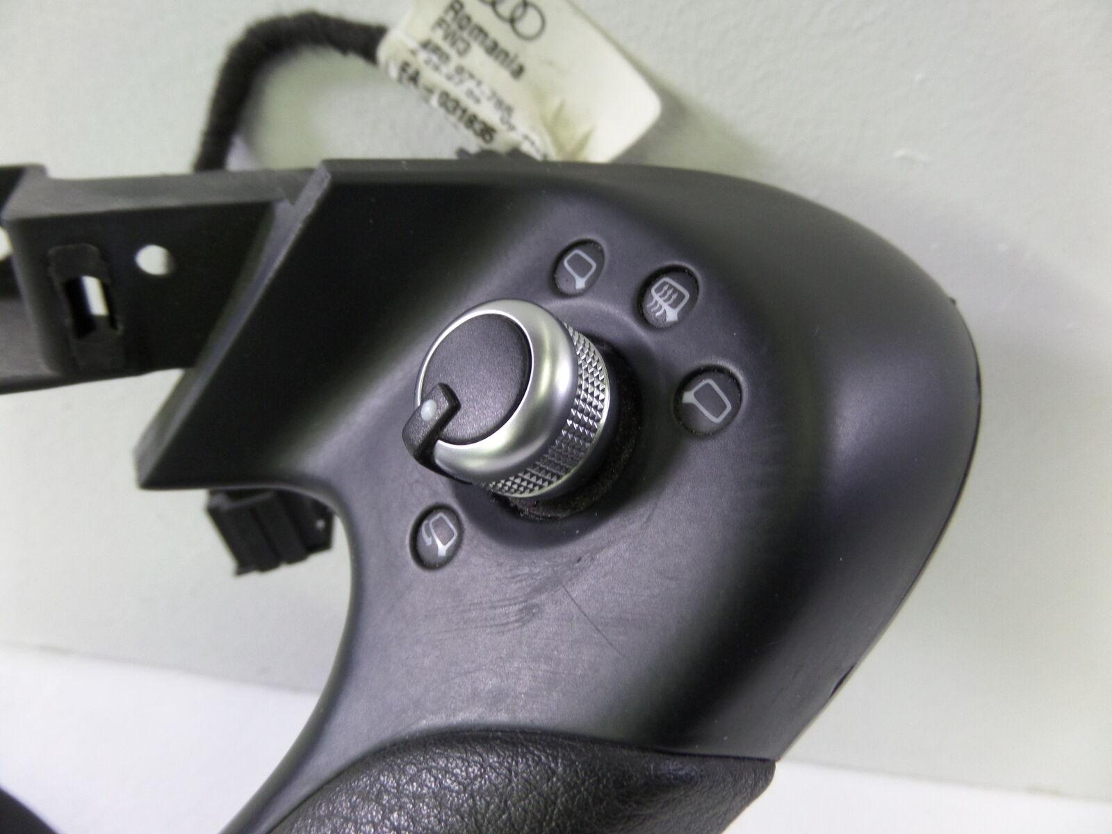

RoyC Posted June 14, 2022 Author Share Posted June 14, 2022 22 minutes ago, Steve Q said: I can't speak for the c6, but I know for the c5 you need a different wing mirror switch, the correct wiring harness and relay. I suspect the c6 will be similar to be honest I have auto dimming, heated, folding mirrors on my 2009 A6 C6 and it didn't work on my car. This is like my mirror switch. I enabled mirror in the green menu but it was not in the central locking menu on the MMi Quote Link to comment Share on other sites More sharing options...
RoyC Posted June 14, 2022 Author Share Posted June 14, 2022 1 hour ago, RoyC said: The switch is in the mirrors FOLDED position Quote Link to comment Share on other sites More sharing options...
Steve Q Posted June 14, 2022 Share Posted June 14, 2022 17 minutes ago, RoyC said: The switch is in the mirrors FOLDED position It might need more specific coding maybe. Or a relay. Quote Link to comment Share on other sites More sharing options...
