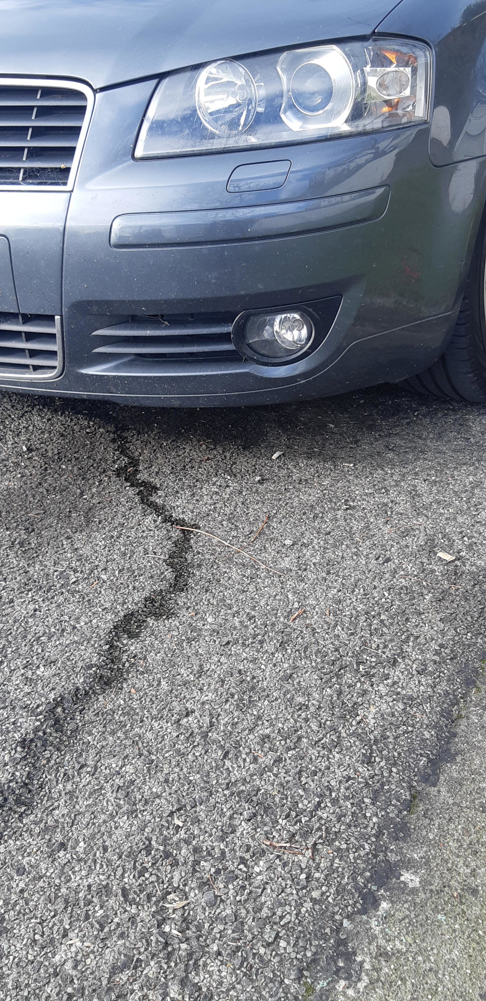

I have Audi A3 2.0l fsi 2004. Yesterday coolant start leaking badly..I managed return from trip using lot of water...100km I use 6 l water! See antifreeze ander my car
. Last night can't faund any leak..today drive car around town and no leaks.. turn air to cool from 24C inside car and leak start again..
Any one have idea why and where possible leak???

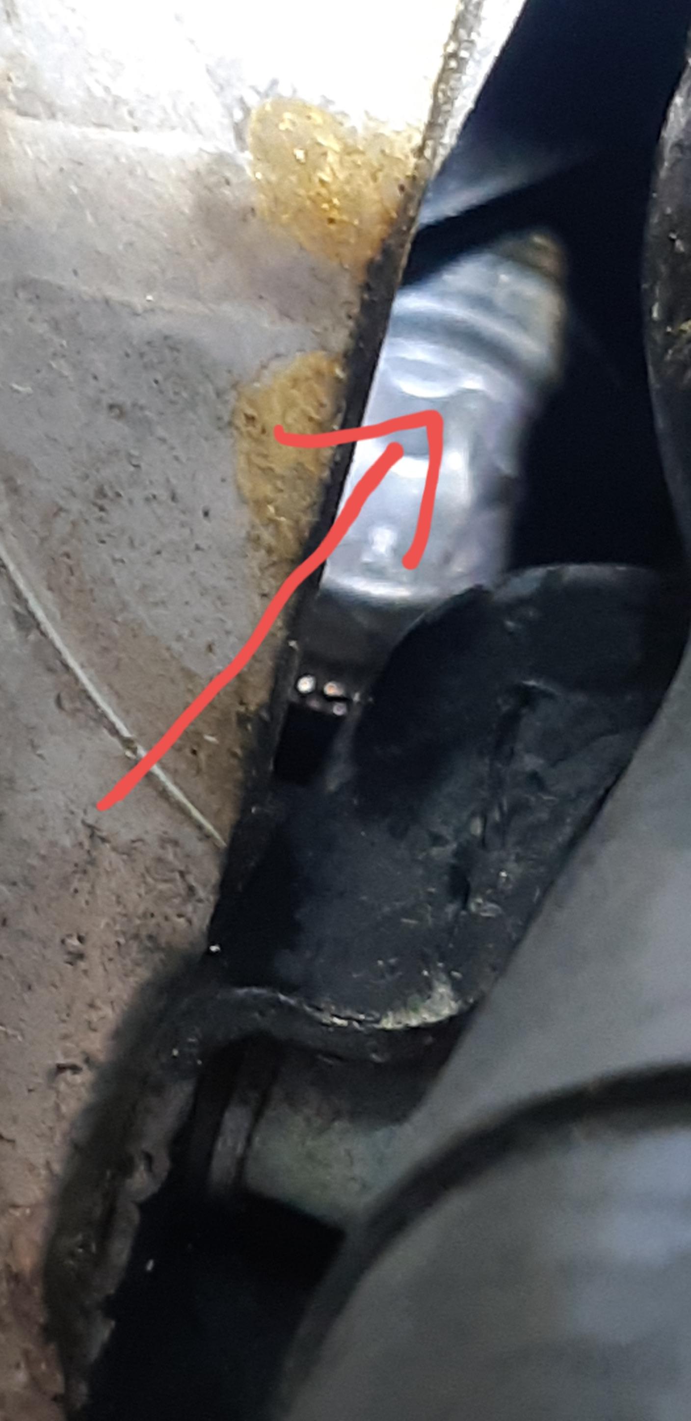

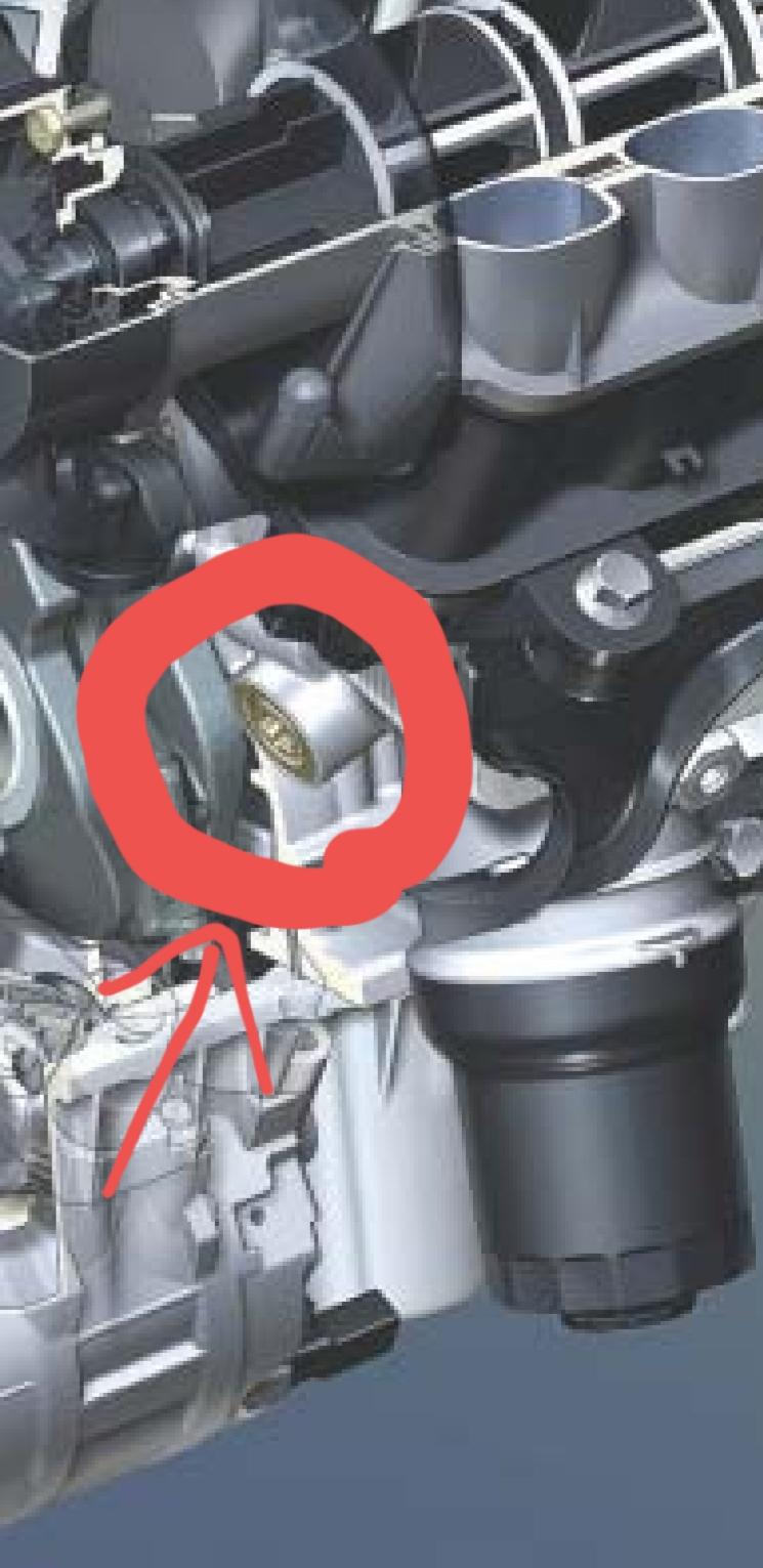

Found leak.  Any one tell me what is it? Just above oil filter on engine block..thermostat housing??Hollow Hex Plug

You don’t tell us what engine is in the car, but from the general description it could have been associated with the thermostat housing on certain petrol engines. From your photo - ?
