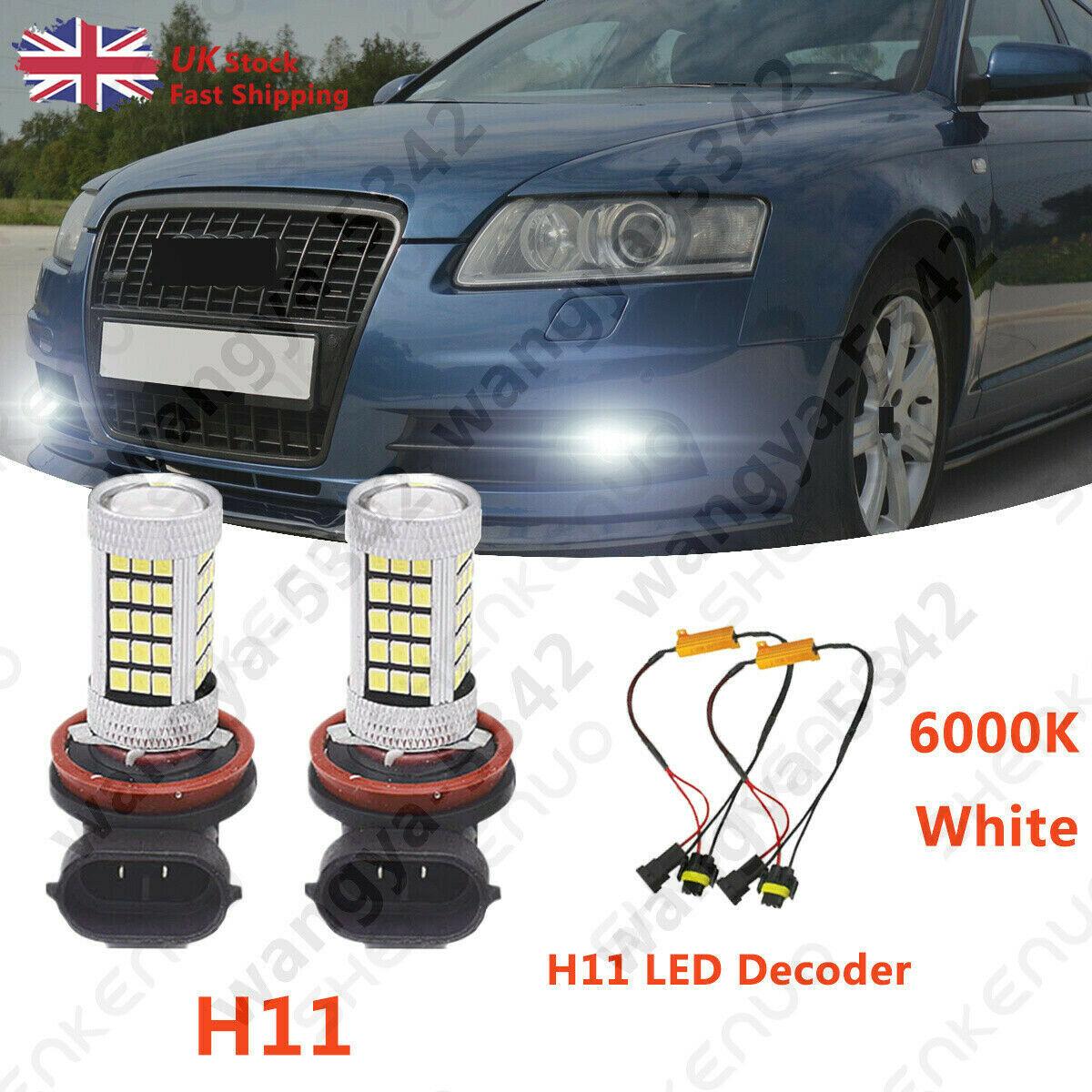

RoyC Posted June 25, 2022 Author Share Posted June 25, 2022 1 hour ago, RoyC said: I have replaced my H4 fog light bulbs with white LEDs, and of course I get an error on the dash. Has any one successfully done this with no errors ? Please, I'm useless at maths I'm going to give these a try. Quote Link to comment Share on other sites More sharing options...

RoyC Posted June 28, 2022 Author Share Posted June 28, 2022 1 hour ago, Steve Q said: Worth a shot. I'll let you know how it goes. I should have said H11 not H4. Quote Link to comment Share on other sites More sharing options...
Stevey Y Posted June 28, 2022 Share Posted June 28, 2022 6 hours ago, RoyC said: I'll let you know how it goes. I should have said H11 not H4. Hi Roy they should be fine as long as you have the decoder wires as well these are basically Canbus wires to fool the lighting control module into thinking they are standard bulbs, so as long as you either buy what you have or Canbus error free bulbs all will be well, its got nothing to do with maths. Steve. 1 Quote Link to comment Share on other sites More sharing options...
RoyC Posted July 1, 2022 Author Share Posted July 1, 2022 On 6/28/2022 at 1:25 PM, RoyC said: I'll let you know how it goes. I should have said H11 not H4. Well, I purchased the above LEDs and wires. Last weekend my son borrowed the firms diagnostic thingy, he reset my SRI, (that Audi said they couldn't reset after doing a service) and went through every thing else. I realized that the lights out warning for the fog lights was no longer coming on. Just to satisfy myself that it was still working, I disconnected the left foglight and to my delight the left fog light warning came on. BRILIANT. I now have two sets of LEDs and resistor cables that are not required. Quote Link to comment Share on other sites More sharing options...
Steve Q Posted July 2, 2022 Share Posted July 2, 2022 21 hours ago, RoyC said: Well, I purchased the above LEDs and wires. Last weekend my son borrowed the firms diagnostic thingy, he reset my SRI, (that Audi said they couldn't reset after doing a service) and went through every thing else. I realized that the lights out warning for the fog lights was no longer coming on. Just to satisfy myself that it was still working, I disconnected the left foglight and to my delight the left fog light warning came on. BRILIANT. I now have two sets of LEDs and resistor cables that are not required. Oh dear. What are you going to do now? 1 Quote Link to comment Share on other sites More sharing options...
RoyC Posted July 2, 2022 Author Share Posted July 2, 2022 2 hours ago, Steve Q said: Oh dear. What are you going to do now? I'm going to fit them. I just went on a run to my sons house (8 miles) there. He said that he did a dash reset. When I started up to come home the bulb out lights came back on. Quote Link to comment Share on other sites More sharing options...
RoyC Posted July 3, 2022 Author Share Posted July 3, 2022 18 hours ago, RoyC said: I'm going to fit them. I just went on a run to my sons house (8 miles) there. He said that he did a dash reset. When I started up to come home the bulb out lights came back on. Well, got them fitted and NO ERROR LIGHTS. woo woo. 1 Quote Link to comment Share on other sites More sharing options...
