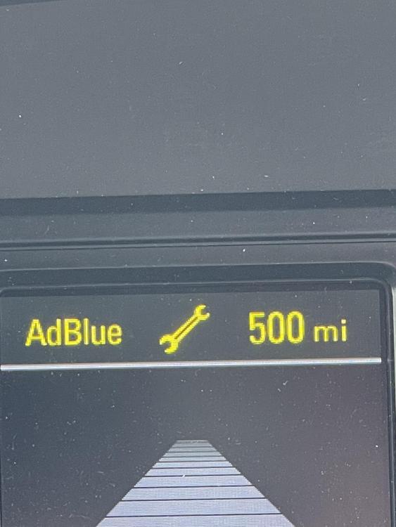

Denloon Posted June 27, 2022 Posted June 27, 2022 Hi I’m new to Audi and this warning lamp came on my dash. I topped up and it only held about 8L thinking it was nearly empty since the light came on my question is will this need booked into garage to clear the warning off my dash as it’s not going off since topping up thanks
Stevey Y Posted June 27, 2022 Posted June 27, 2022 53 minutes ago, Denloon said: Hi I’m new to Audi and this warning lamp came on my dash. I topped up and it only held about 8L thinking it was nearly empty since the light came on my question is will this need booked into garage to clear the warning off my dash as it’s not going off since topping up thanks Hi I ask a stupid question but have you driven the car a lot since you topped up as sometimes my car does this and it has to do a couple of drive cycles before the light goes out, other than that it could well involve a trip to the garage to reset the level sensor. Steve.
Denloon Posted June 27, 2022 Author Posted June 27, 2022 40 minutes ago, Stevey Y said: Hi I ask a stupid question but have you driven the car a lot since you topped up as sometimes my car does this and it has to do a couple of drive cycles before the light goes out, other than that it could well involve a trip to the garage to reset the level sensor. Steve. No just topped up this morning then drove home after work. The reason I’m thinking it’s a garage job is the spanner symbol and not the fill up symbol
Stevey Y Posted June 27, 2022 Posted June 27, 2022 5 minutes ago, Denloon said: No just topped up this morning then drove home after work. The reason I’m thinking it’s a garage job is the spanner symbol and not the fill up symbol Hi you are supposed to drive the car for at least ten mins after filling the tank but that symbol is on because it has gone a bit stupid this is frequent and can be cured by doing an adblue sensor then sensor lock using VCDS. Steve
Denloon Posted June 27, 2022 Author Posted June 27, 2022 6 minutes ago, Stevey Y said: How do you mean an adblue sensor then sensor lock using VCDS. how is this done
Stevey Y Posted June 27, 2022 Posted June 27, 2022 6 minutes ago, Denloon said: 14 minutes ago, Stevey Y said: How do you mean an adblue sensor then sensor lock using VCDS. how is this done Hi you use VCDS diagnostic platform, go to engine and then select basic settings scroll down the options until you reach SCR reset level reset press go let it complete its task then press done then go back to the dropdown menu on basic settings and select SCR lock press go let that finish then press done and go back to main menu and shut the program down. Steve.
