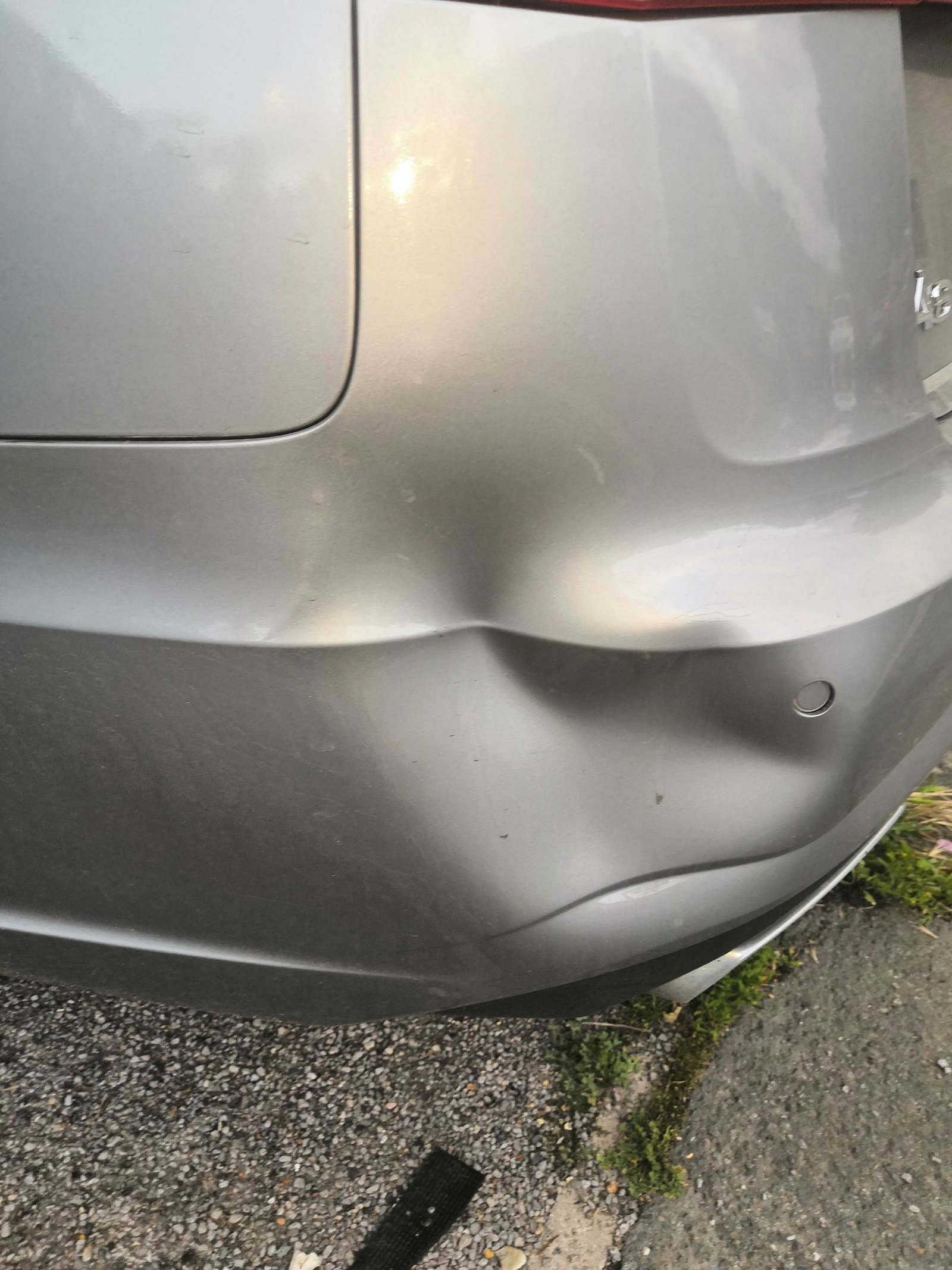

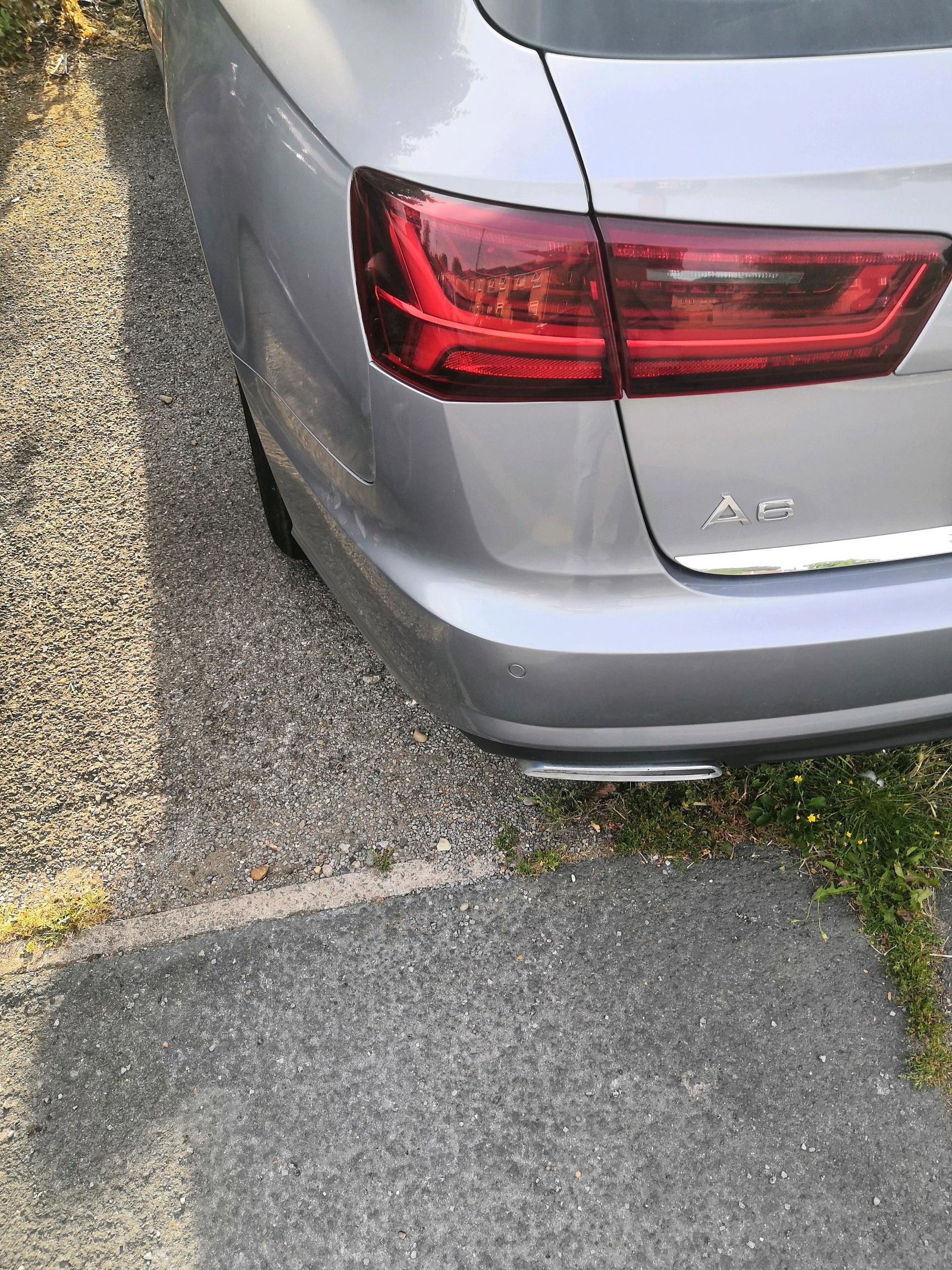

Stevey Y Posted July 11, 2022 Share Posted July 11, 2022 32 minutes ago, Brizzle said: Is having a new sill a big job to do? Thanks for you reply Hi you won't need a new sill as if its plastic they just heat it with a hot air gun whilst pushing with something like a screwdriver handle from the other side and it pops out, ABS will always want to go back to the shape it was moulded to, it might need a skim of filler and definitely some paint. Steve. 1 Quote Link to comment Share on other sites More sharing options...

Stevey Y Posted July 11, 2022 Share Posted July 11, 2022 Just now, Brizzle said: Ok cheers man, I may give it a try if it’s really that simple 1 minute ago, Brizzle said: Ok cheers man, I may give it a try if it’s really that simple Hi please see the pics posted of my bumper just don't get the gun to close and keep it moving otherwise you will set light to the plastic best engage a suitable assistant to gently massage the other side when heating, BTW I DID NOT DO THE FILLING OR SPRAYING after, but in saying that yours is a straight edge which any competent spray shop should be able to do for a few quid as a side job. 3 Quote Link to comment Share on other sites More sharing options...
