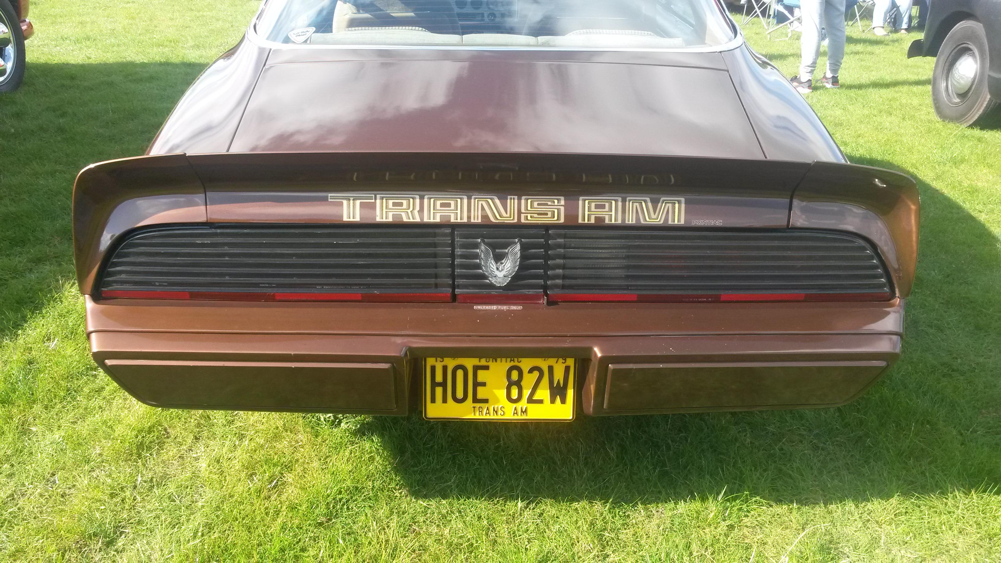

When I was working I used to own a Trans-Am and when I changed it's oil I would use it to do an oil change on my van, haha.

Ha! Nothing wrong with a bit of recycling. 😉 Take it the van wasn't too fussed! They're big lumps those Trans-Ams. Nice cars.

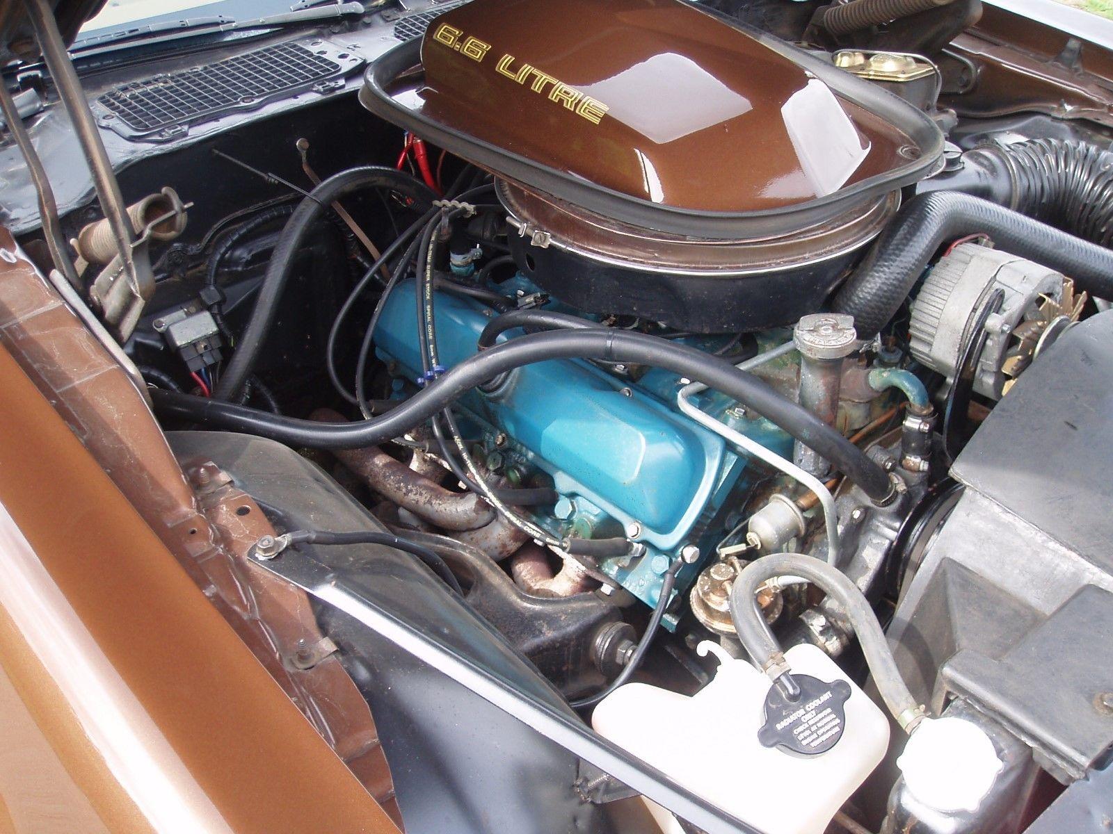

Now that is an absolute weapon! Beautiful machine. Some sound out of that >'ll bet, though i doubt it would have been easy on the fuel. What made you sell it, if you don't mind me asking? Did you ever replace it was something else?

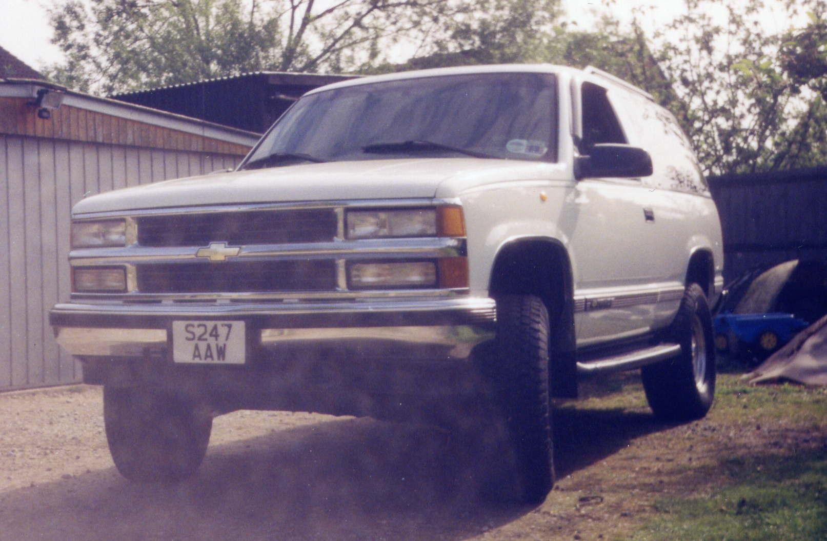

Ah! Chevy Tahoe. A 4x4 man eh? Very capable looking beast that. Ha, only a 5.8.. A big ol' lump all the same. I work in Holland, they're dead into their American imports so I've seen a few of these kicking about.

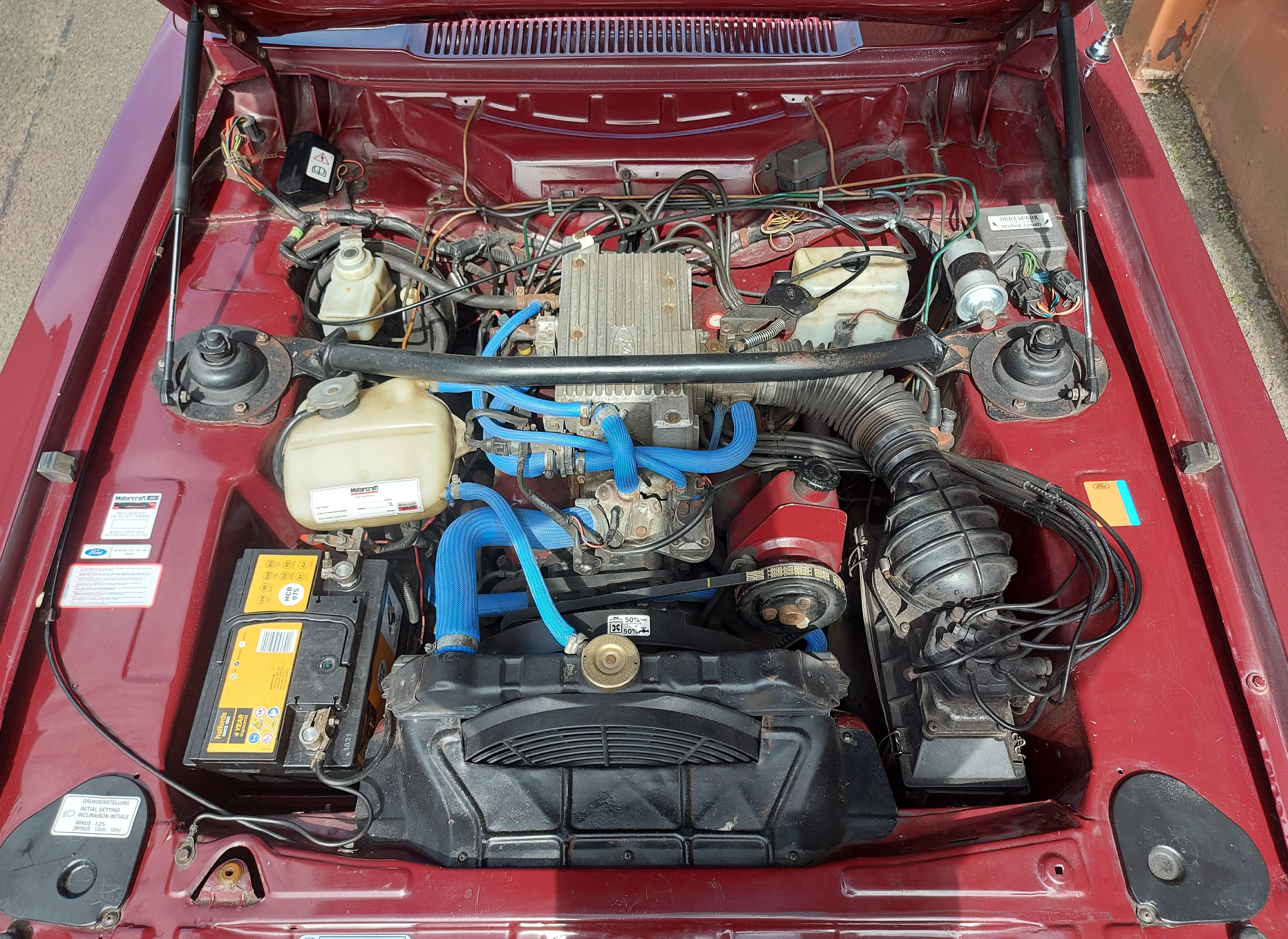

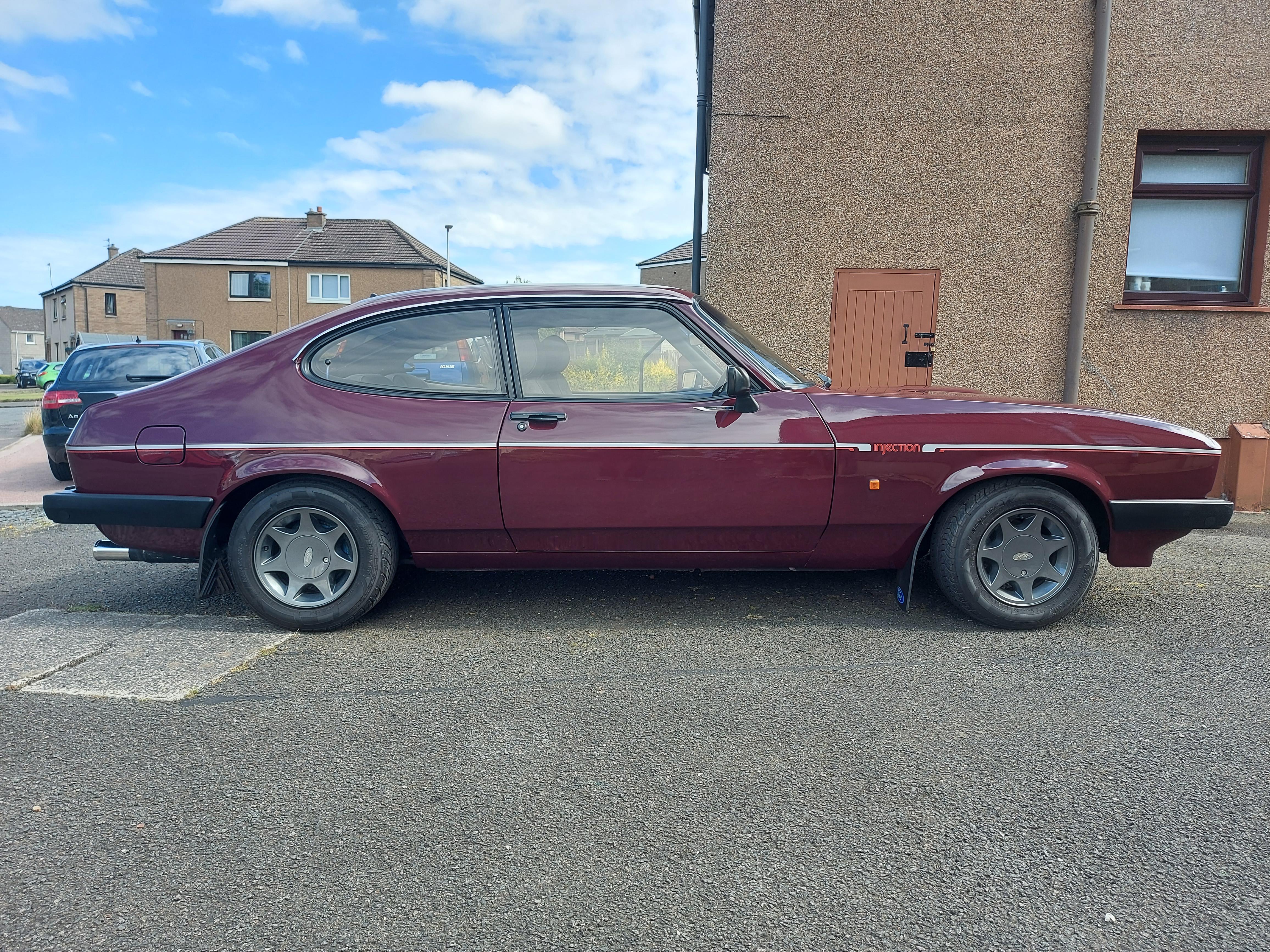

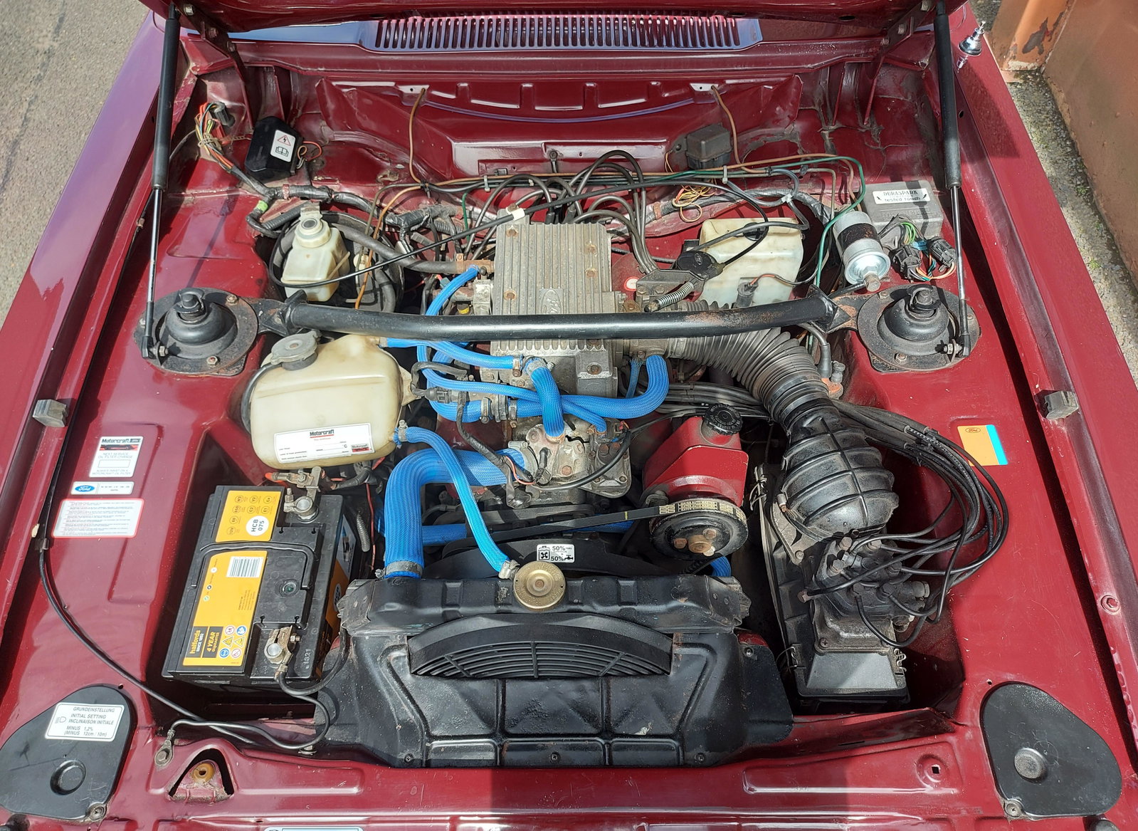

My 'other car' is a wee bit more modest. And is short a couple cylinders. 😉
Edited by SwaitsySG

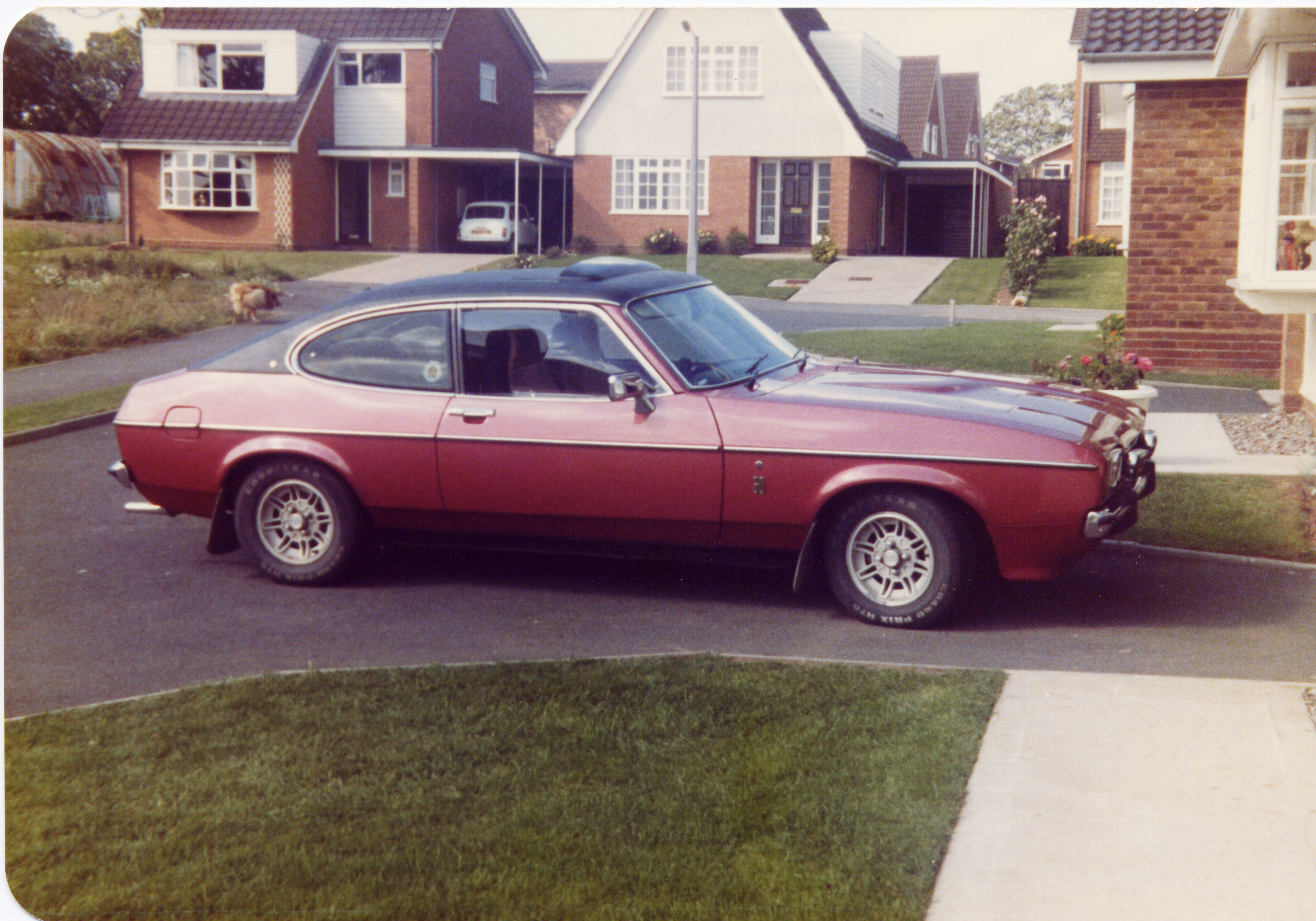

A Capri, love em.
Had a couple of those as well.
I traded a 3L Ghia Capri in for the Trany.
also had a 3000 E
Yes! Now we're talking. That's a lovely mk2 Ghia. Plenty of poke. Never owned any of the 3 litres before. To be honest this is my first Injection, I had Lasers before that. You must have really loved that Trans-Am! And a mk1 too. That looks like it was a while back. They can fetch crazy money now, closest I've ever got is the model on the living room bookcase 🤣
Admittedly the injection isn't entirely stock from a cosmetic standpoint, but I think it's still a looker. Not bad for an old Ford pushing 40. I've a bit of bodywork to do to it over the winter, nothing too major. The A6 does all the parts running.

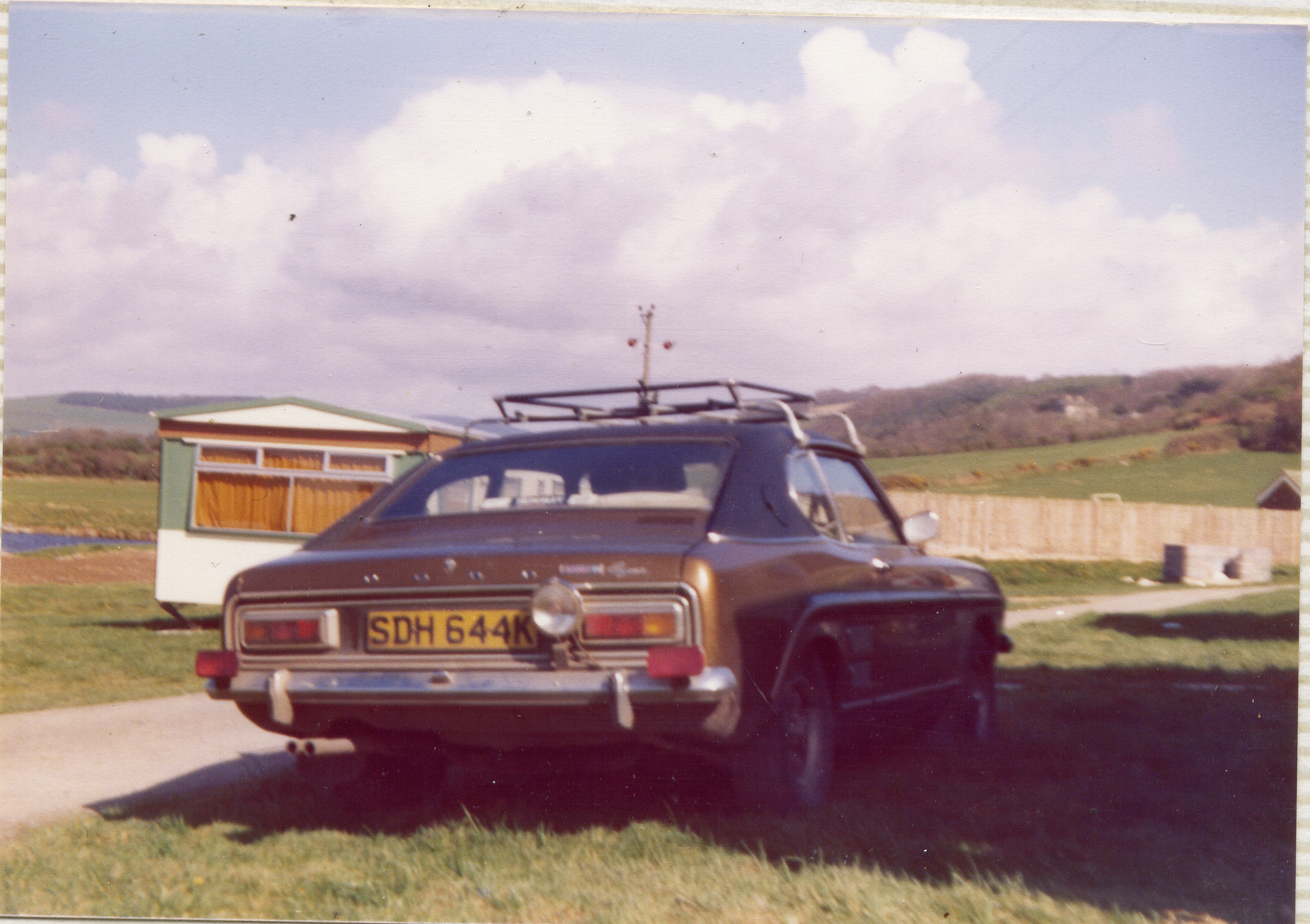

K reg 1972, Tawney brown metallic, all black interior. Had the engine rebuilt because the oil pump drive sheered off. Always used to run it on five star petrol, 6/- gallon. (30p)

The Injection has a new all black interior with light grey Recaro's. I've been running it on Esso Supreme and Shell V Power.

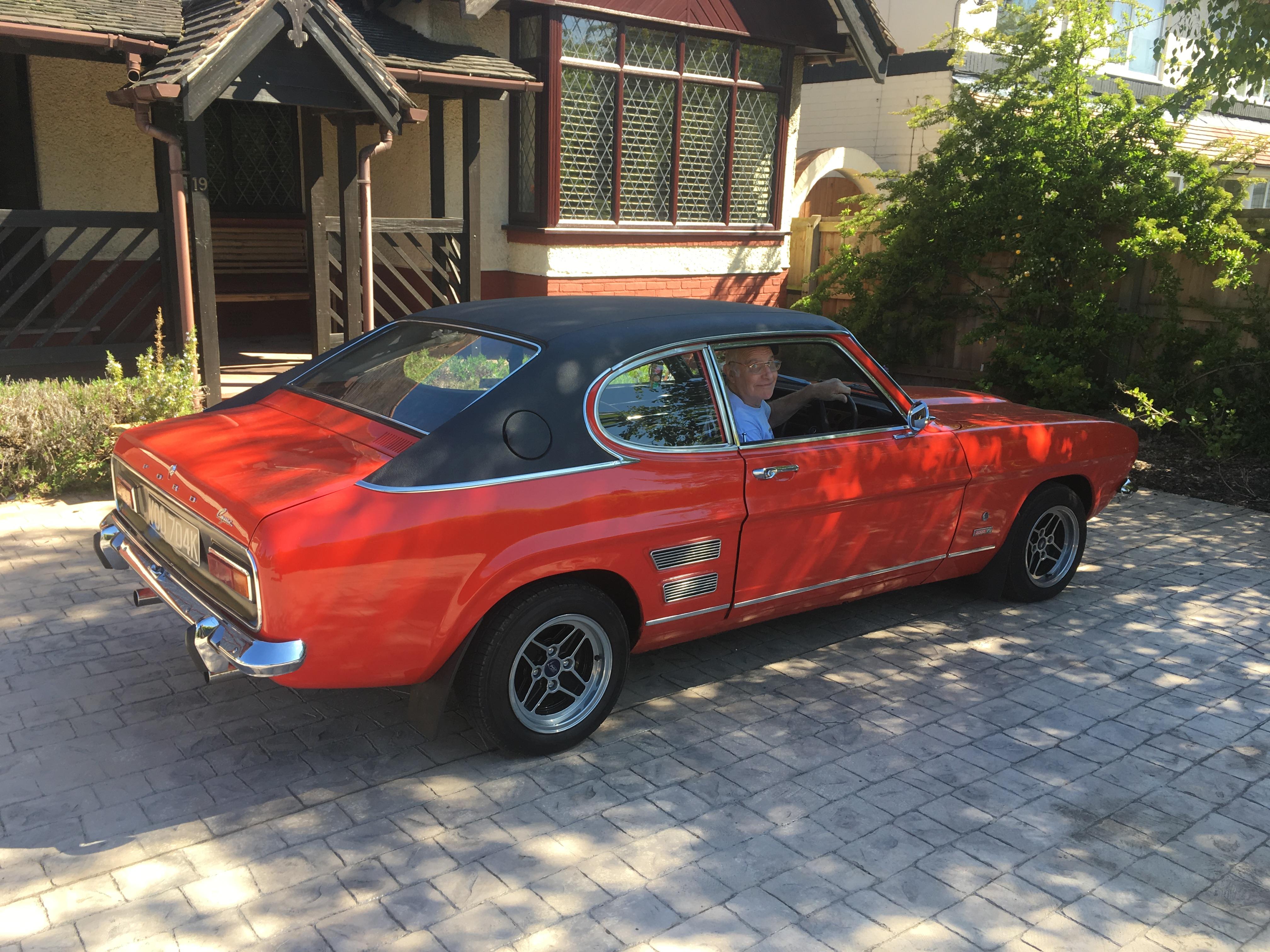

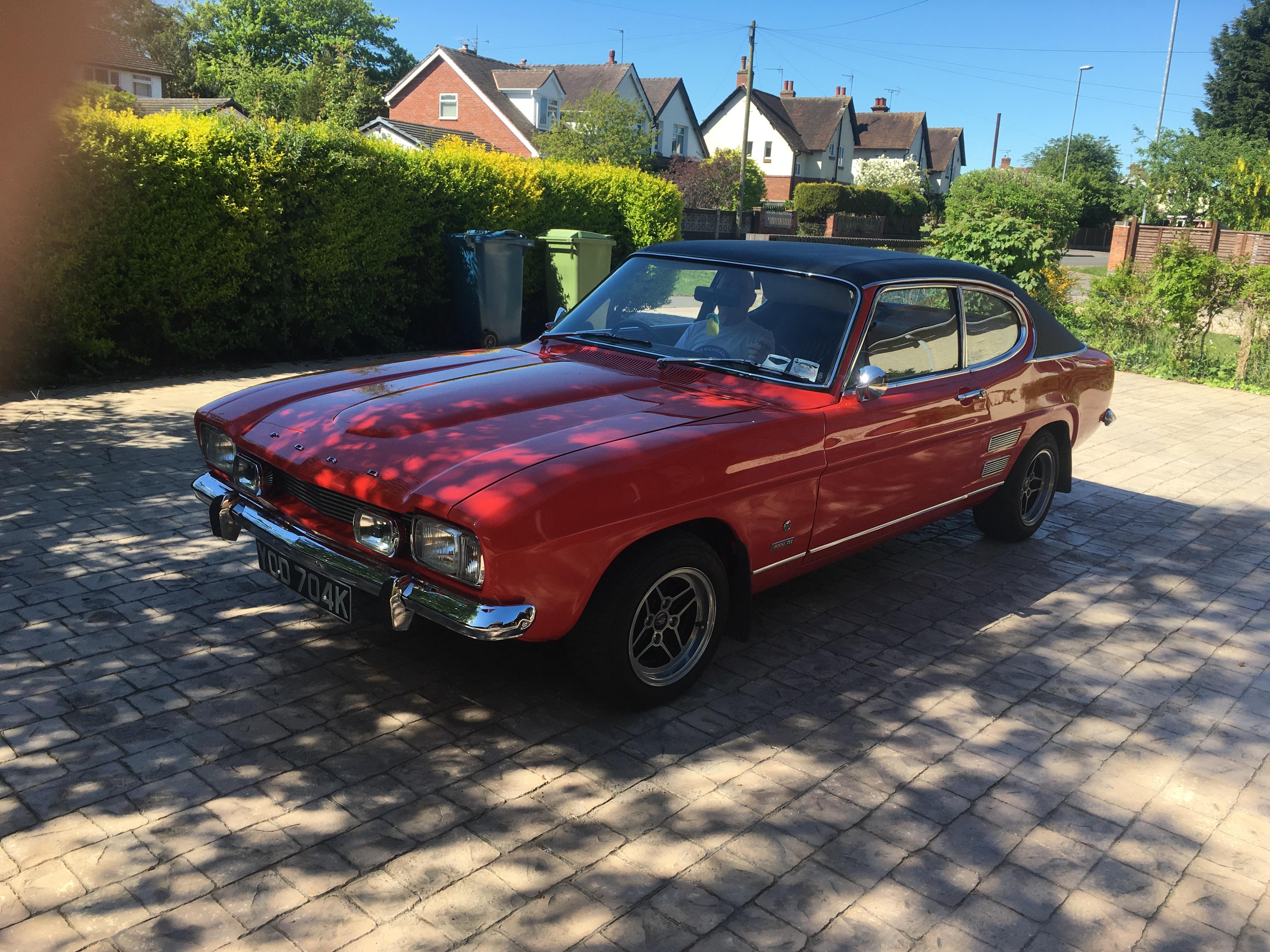

A couple of months ago my son was test driving a Capri 3000GT from work and came to show me.
That's me in the car.
Really clean looking car Roy. Nice set of rs4's on it too. I might get a set for mine as I've never been as keen on the 7's. You said he was test driving it from work? I'm in the wrong job! 🤣

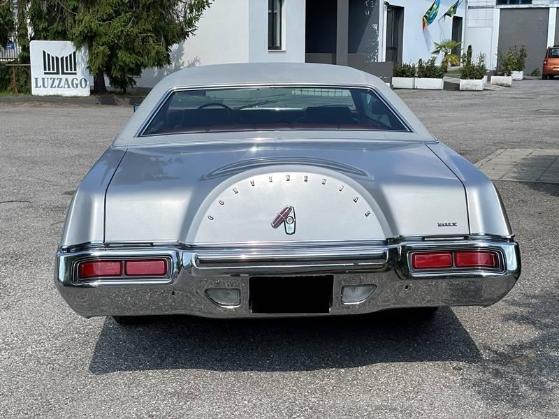

He's in charge of an accident repair company, That Capri belongs to a chap who has a classic car company who has all of his cars done at my sons place.

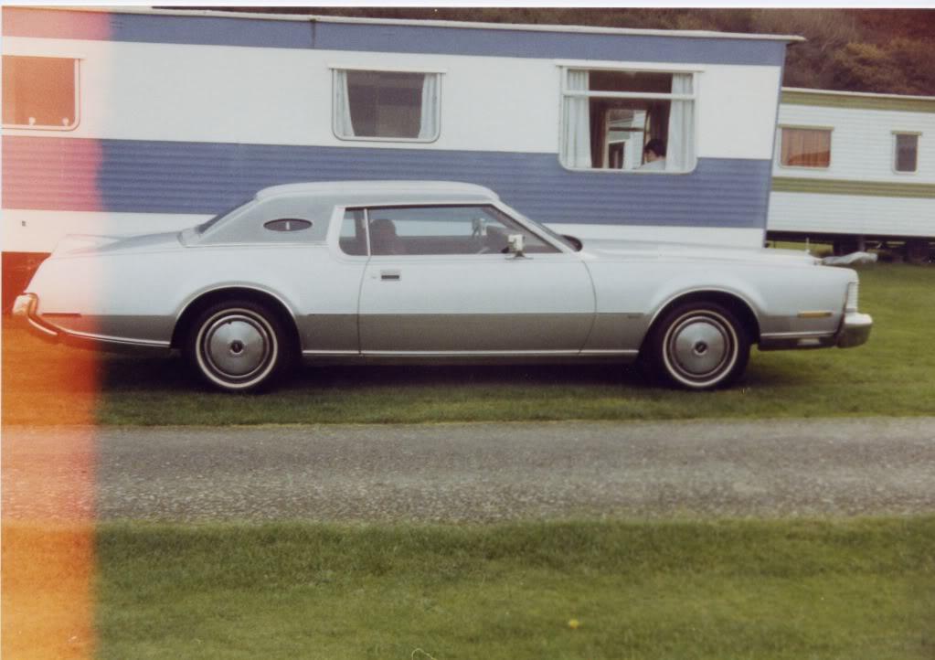

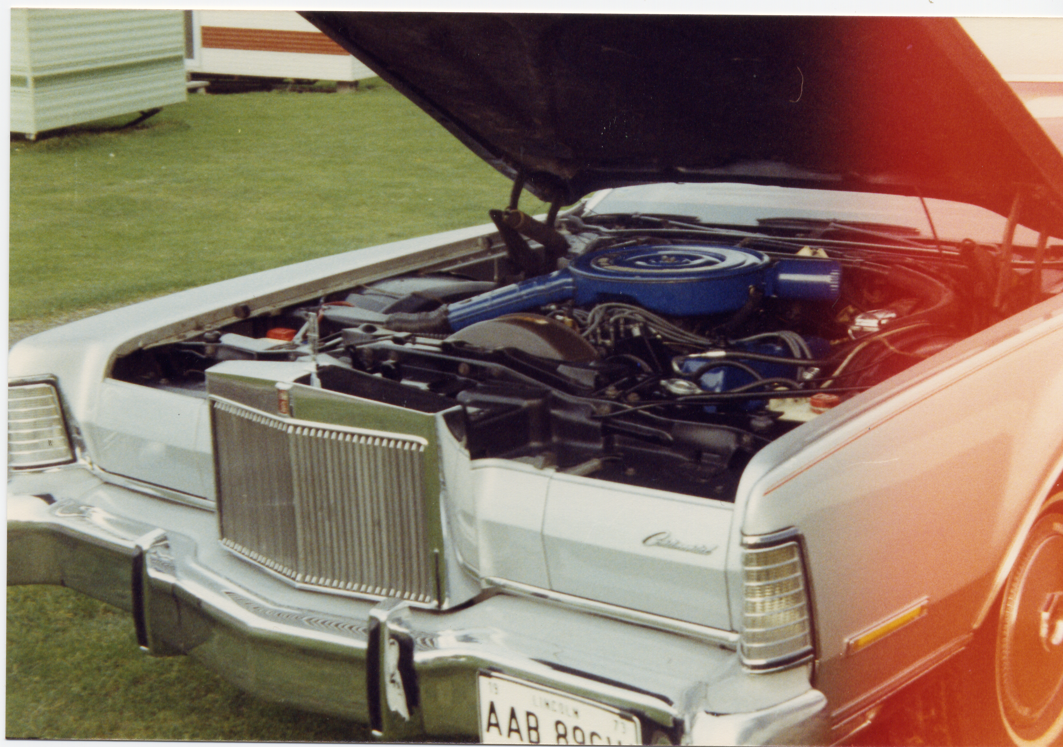

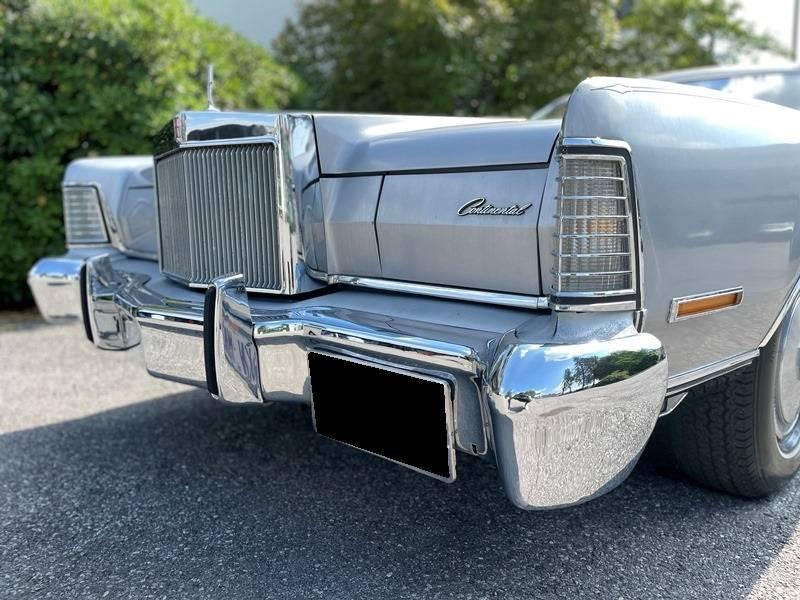

You say your not keen on 70s cars,
This was my 1972 Lincoln Continental Mk 4. Only 7.6 L
