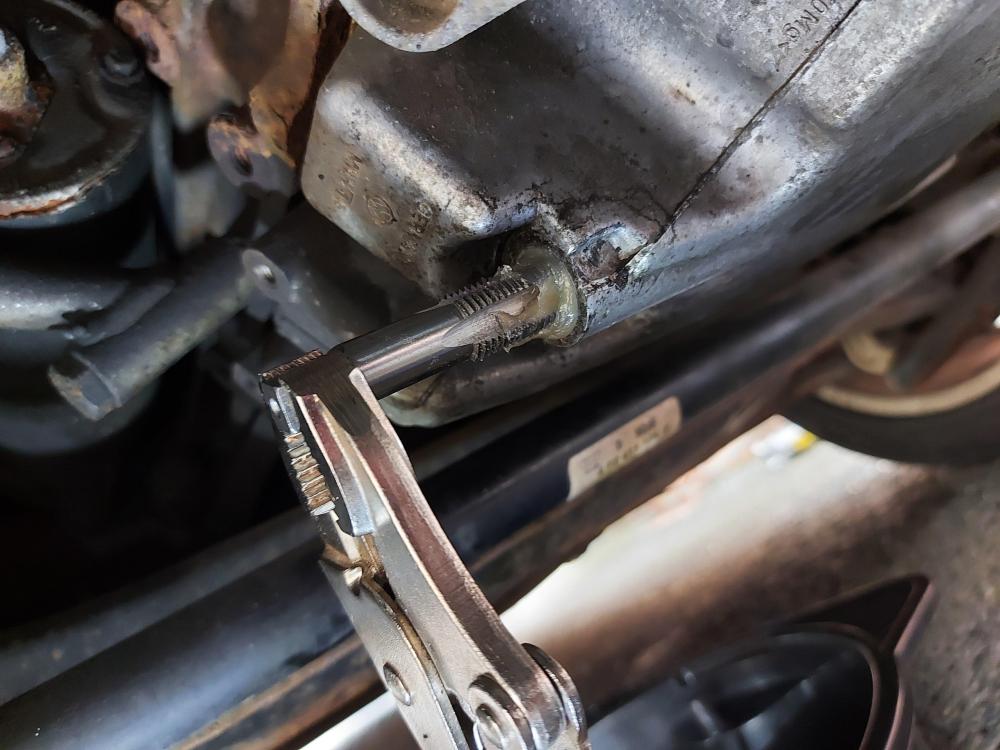

Sump drain hole stripped

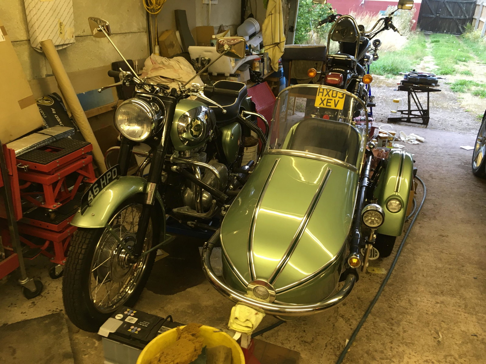

Here are my winter projects.
VIDEO

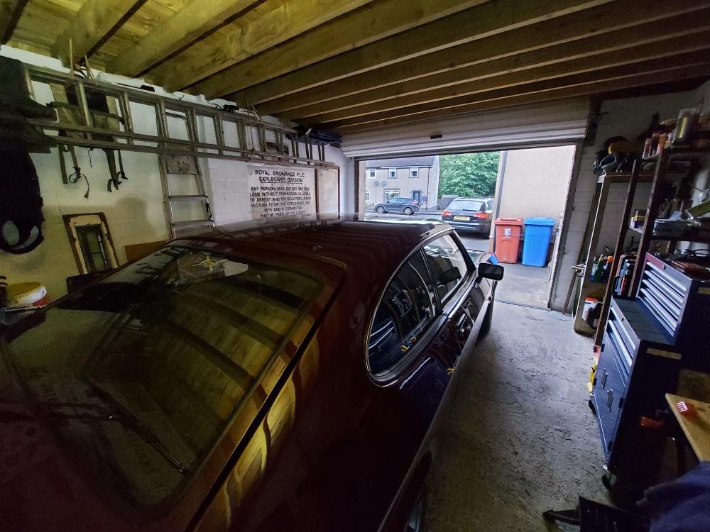

Ooft! That would be heaven to me. A lot of nice machines there, actually a bit jealous of your A6, it looks lovely. And your bikes. (The father-in-law is the bike man, I'll have to send them over to him). And the size of the workshop..
My setup is a little more humble. One at a time unfortunately.

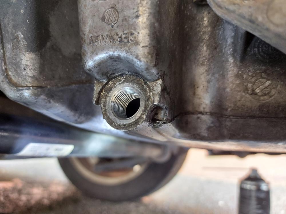

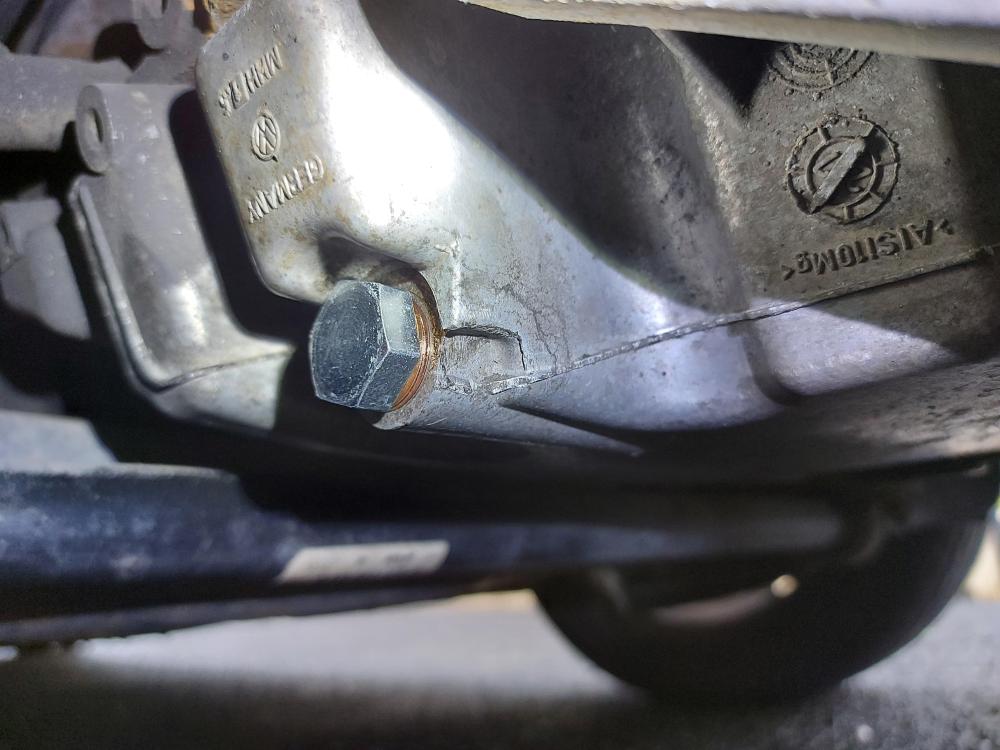

In any case, I've completed the sump repair. Thread retapped, oversized plug in place and properly torqued. So far so good. Not done many miles but we'll keep an eye on it, see how it goes. I added two crush washers to the plug as they seem really thin.
A job well done there.
No wonder it was leaking, ther's no thread left.

Nothing wrong with that setup.
Keeps things dry and out of the weather while working.
Nothing worse than working on the driveway in the rain and snow.

Just thought I'd post a quick update on this. What are we, 6 months later roughly? Racked up around 4000 miles since the repair. New plug is right where I left it, no leaks. Guess that's about as good as you could ask for.
