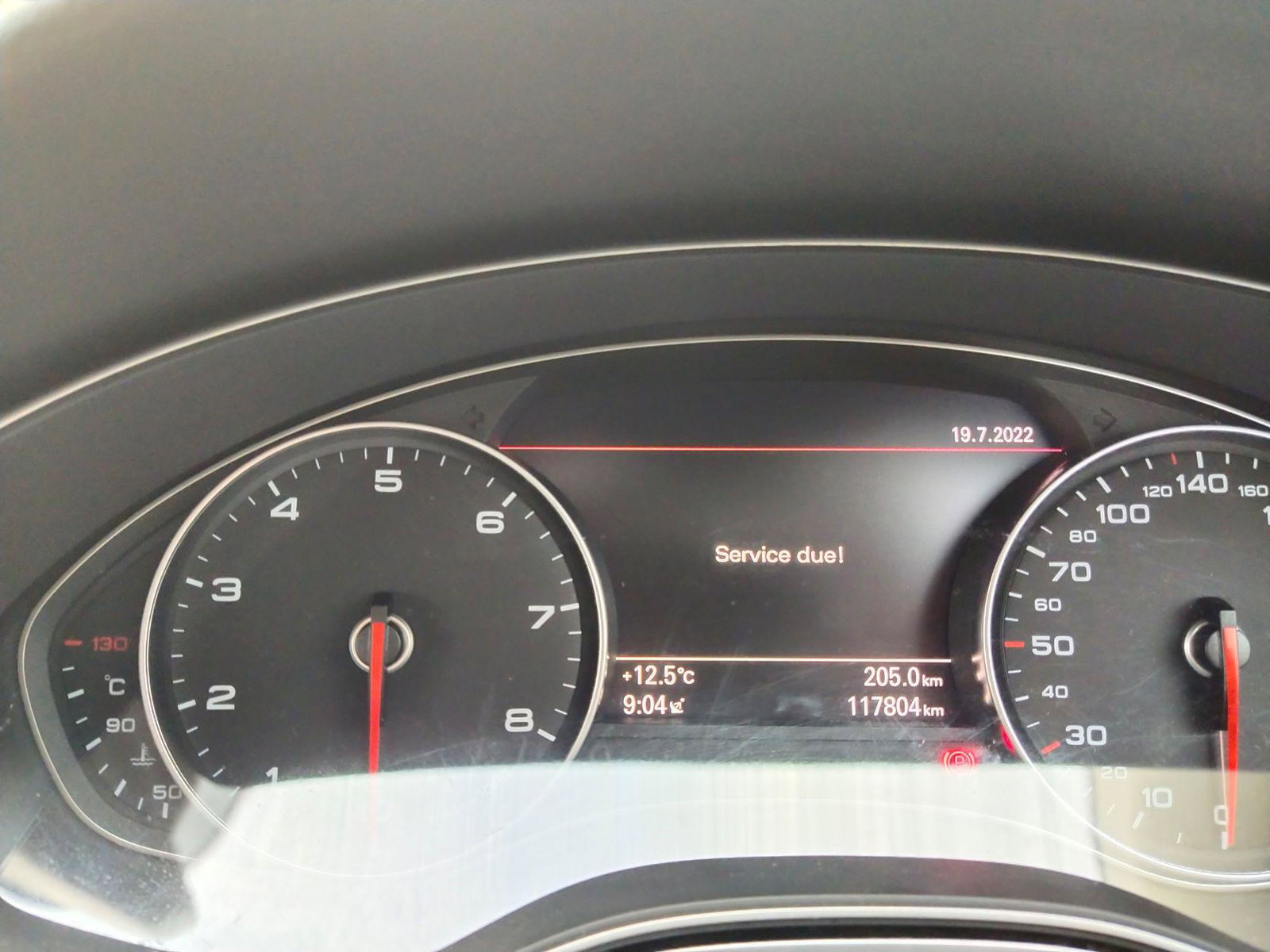

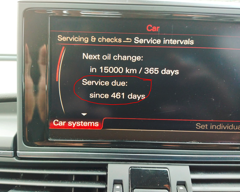

yay 6 Posted July 18, 2022 Posted July 18, 2022 How do I get rid of the "Service due" message on the dash and the "since 461 days" message on the screen? I have OBD11 Pro in case that needs to be used. many thanks.
ThomasG Posted July 19, 2022 Posted July 19, 2022 Have you serviced the car? Oil and filter at least? If so, you go to Workshop in the app, you should be able to reset. 2
Brizzle Posted July 19, 2022 Posted July 19, 2022 You just go into it and reset it from the car system But make sure you do service it, these cars need it
yay 6 Posted July 20, 2022 Author Posted July 20, 2022 I have changed the oil and filter. I had used the car system to reset the oil change interval, but the messages as shown in my previous post persisted. Anyway, as Thomas suggested, I used the "Workshop" app and now the service due message is gone 😀. Thanks for the assistance, guys!!
