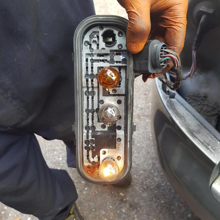

I need the aforementioned bulb holder and according to Audi it's an obsolete part.
Does anyone know where i can get one pleas

Hi get the part number off the old unit and go on eBay I am sure I have seen them before for about £80, the rubber seal claps out with age and lets water in, if you get a new unit treat the seal to a generous helping off silicone grease that will stop it doing it again.
