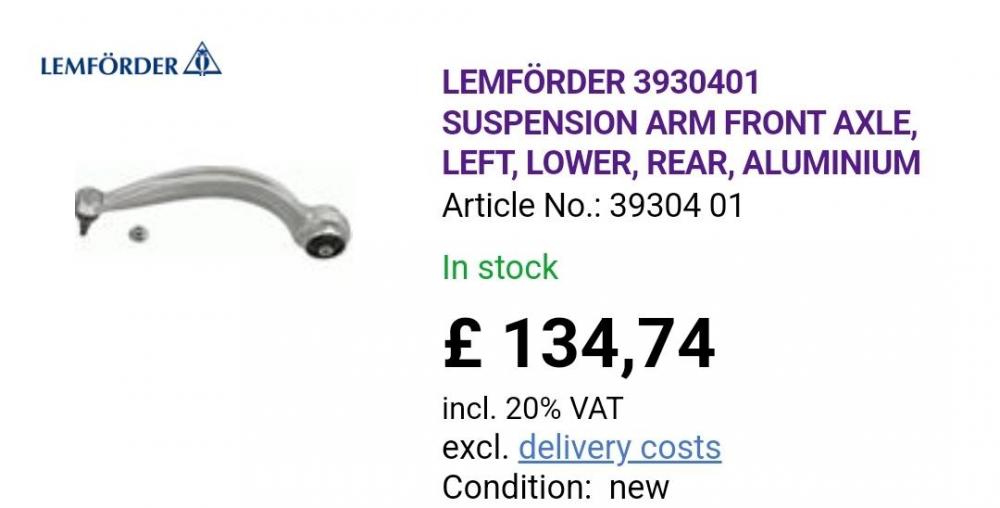

Pappa583 Posted July 24, 2022 Author Posted July 24, 2022 10 hours ago, Steve Q said: Banana bushings isn't a term I've heard of either 🤔 where on the car are they? Says on the report both front banana bushings, I'm presuming it's just a pair of arms on the suspension struts but google doesn't return anything when looking for banana bushings This looks a bit like a banana 🤔, gonna give them a call tomorrow as £260 for both parts is way off their quoted £800 for the work? Unless genuine audi part is £300+ each for parts. This is the most expensive on autodoc site
Magnet Posted July 24, 2022 Posted July 24, 2022 Hello Paul, Your ‘Autodoc’ part would seem to explain the term to me, but two things I would do before proceeding to get these changed:- Get another garage ( MOT station would be great), to check these out for the current severity of the issue. Appreciating these are heavy vehicles, but 2016 does seem a bit premature for this issue, unless it has covered a higher than average mileage and/or has been frequently used over rough ground. Autodoc? Lemforder are good - Autodoc prices?? Have you tried Car Parts in Motion? I’ve used these quite a few times (no connection) and found their pricing to be very competitive. I’ve used Febi Bilstein parts to good effect, so these could be an alternative. Main dealer at discount? You could try Audi Parts Direct at Cardiff. Hope some of this might help. Kind regards, Gareth.

Stevey Y Posted July 24, 2022 Posted July 24, 2022 7 hours ago, Pappa583 said: I've had a look and I can't see anything obvious but that's just me, there are a few parts look like a banana 🤭.... wouldve thought it would have a proper name, find out tomorrow.... wondering if its this as its the only thing I can see which is big enough to warrent the cost? Hi I think the guy is trying to invent some very profitable work and as suggested I would definitely be seeking a second opinion as its the inner bush that normally goes and from the last picture yours looks MINT, it also looks like someone has sprayed release agent on to the ball joint rubbers so they appear to be leaking, also there are a myriad of poly bush kits available a lot cheaper to cure the problem you don't actually have. Steve.
Stevey Y Posted July 24, 2022 Posted July 24, 2022 Just now, Stevey Y said: Hi I think the guy is trying to invent some very profitable work and as suggested I would definitely be seeking a second opinion as its the inner bush that normally goes and from the last picture yours looks MINT, it also looks like someone has sprayed release agent on to the ball joint rubbers so they appear to be leaking, also there are a myriad of poly bush kits available a lot cheaper to cure the problem you don't actually have. Steve. BTW they are called a lower control arm.
Pappa583 Posted July 25, 2022 Author Posted July 25, 2022 13 hours ago, Stevey Y said: BTW they are called a lower control arm. Just spoken to garage and it's not the lower control arm that's got the fault it's one of the upper arms, they just noticed its started to "part"? When I changed the discs i smothered everything with grease and was hoping that could have been it but no, they did notice I'd greased the rubbers but also identified this upper (banana) arm on both sides.... 😳.
