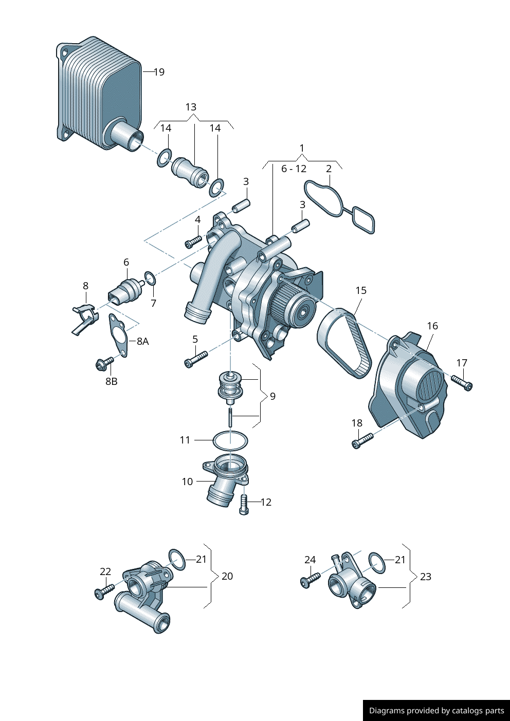

Craig2.0tquattro Posted July 24, 2022 Posted July 24, 2022 Hi guy's hope all safe and well. Our 2009 a3 2.0t (ea888) quattro seems to be loosing a small amount of coolant over a week or so. I've noticed a small puddle on top of the gearbox which I assume is coming from the thermostat housing or pipework. But I can't feel any wetness directly above the gearbox. Maybe only leaks when cooled down? Is this a common area for leaks does anyone know before I start tearing it down? All the best.

Craig2.0tquattro Posted August 11, 2022 Author Posted August 11, 2022 Yes mate It was just what I thought, the water outlet flange hose connector piece that bolts to the side of the cylinder head. O ring was leaking slightly. It was brittle as hell broke off plastic with hose 🙄
