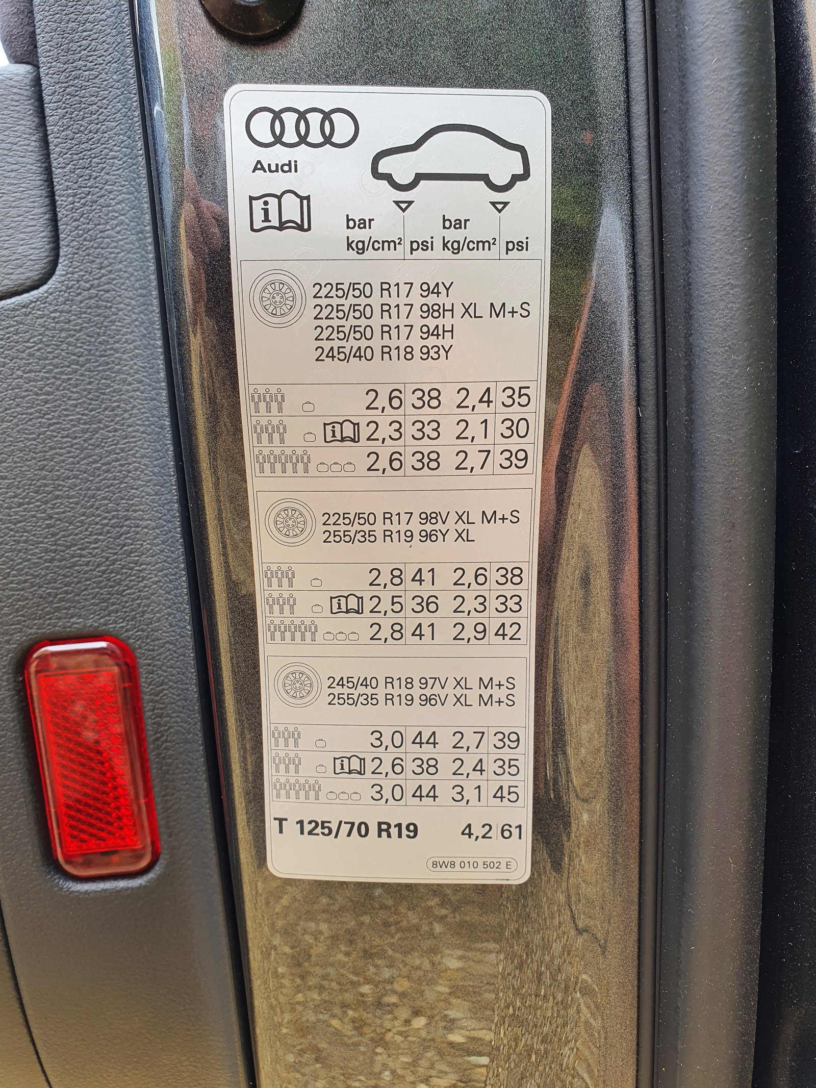

@RoyC Here's the label from my A5
I've noticed since running the pressures at 44 and 39 psi for the 245/40 R18 97V (I have 97Y fitted) over 6 months the tyres are wearing preferentially around the centre. I realise this will happen if over inflated, so I've checked pressure with a second and third gauge.
Have you noticed this?
