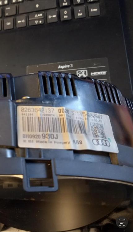

Thanks again, The instrument cluster would need to have the same dial values for example top speed and revs matching the orig’ but I am wondering if I can swap from other models for example the avante has a similar design, same values and similar parts number 8E 0920 as the original 8H 0920.
Hi as long as it looks identical to the original and all the plug parts are the same the letter in the part number is for the year produced, similar won't work it has to look the same but will still need coding to the body control.
