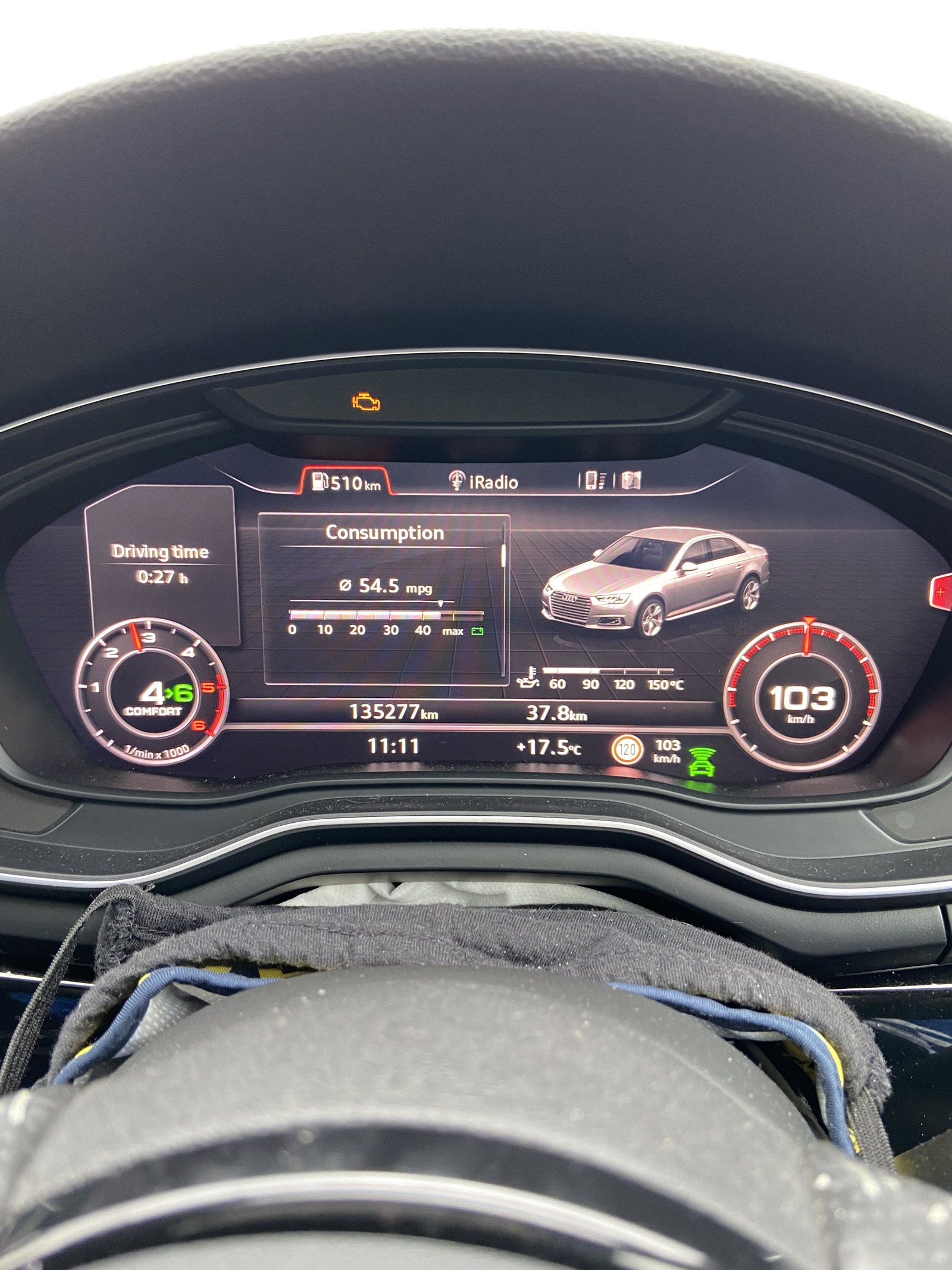

Paddy M Posted August 1, 2022 Share Posted August 1, 2022 My fan has been coming on regularly over the past few months. I have a short commute to work each day (10miles) but drive my car on the motorway for 3hrs every weekend as I stay at my girlfriends. The engine light came on and the computer said it’s DPF issues. I’m not sure what I should do. My mechanic said to remap my car and delete the EGR as he says it’s a sensor issue (don’t want to do this). Should I bring my car to a DPF cleaning specialist or should I bring my car to an Audi garage to get them to sort the issue? I’m afraid Audi will charge through the roof to fix a problem that might be quiet small. I tried to force a regeneration in my car yesterday but the light stayed. My car is running perfectly atm. Any advice is really appreciated Quote Link to comment Share on other sites More sharing options...
