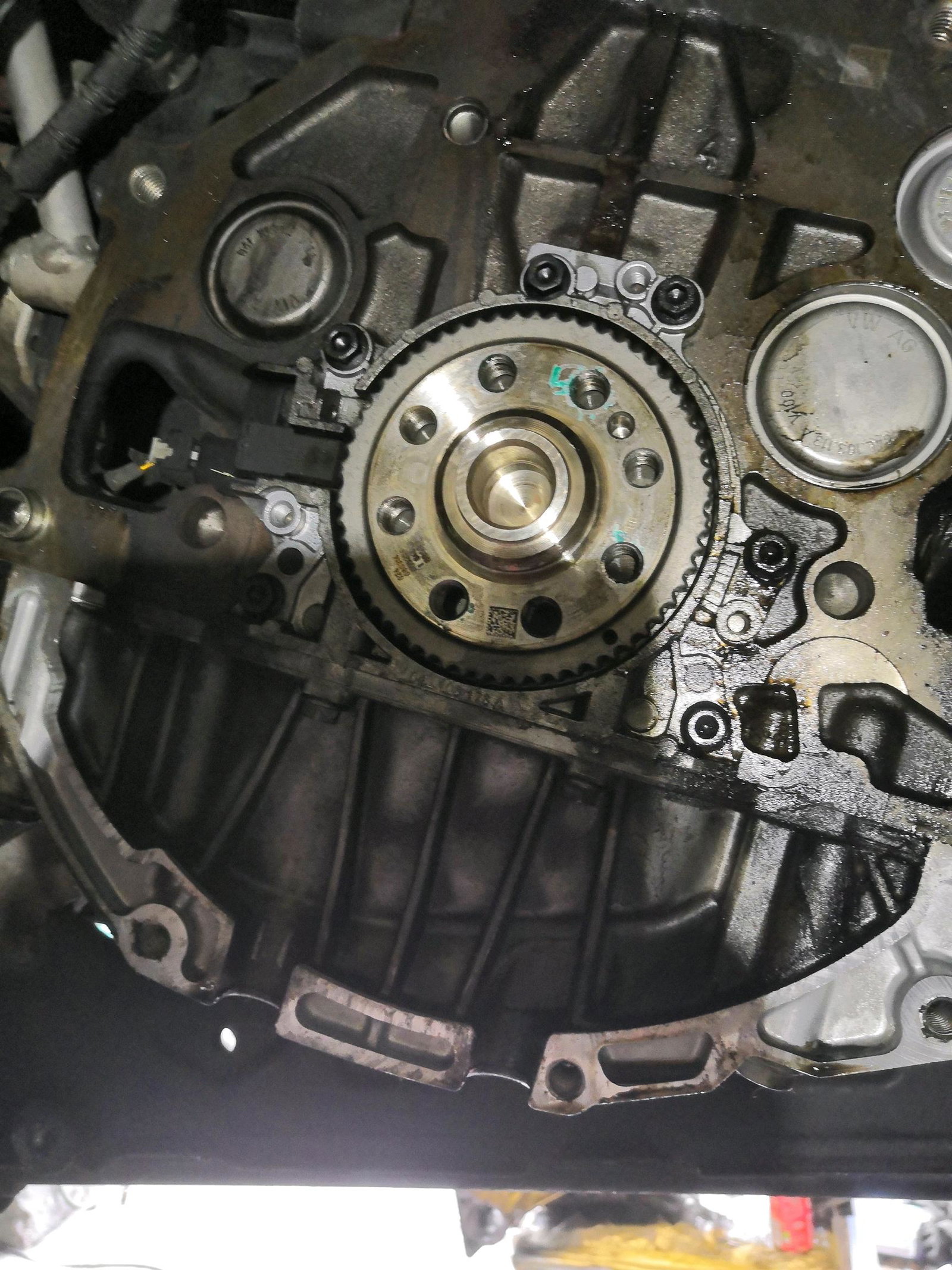

Stevey Y Posted August 2, 2022 Posted August 2, 2022 Hi gents as the milage rolls up so do the problems, they had the gearbox out today to find out what the oil leak was about and it turns out the rear crank seal is giving up the ghost spraying engine oil all over the bell housing, while we were there they also noticed that the new radial shaft seal fitted to the slave cylinder was weeping gear oil all over the clutch assembly none of which is covered by the TPS warranty because the crank seal which was dry at the time wasn't replaced with the clutch, they wanted over £155.00 for the crank seal which I got from a local motor factors [Elring O.E.] for £55.00 and because my guy cancelled the TPS order they have told him they won't sell him anymore parts which considering they have already had about £650.00 out of me for the other bits new driven/ pressure plate and slave cylinder with associated seals is a bit rich, still wait till they clock on to the fact they are not getting his £20,000 a year for all their overpriced parts will soon bring the area manager down on a flying visit, but I honestly think this time the second word will be OFF as the local main dealer has already offered some very attractive prices. Steve.

Stevey Y Posted August 4, 2022 Author Posted August 4, 2022 1 hour ago, Steve Q said: Shocking the way these parts suppliers act it really is! Hi it gets better, I have just forked out another £100 for the special tool to mount the new seal as the crank sensor ring which is the toothed bit has to sit at a precise position with the engine timing at TDC, it also has to sit at a precise level on the seal otherwise you will never get the car to start again and another bonus is if you ever want to take the crank sensor pick up out without removing the gearbox you have to remove the oil cooler assembly to get at it, I think our Teutonic friends have lost the plot with the quality issues, the latest being couple of my colleagues have bought new E220 Mercedes and were advised by the dealerships that the cam chain assemblies are suspect so anything after 40k would be a good time to get the upgraded chain kit fitted, after all the kit is only £1500+ labour and is guaranteed to do 250k, am I/we missing the point here, why not fit them to the engine when new, a couple of the boys I know in London have had the same issues with BMWs, at this rate next cab will be a Ford. Steve.

Stevey Y Posted August 8, 2022 Author Posted August 8, 2022 Hi latest update, the super seal tool has broken despite the sellers claims and now waiting for the genuine VAG tool which is twice the price, the moral of this story is DONT BUY THE CHEAP TOOL. Steve.
Stevey Y Posted August 8, 2022 Author Posted August 8, 2022 2 minutes ago, Stevey Y said: Hi latest update, the super seal tool has broken despite the sellers claims and now waiting for the genuine VAG tool which is twice the price, the moral of this story is DONT BUY THE CHEAP TOOL. Steve. Hi despite coming from Birmingham it appears the tool was made in Wayne King which is a rather large area in China. Steve.
