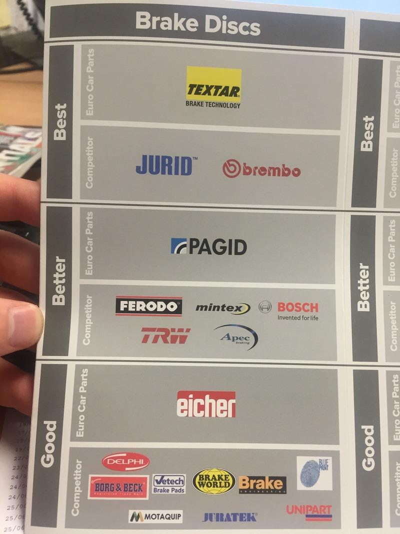

jdragon Posted August 5, 2022 Posted August 5, 2022 Found it! Post in thread 'Mintex or pagid' https://forums.mercedesclub.org.uk/index.php?threads/mintex-or-pagid.175907/post-1723091
Stevey Y Posted August 6, 2022 Posted August 6, 2022 12 hours ago, jdragon said: Found it! Post in thread 'Mintex or pagid' https://forums.mercedesclub.org.uk/index.php?threads/mintex-or-pagid.175907/post-1723091 Hi Jon any thing printed by ECP is about as believable as Boris, please note the beter and best are all with the exception of Pagid made by TMG friction who supply all OEM pads/discs to the manufacturers, TMG own the branding for all major brake manufacturers they are massive and it was their lobbying that bought about the E.U. regulations and testing for E11/E9 Google it. Steve.

Magnet Posted August 7, 2022 Posted August 7, 2022 Interesting Jon, but who funds the trial on your posted link? With appreciation of being blown out of the water, it’s always been VAG pads for me ( bought at discount) - except one deviation - when the pads were changed back to VAG. Obviously a personal view, but the efficiency of the braking systems of all other family cars are compared with the Audi, and rated to that being the top. Ferodo, Mintex, etc. (the industry standard at one time) are now bought-out brand names. No more responses from me on such topics! Kind regards, Gareth.

jdragon Posted August 7, 2022 Posted August 7, 2022 On 8/5/2022 at 4:08 PM, Khan229 said: Hi, i have been quoted for over £1000 for both front and rear discs and pads by Audi. I see on Euro car parts they are much cheaper. Need advice if I should go to Audi or get it done myself? A couple of people said go to Audi and some said do it yourself, so kinda confused. I thought the best option would be to ask for advice in here. Also, if I was to get it done myself what brand of discs and pads I should go for? Thank you I'll summarise, otherwise this thread may be more confusing: Audi prices will always be more expensive, so unless there's a warranty concern, find a recommended indi and save yourself some money. The "better and Best" from the list I posted are all made by TMG friction (apart from Pagid), so buy whichever brand suits your budget. 1
Stevey Y Posted August 7, 2022 Posted August 7, 2022 7 hours ago, Magnet said: Interesting Jon, but who funds the trial on your posted link? With appreciation of being blown out of the water, it’s always been VAG pads for me ( bought at discount) - except one deviation - when the pads were changed back to VAG. Obviously a personal view, but the efficiency of the braking systems of all other family cars are compared with the Audi, and rated to that being the top. Ferodo, Mintex, etc. (the industry standard at one time) are now bought-out brand names. No more responses from me on such topics! Kind regards, Gareth. Hi Gareth all VAG/BMW/MERCEDES/VAUXHALL/FORD/BENTLY all use pads from the TMG group, just because these companies have been bought out the only thing it realistically means is that the companies products have to conform to TMGs stringent product standards, just because its got a manufacturers logo on it and was produced by TMG in the first place why not have the same thing with DON/MINTEX/BOSCH/DELPHI for about half the price if not less, I feel sorry for people who have spent their life buying badge engineered boxes for silly money, when the facts are out there in plain sight on the internet for all with a hunger to educate themselves to do just that. Most car producers when developing vehicles go round the parts supermarkets choosing whatever meets their needs and price, price criteria, No manufacturer makes their own parts other than engines/bodywork/interiors the rest is off the shelf I.E. brakes and pads these are manufacturers such as Bosch,ATE,TRW the pads for all of the callipers are the same for each manufacturer, there is only the odd anomaly to this such as A8 rear pads which were running two different suppliers for the rears one pad being about 2mm thicker but VAG got fed up with this so you could transpose each manufacturers pads but re adapt using VCDS to allow for the difference in the pads you had just fitted, brakes are a subject close to my heart as my life and the lives of my passengers depend on them being not just right but perfect along with the tyres, as I said I have tried pretty much every brand going and settled for what works, I have said before it won't matter how good/expensive your brake hardware is its pretty much useless if the brake fluid is old. Steve
