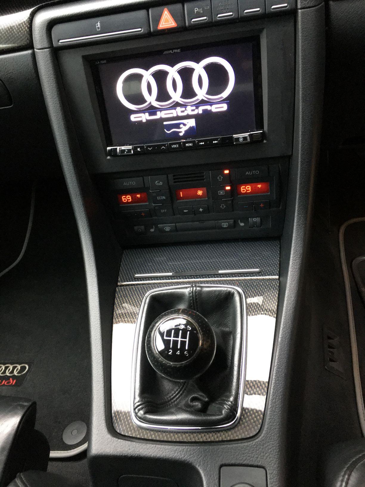

Swisstony Posted September 2, 2022 Author Posted September 2, 2022 15 minutes ago, Just Rob said: Hu units, swapping to aftermarket devices requires a fitting kit which will inc the frame and surround, also a suitable adapter loom , most double DIN聽 oem B7 hu's have the quad lock setup so the fitting loom will get your ISO sony wiring into the Audi quadlock inteface. depending on what audio spec was fitted at the factory the previous owner may not have fitted DAB ariel into the correct plug as there are two fakra plugs on some units , also the Ariel adapter needs power which many over look. That is all beyond me in terms of expertise. You on the other hand seem very knowledgable ! my guess is the previous owner removed the factory unit ( I can see the handbook for it ) and just plonked in the Sony unit to get Bluetooth connectivity and the Apple Car play functions. That unit also came with a reversing camera which funniliy enough is sitting in the boot and coiled up so never used 馃檪聽 聽 15 minutes ago, Just Rob said: 聽 those alloys may infact be spaced aswell, suspenion ride height looks a bit high but possibly still on oem kit or similar spec , maybe the tyres making it look a bit too chunky though. 聽

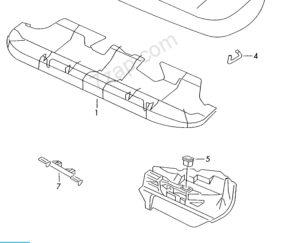

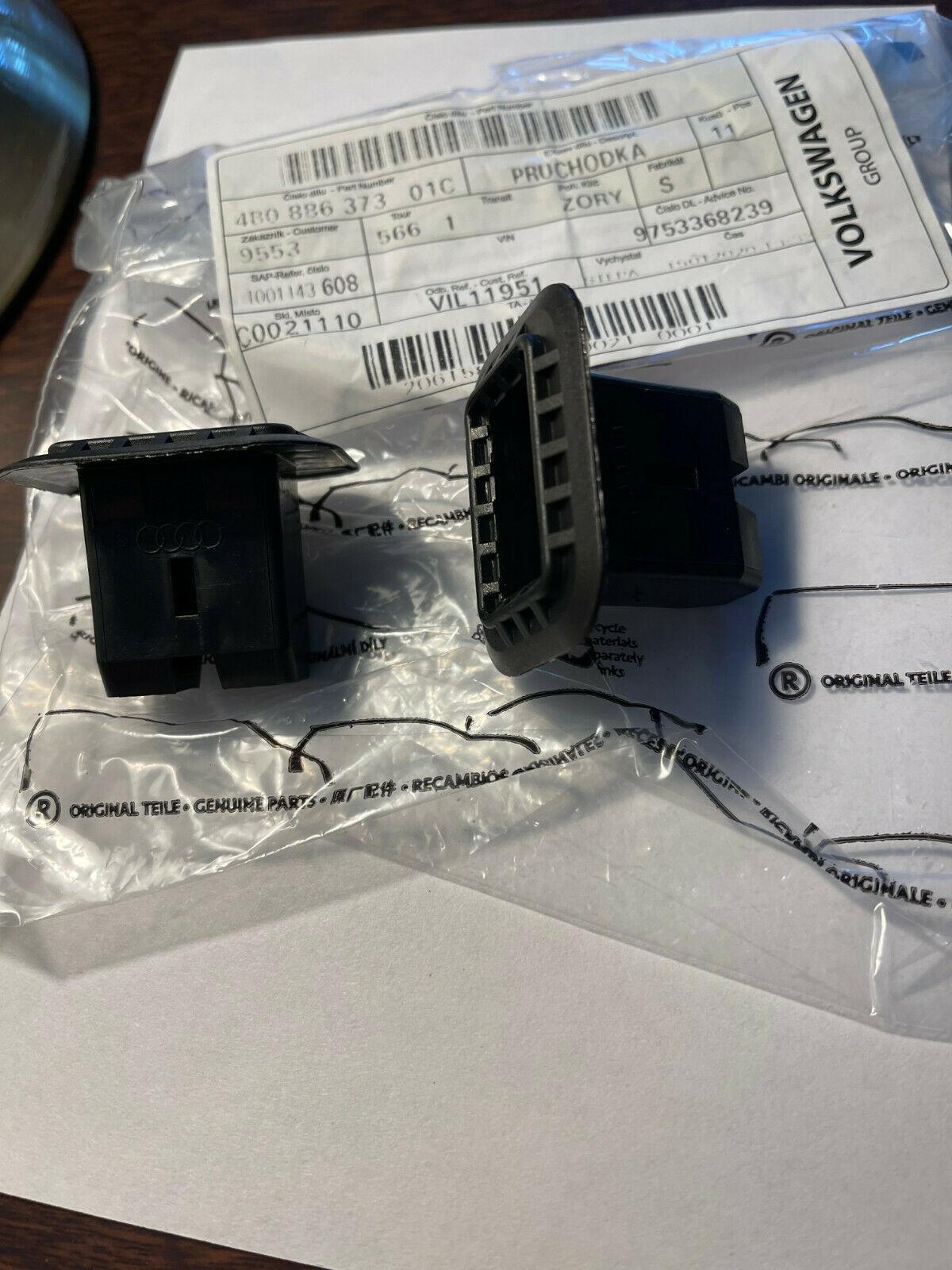

Swisstony Posted September 2, 2022 Author Posted September 2, 2022 11 hours ago, Just Rob said: I forgot to say, on the rear seat questions. The bench is only held down by two push in fixings , one on each side sort of central behind the front seat back, the plastic retainer part that fits into the floor can split and break or just fall out, the metal loop of the base of the bench just lifts up and down loosely. If yours are flopping up and down the the plastic retainer is broken/missing or possibly the bench is not quite in the correct position . the rear of the bench just pushes under the base of the backrest. 聽 just lift up the front of the bench and have a look, all will become clearer straight away. 聽 part number 5 , plastic/rubber grommit ,it fits into floor section, that is all that holds the bench in place on the front and stops it flapping around. I think I found the correct ones ?聽 聽
Just Rob Posted September 2, 2022 Posted September 2, 2022 12 minutes ago, Swisstony said: I think I found the correct ones ?聽 聽 indeed.
Swisstony Posted September 2, 2022 Author Posted September 2, 2022 thank you Rob appreciate it.聽 That reference website that has all the parts is a godsend
Just Rob Posted September 2, 2022 Posted September 2, 2022 1 hour ago, Swisstony said: That is all beyond me in terms of expertise. You on the other hand seem very knowledgable ! my guess is the previous owner removed the factory unit ( I can see the handbook for it ) and just plonked in the Sony unit to get Bluetooth connectivity and the Apple Car play functions. That unit also came with a reversing camera which funniliy enough is sitting in the boot and coiled up so never used 馃檪聽 聽 聽 As much as everyone loves the oem units and they look well, oem , they are outdated now in terms of tech and connectivity. Good aftermarket devices are soo much better and if installed and setup are by far the way ahead in an older car. I'm not IC expert in fact i hate messing around with it but they are not that complicated with only a few wires to connect to be honest, most instructions are very clear and few owners that do it DIY have issues, that said B7's do have some specific wiring , but its pretty straight forward.

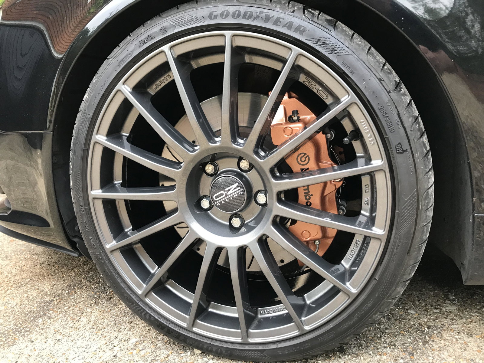

Just Rob Posted September 2, 2022 Posted September 2, 2022 1 hour ago, Swisstony said: I think these are RS wheels which with the wide body on that model may suit it but on mine it looks all wrong and the offset is terrible. In the week of owning it I have seen the rubbing on ther arches and picked all the melted rubber off ! I have found some lovely Le Mans genuine Audi 18. 8J X 18 ET 43 18/235/35 in anthracite which should be perfect without any spacers. 聽 ideally you want 235/40 18 tyres but 35 is not too much lower, you may find the wheel arch gap looks much bigger thou. 聽
Swisstony Posted September 2, 2022 Author Posted September 2, 2022 4 minutes ago, Just Rob said: ideally you want 235/40 18 tyres but 35 is not too much lower, you may find the wheel arch gap looks much bigger thou. 聽 My bad they are 40 and not 35 so happy days聽
Just Rob Posted September 2, 2022 Posted September 2, 2022 I have an alpine in my old bus, been fitted for a few years and I really cannot fault it. 聽 聽
Just Rob Posted September 2, 2022 Posted September 2, 2022 I don't get as much steering wheel control with my FBSW but not really fussed as pretty well everything is voice controlled. 聽
Swisstony Posted September 2, 2022 Author Posted September 2, 2022 9 minutes ago, Just Rob said: I don't get as much steering wheel control with my FBSW but not really fussed as pretty well everything is voice controlled. 聽 Now there is a man who is a fan of Carbon fibre 馃檪 Little update on my ICE. Just popped up to a company local to me and discovered the reason behind the tuner and DAB issue. Turns out the tuner has a poor reception because the window tint on the rear screen is blocking the aeriel ...doh! So as the alternative is a shark fin on the roof I will just live with the poor reception The DAB now works as it needed was a factory reset and all good.聽 At the same time we discovered that the reversing camera works but needs installing so booked in for that install. A nice bonus as it was just sitting in the boot coiled up.聽 1
Swisstony Posted September 2, 2022 Author Posted September 2, 2022 20 hours ago, Just Rob said: I would also imagine that the previous owner that spent on those parts, and that ECS induction kit is not cheap by itself , may well have uprated the suspension too, if he didnt then he had his priorities聽 around the wrong way. check under the arches to see what fitted. may have even fitted an uprated Rear ARB if you are really lucky, rs4 ARB is a good option. 聽 Sadly after initial investigation, it looks like the previous owner didnt do anything with the suspension which is a shame . Looks entirely standard to me.聽 So as the wheels were off I couldnt resist cleaning 馃檪聽no before shots at this time聽 聽 聽
Just Rob Posted September 2, 2022 Posted September 2, 2022 5 hours ago, Swisstony said: Now there is a man who is a fan of Carbon fibre 馃檪 Little update on my ICE. Just popped up to a company local to me and discovered the reason behind the tuner and DAB issue. Turns out the tuner has a poor reception because the window tint on the rear screen is blocking the aeriel ...doh! So as the alternative is a shark fin on the roof I will just live with the poor reception The DAB now works as it needed was a factory reset and all good.聽 At the same time we discovered that the reversing camera works but needs installing so booked in for that install. A nice bonus as it was just sitting in the boot coiled up.聽 I've heard quite a few reports form owners that they were getting poor reception due to the rear window tint, never had an issue myself as I fitted a slimline one on the top edge of the windscreen, works a treat. good news that its all working now along with camera, the fun starts now getting the camera into the boot lid through the cable trunking...

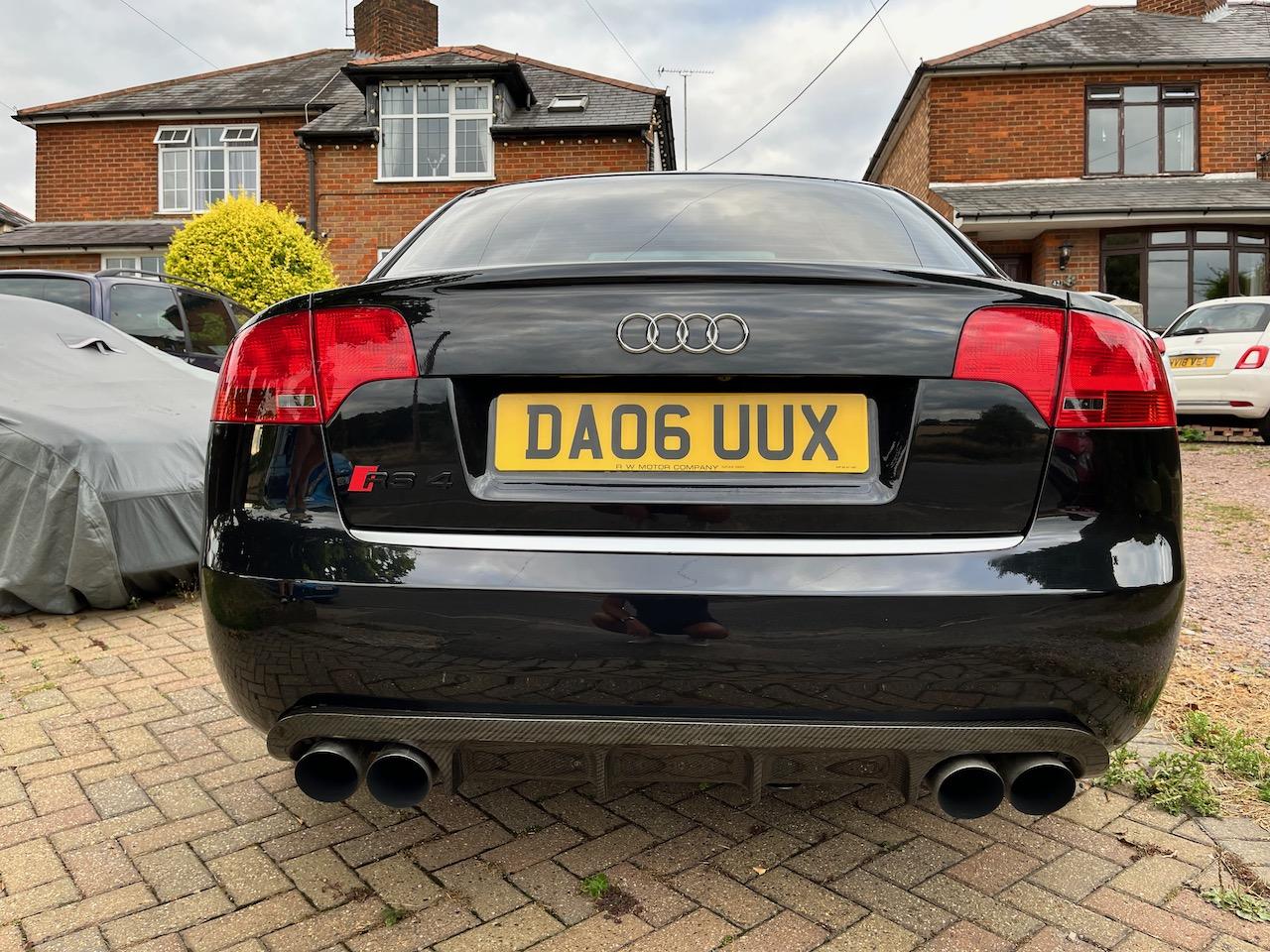

Just Rob Posted September 2, 2022 Posted September 2, 2022 I've not seen many non S4's with quad tips , i converted mine to quads just because they filled out the rear end nicely. 1
Swisstony Posted September 2, 2022 Author Posted September 2, 2022 1 minute ago, Just Rob said: I've not seen many non S4's with quad tips , i converted mine to quads just because they filled out the rear end nicely. That looks lovely mate , very tidy聽 聽
Just Rob Posted September 2, 2022 Posted September 2, 2022 1 hour ago, Swisstony said: and after聽 聽 聽 those discs look like mtec items, worth measuring diameter aswell as they look more like S4 345mm discs and S4 carriers聽 than the oem320mm items, maybe just an illusion though.

Just Rob Posted September 2, 2022 Posted September 2, 2022 1 hour ago, Swisstony said: Sadly after initial investigation, it looks like the previous owner didnt do anything with the suspension which is a shame . Looks entirely standard to me.聽 So as the wheels were off I couldnt resist cleaning 馃檪聽no before shots at this time聽 聽 聽 S-line setup on these cars is pretty rubbish frankly, rear springs are always snapping, dampers leak and its just a poor ride. Aftermarket options make such a big difference to ride and handling and ride height which is always been a bit odd on these variants.
Just Rob Posted September 2, 2022 Posted September 2, 2022 10 hours ago, Swisstony said: I think these are RS wheels which with the wide body on that model may suit it but on mine it looks all wrong and the offset is terrible. In the week of owning it I have seen the rubbing on ther arches and picked all the melted rubber off ! I have found some lovely Le Mans genuine Audi 18. 8J X 18 ET 43 18/235/35 in anthracite which should be perfect without any spacers. 聽 The Lemans style alloys were a factory fitment on the mk2 special edition as part of the black optics finish. my old bus is a mk1 so had the ronal spoke rims as would have yours.
