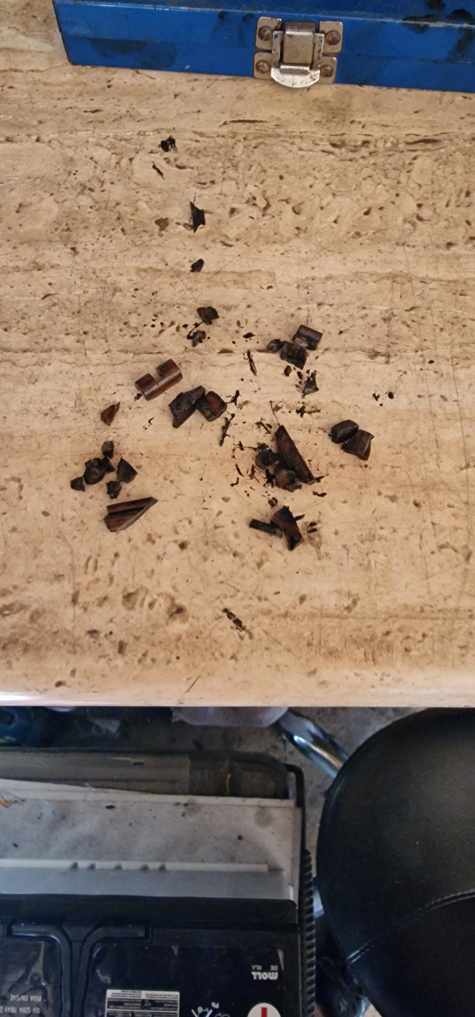

Chris Lundie Posted September 16, 2022 Share Posted September 16, 2022 Hi folks,聽 I am new to this forum, I have recently had a catastrophic engine failure on my 2010 audi a6 2.7tdi quattro. I suspect the chain guides have given up as I have loads of plastic in my sump and the engine has no oil pressure now. My question is, I have a engine code CANC but can I swap the bare block out with a CAMA? I would obviously use all the sensors and almost everything externally off my existing lump. Is this doable or do I need to get the same engine coded bare block?? Any advise would be very much appreciated as I really like the car and would like to get it back on the road 馃憤 Kindest regards聽 Chris Quote Link to comment Share on other sites More sharing options...

Chris Lundie Posted September 18, 2022 Author Share Posted September 18, 2022 Hi Steve thanks for your reply 馃憤 I haven't taken the engine out yet, it still runs but there is zero oil getting pumped around the engine now and it sounds so bad馃槩 I have replaced the oil pump and when I pop the sump off there was a lot plastic from the chain guides. I thought I might just be easier to get another 2.7tdi of around the same year and change the bare block and use all my ancillaries.聽 After looking around for a new donar engine there are a few different engine codes to chose from. Physically the engines look the same with the same HP ratings but I'm not sure if I can buy 1 and swap my external engine parts over to it and install it into my car? My engine code is CANC and it appears they are quote rare and very expensive. I will keep looking for a like for like replacement but if I can get confirmation another 2.7tdi like a engine code CAMA would work I would just buy a block and install it.聽 If I get confirmation that only a engine code CANC will work in my car and nothing else then I will get the lump out the car and open it up to see where it has failed. With the amount of broken chain guides and swarf in the sump I would think this lump is finished.聽 Chris 聽 1 Quote Link to comment Share on other sites More sharing options...
